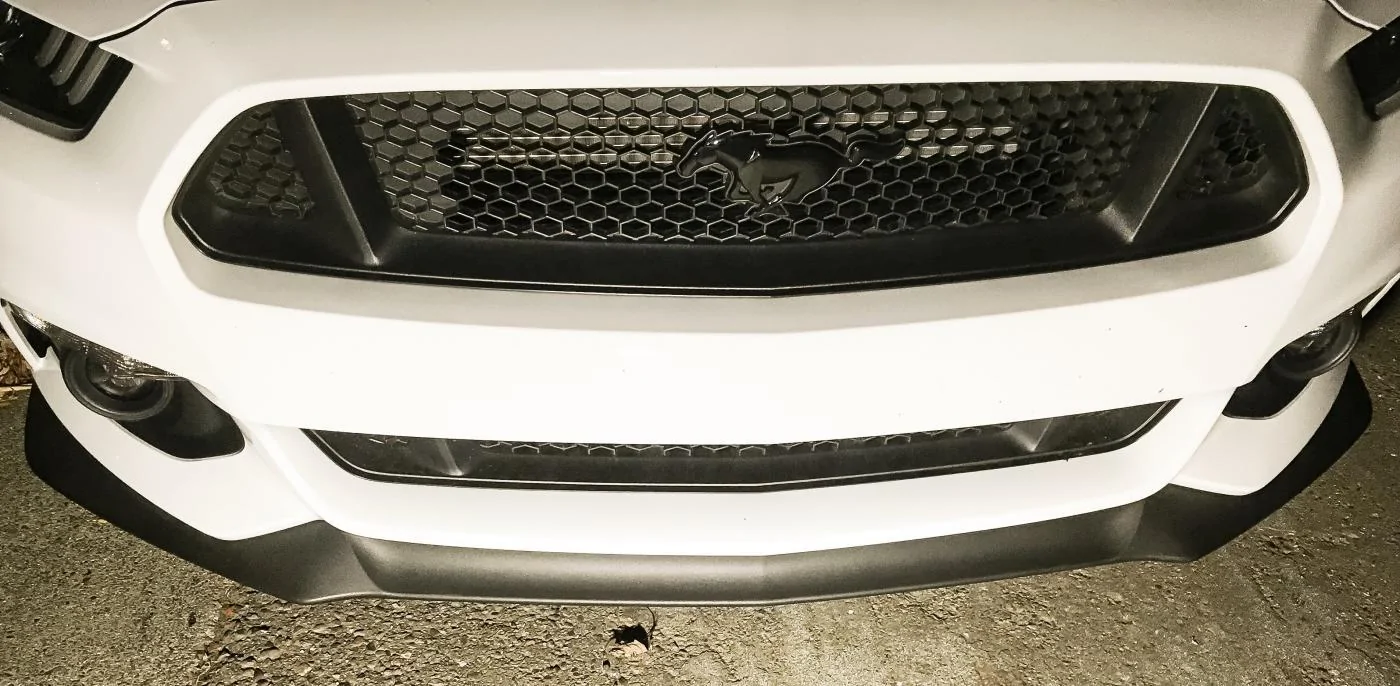

Today I installed the PP splitter and belly pan.

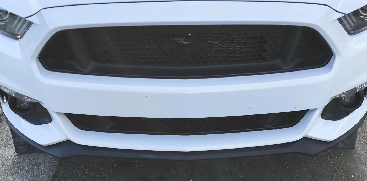

Before

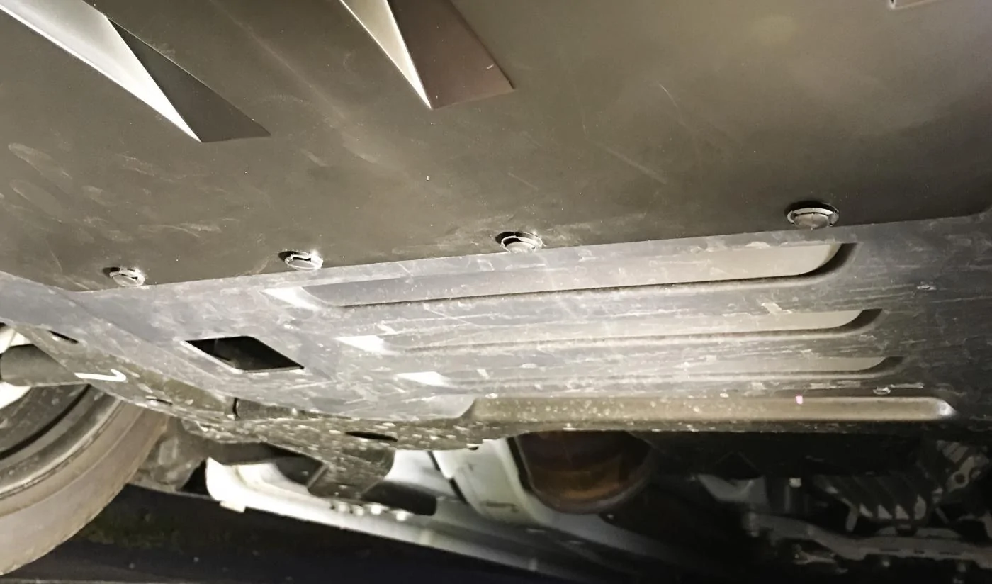

So for anyone planning to put a PP splitter on their car, there are some things to consider. 1. The swap requires the PP belly pan, and additional hardware at the very minimum. 2. There is a PP cover under the engine, which I skipped at this point. I just drilled (4) 1/4" holes in the GT cover for now and installed plastic push pins(later if I add PP bracing I may change that). 3. The front wheel fender liners need cut where the belly pan channels air to the brakes. Scissors work great for this or you can buy PP liners.

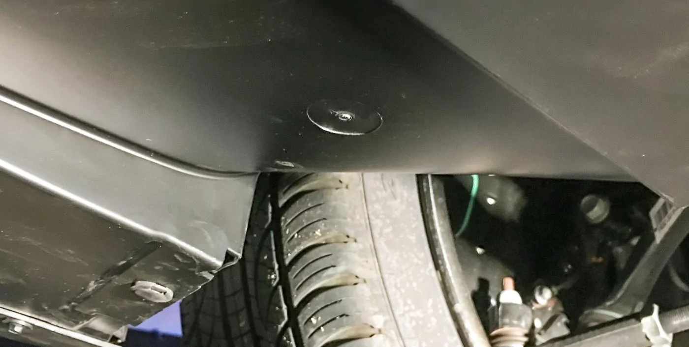

1967 C10 2021 GT PP M6

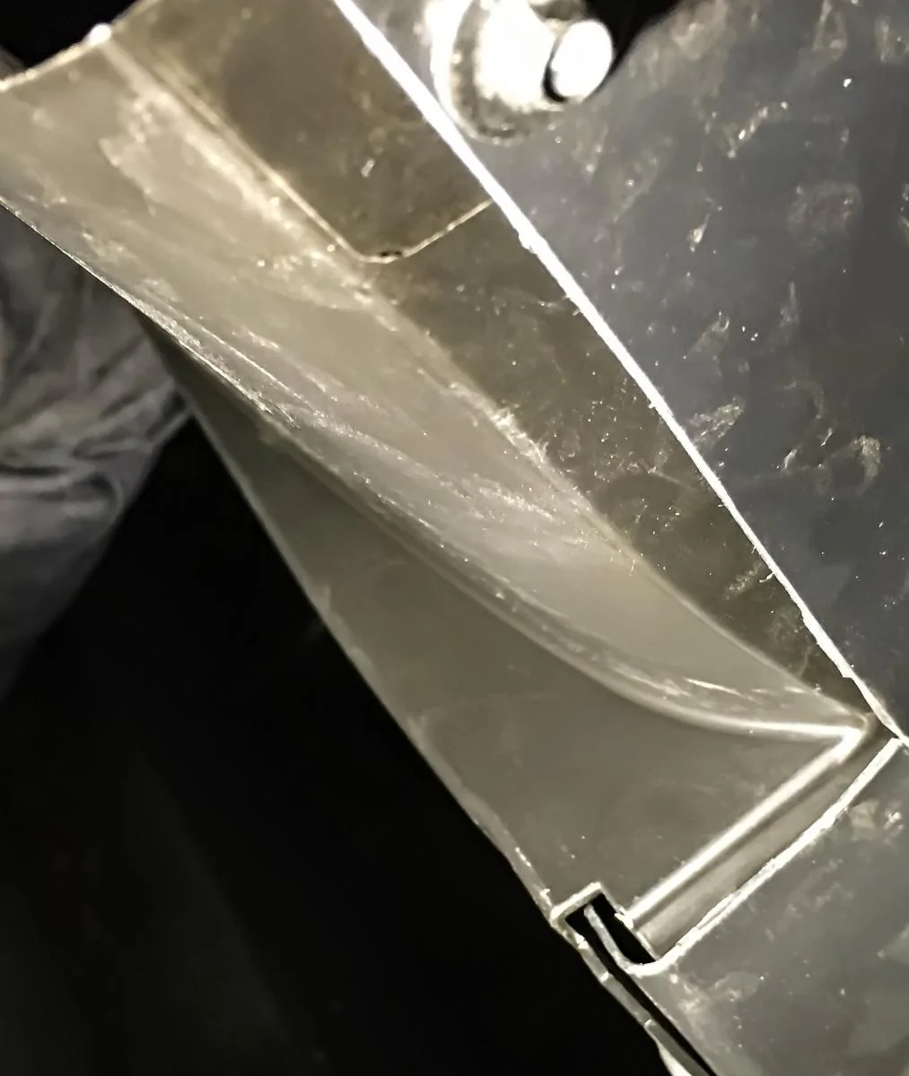

Air channel to brakes.
350Mike
350Mike
Jun 27, 2015
642
164
NorCal

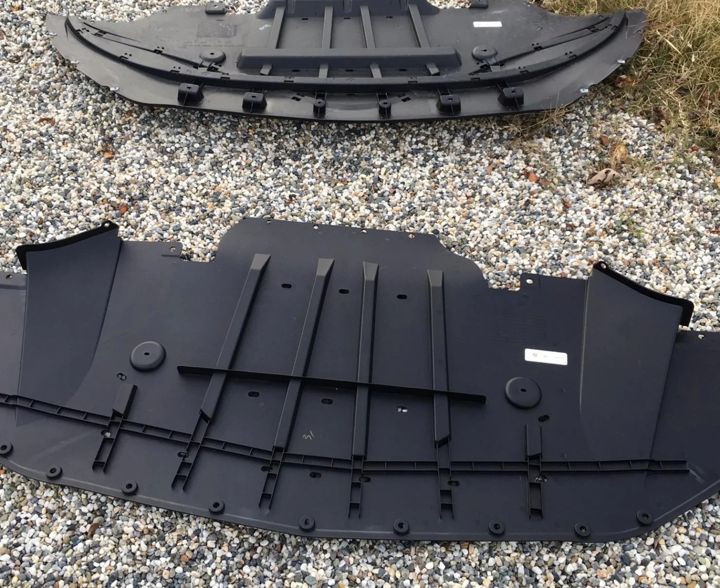

Belly pan
