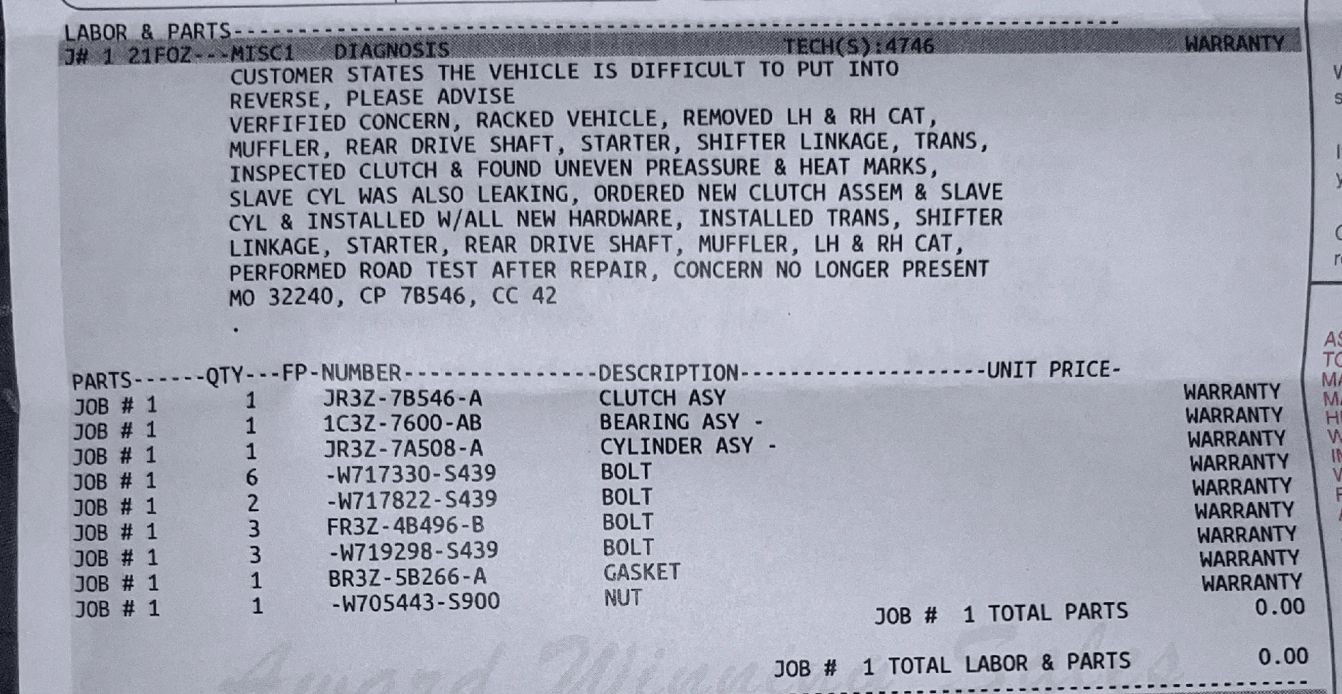

I feel something involving the slave cylinder is not quite right. It's either physically binding, there's air in the line or something else is preventing it from smoothly operating.
Edit:
Why was the original assembly replaced? General wear and tear or something else?
Are there any noises you're hearing you wouldn't expect as the clutch engages or dis-engages?
The clutch is not slipping or acting up at any other RPM bands, yes?
Agree with others: I would fix this problem with OEM assembly before adding items or making mods.
Warranty on parts and work done?
Dealer installed a new clutch but didn’t seat it properly so I went back and got a brand new one installed.
I don’t hear any noises. When I go to shift at high RPMs, I can feel as if it’s still spinning, through the clutch pedal.
The clutch works perfectly fine in all other RPM. It’s mainly 5k+ rpm
