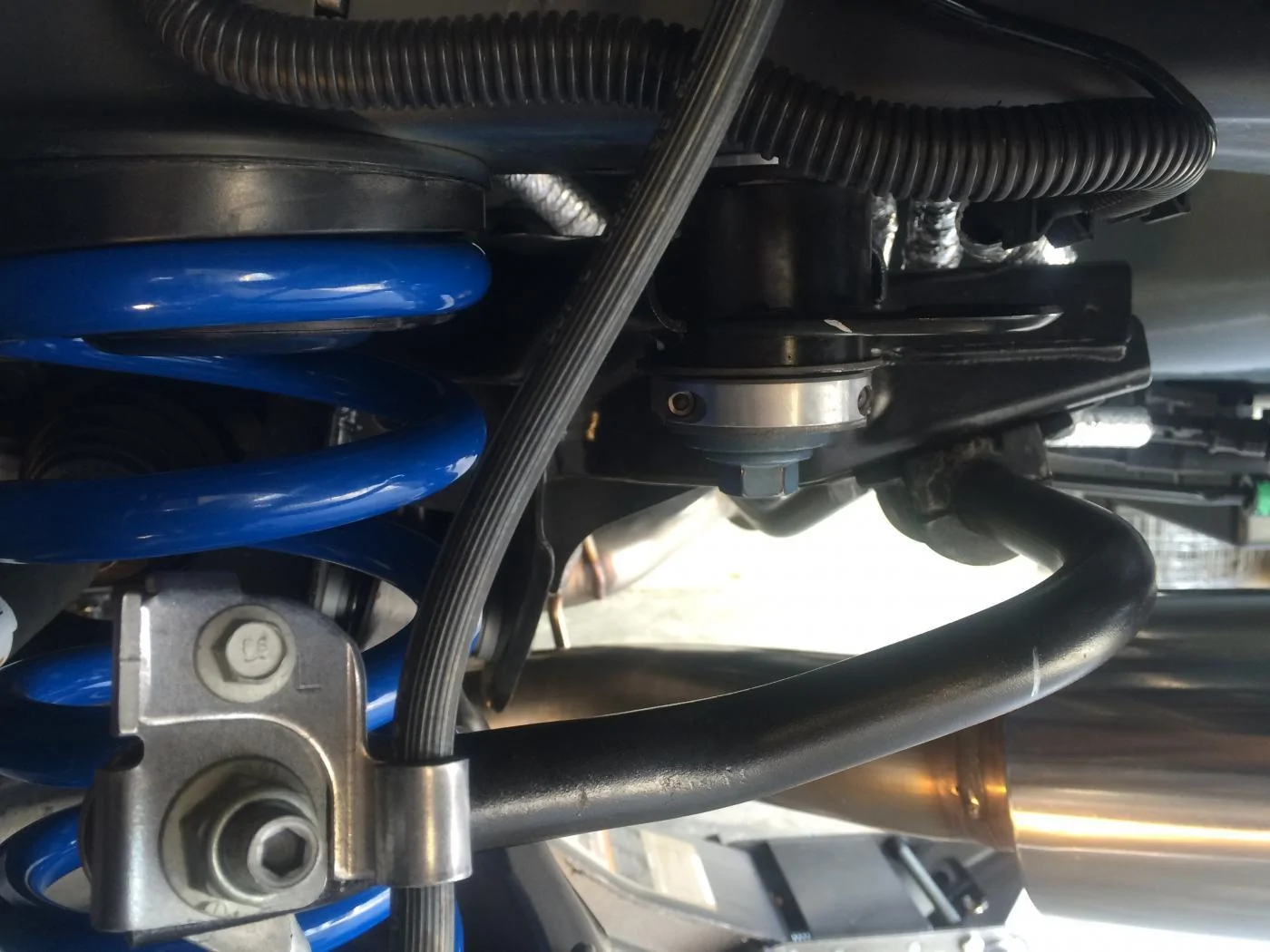

Got the rear of the car done this weekend. Steeda sport linear springs, IRS bushing supports, and subframe alignment sleeves. Took me about an hour and a half to get 90% of the actual work done, and about 6 more hours wrestling the subframe around to get all 4 sleeves in without cross threading the captive threads in the body. Took the car out and did some pretty aggressive driving afterward. Wheel hop is reduced by about 60%, ride is much firmer, and the car sits about 3/4" lower in the rear. Hoping it will settle just a bit more. Will work on the front end an hour or so at a time over the next couple days.

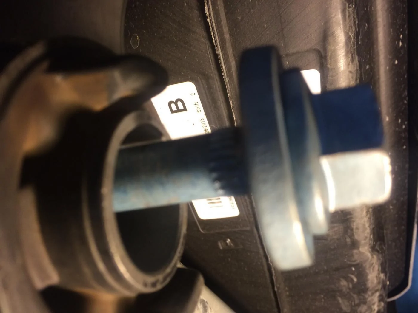

Also, I thought this picture nicely illustrates how much slop there is in the subframe without the alignment sleeves. For those who haven't had this area apart, the bolt pictures here is one of the 4 main subframe bolts, and you can see how much slop there is when bolting the subframe in. The sleeves take up all the space pictured here so there is no unintentional adjustment of the subframe. The sleeves will not allow the subframe to be out of square, where the factory setup does.
