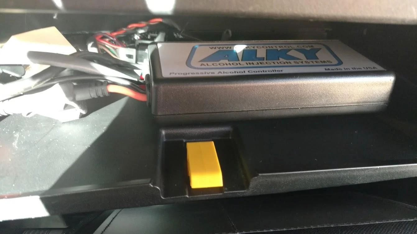

Very happy with my Alky Control kit. It cut IATs in half and I gained 3psi/3-6* timing with it on top of 93. I spam that all over the forum so you've probably seen it already lol
Alky is more expensive but for good reason. It uses braided stainless lines not push in nylon lines, the controller is beefier and actually allows MORE adjustment than the Snow. Customer service is better as well.
Snow system has "start psi" and "max psi" to determine when to start injecting and when the pump should be maxed. But you cant change the slope. With the Alky kit you determine the start psi, but by using initial and gain, you can customize how much is injected at the turn on point and exactly how much it ramps up with psi. it isn't a huge difference, but it allows for more fine tuning. The downside is the Alky settings dont specifically reference to a certain psi. You have to look at your boost gauge to determine that yourself.

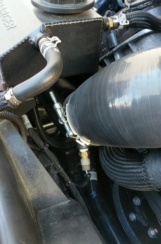

Only part of the Alky system I strayed away from is the nozzle. It's a 2 piece design where one half secures inside the pipe and one outside. You can use loctite and crank down on it but there is still the off chance of it coming part and your motor eating the nozzle. All other nozzles secure completely on the outside which I much prefer. I've used the Snow nozzles and DevilsOwn nozzles, the DevilsOwn are the best IMO.
Mount the nozzle as far away from the TB as possible for the best atomization and best distribution amongst the cylinders (as well as the best IAT drop). You'll have to move your IAT sensor post-meth to see/benefit from the lower IATs.

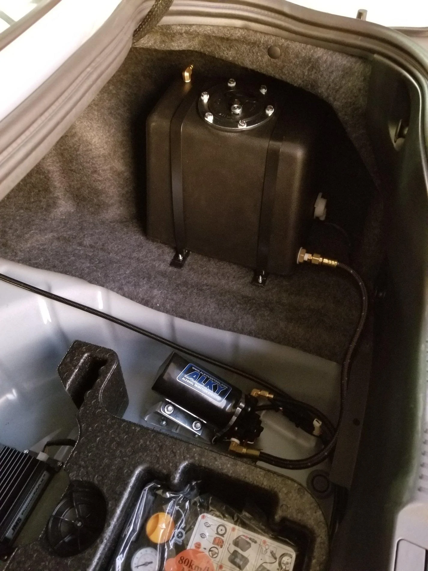

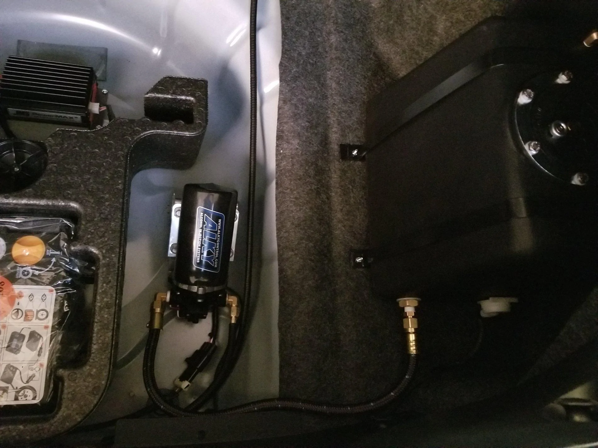

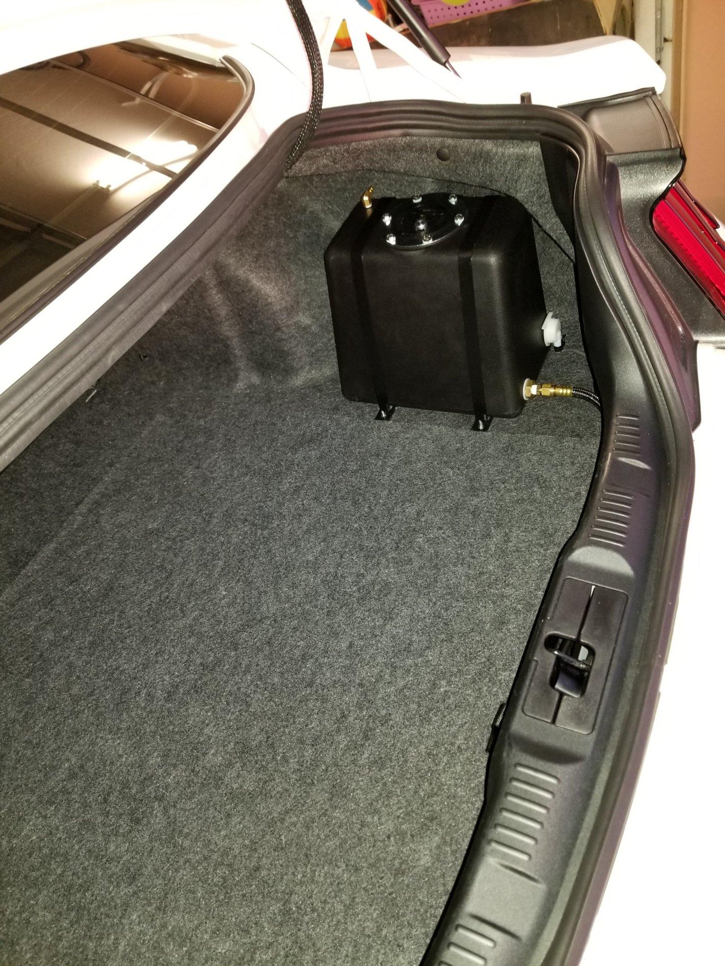

Another vote for Alky Control. I'm running a 2-1/2 gallon tank in the trunk and am currently using a 10mil/min & 7mil/min dual nozzle setup. Still messing with the tune but seems to work well on my 2018 P1X Procharger setup.
