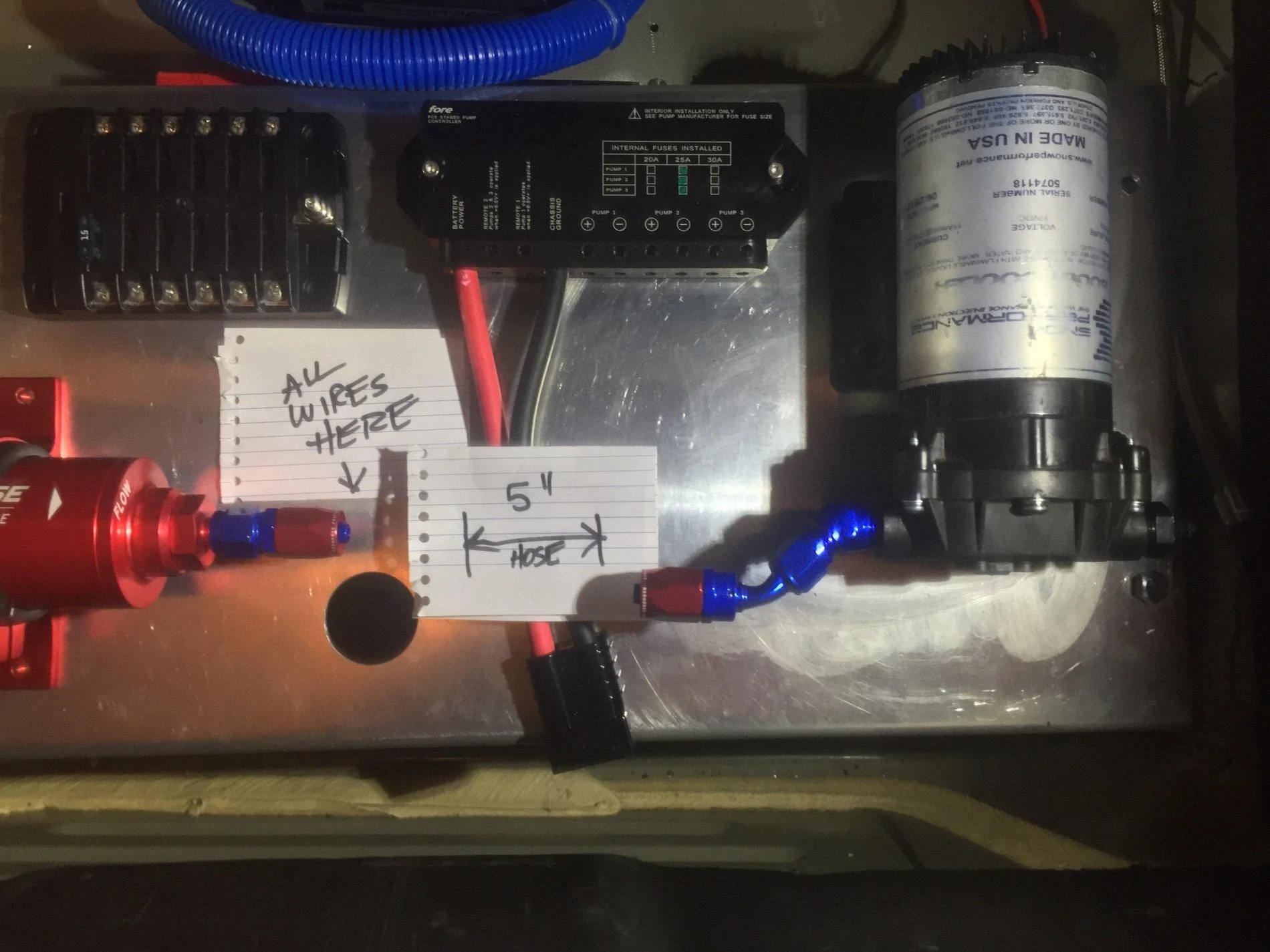

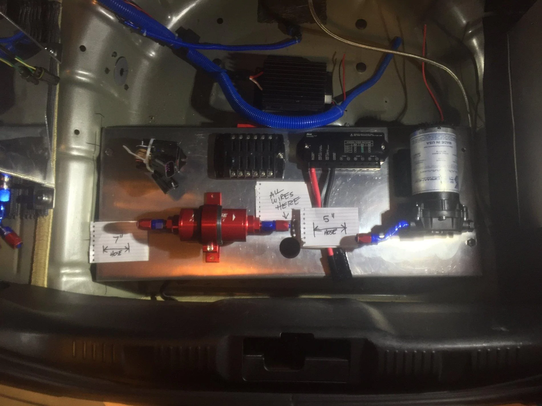

I'm using a Snow Stage 2 kit with their big pump, Redhorse Performance filter, braided SS lines and AN fittings. I also have a polished aluminum 2.5gl tank with all this hardware mounted on a fabricated plate in the trunk of my S550. I use a dual jet (#6) plate and have the controller set so the w-m is injected in three stages, tied to measured boost. I also have a dual IAT sensor setup so my tuner can see the IAT from the MAF and the intake manifold plenum. I also have the FORE triple pump return line fuel system and run E85. Works great.
