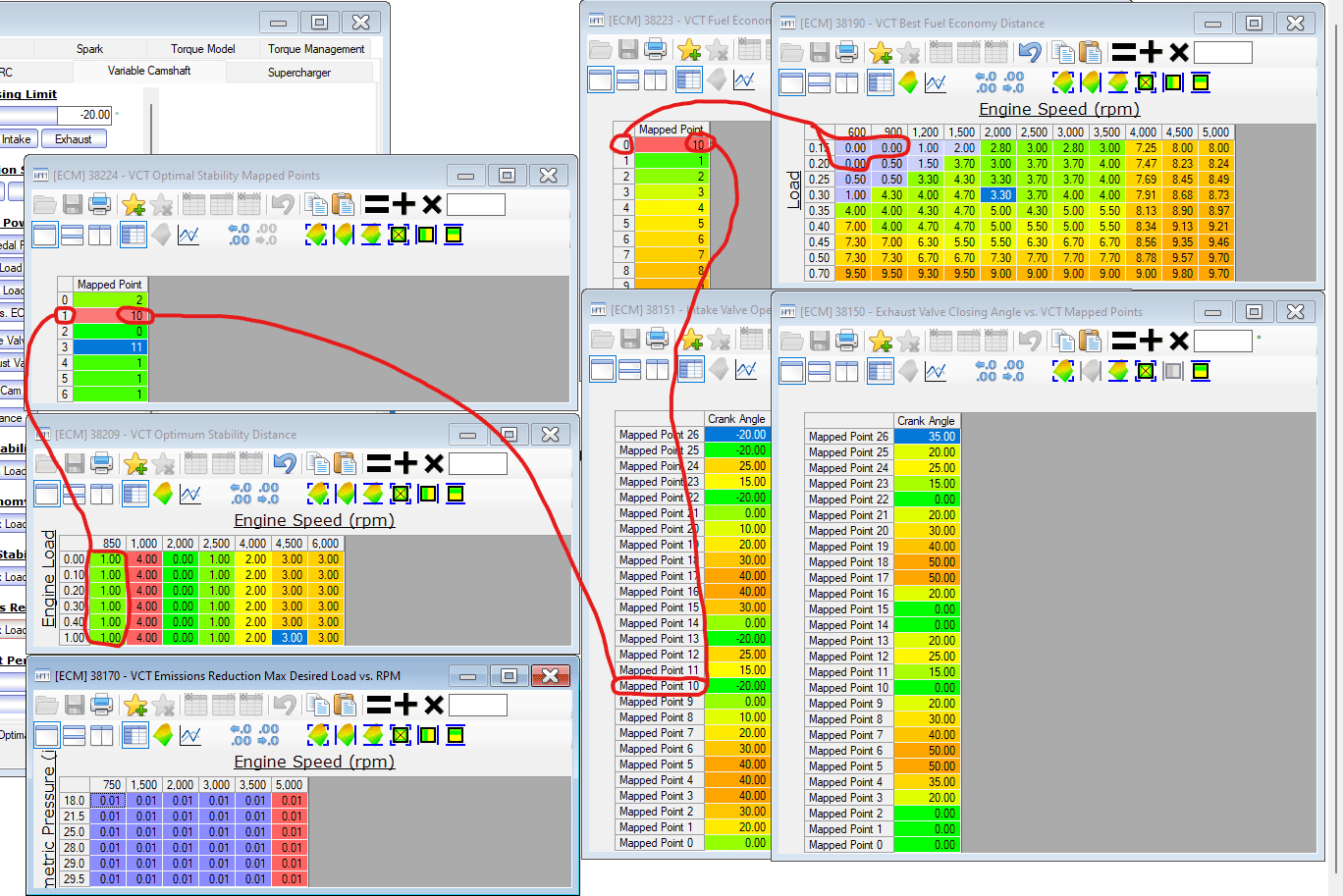

I havent really messed with the ghost cam stuff too much but pretty sure theyre talking about this. This also shows how the distance tables work
From my understanding the car will look at the mapped point snap lines too.
Is the car actually looking at the 2 profiles (stability and efficiency) at the same time? I thought it was only looking at one at a time.
