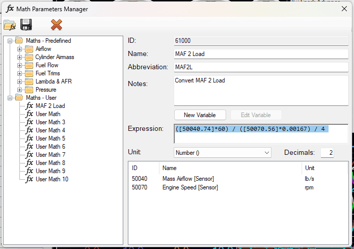

How are you guys doing the MAF 2 LOAD calculations? I'm not getting it to work.
Ill try those.
Here is the MAF 2 Load calculation based off what engineermike said on hptuner forums. The thing is picky about number multiplaction so you have to use parenthesis.
MAF 2 Load: ([50040.74]*60) / ([50070.56]*0.00167) / 4
