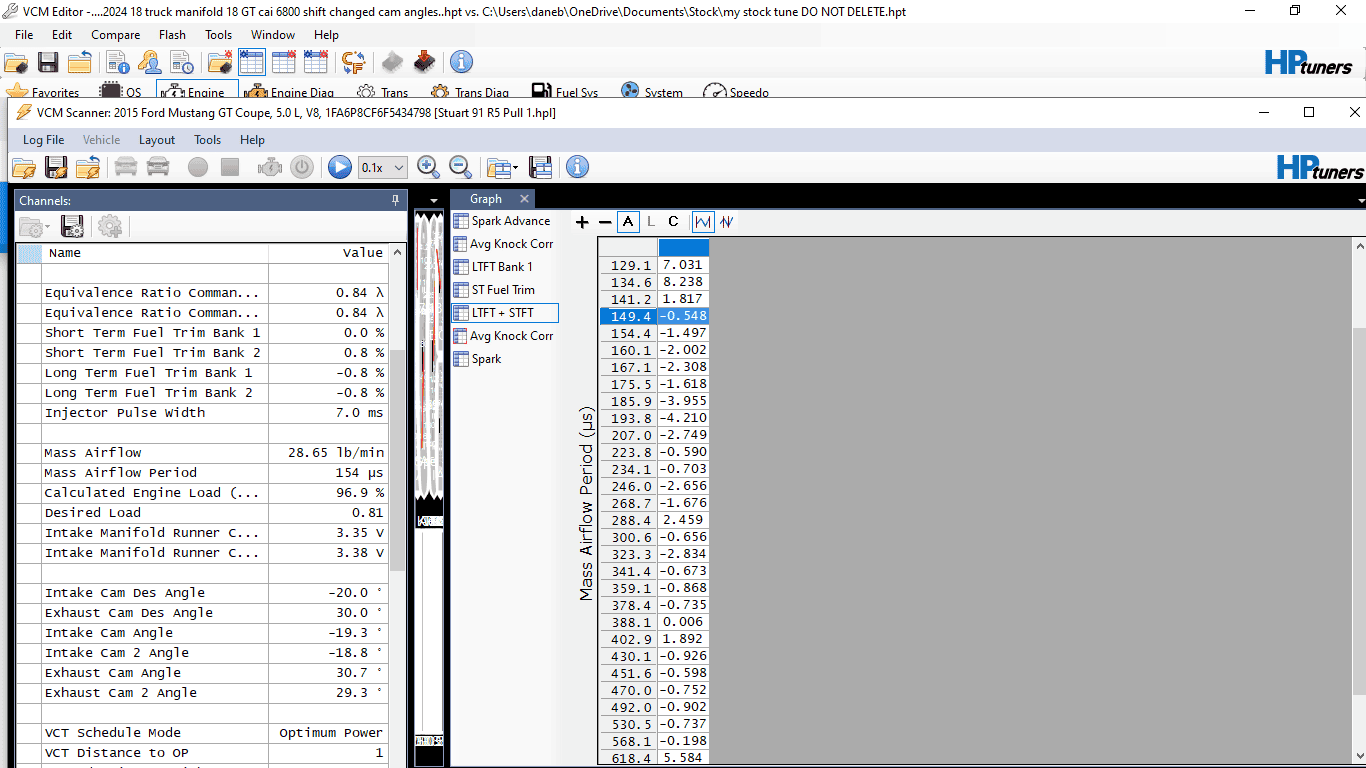

Can you look at this one and tell me if you think its any better? I found a lot of roush files had different breakpoint and high/low slope multipliers so I changed them. I think I also disabled the cat protection.
I changed what data its getting so hopefully it polls better.

Looks like it might still be going in to COT, but you need to log fuel source to be sure.

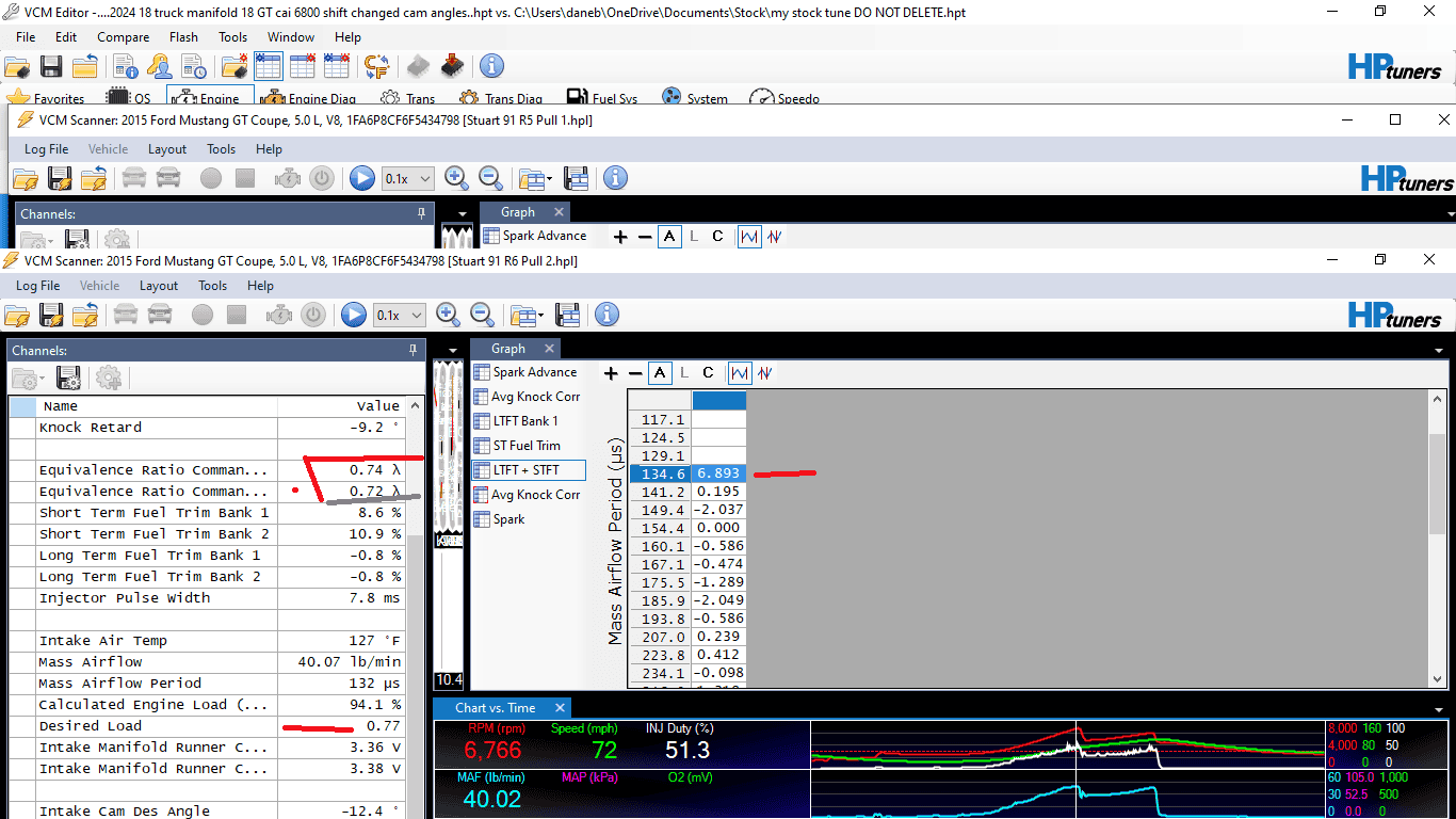

Still going into cat protection
Load looks low, maybe bring the intake cam in faster
6% fuel on top but you really need to log more RPM to see what is going on.

I'd log actual load or just load.

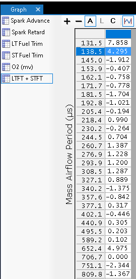

Looks like my changes didn't do much. Do you think its good enough to start tweaking the maf to get closer to 0 at higher rpm and fix the one weird spot around 650?

@K4fxd i believe his high rpm load is showing false low due to the fuel trims being high.
My load is also low due to whatever is wrong with the engine. Its one of the few concrete things Lund could point out that changed between old motor and new. It went from over 1.0 to around 0.87-0.92 if I remember correctly.

Ill make a new tune that revs to like 7,500 and with better cam values and add in the things to log you guys suggested.

Keep your cam at -20 to 6000 then run it to 0 at 8000. That mimics a big name tuner's curve. EX at 30 starting at 5000 this would be OP cam timing.
do about 4 logs and average the points to get a better reading. It will have spikes that come and go
