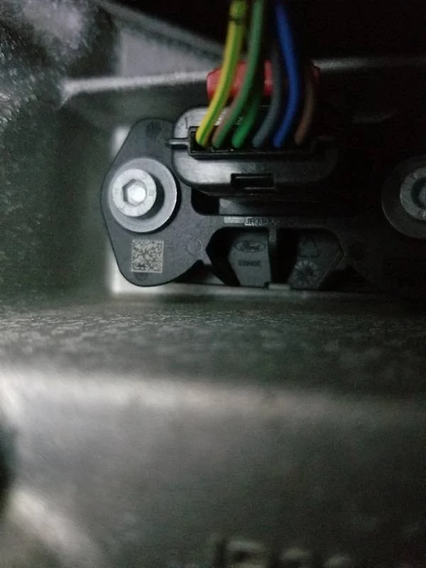

Look for this on the left side of the transmission, *way* up high. The '19 service manual wiring shows it, interesting if the '18s also have it.
That is 19+. 18's don't have it. (used for rev matching primarily)
