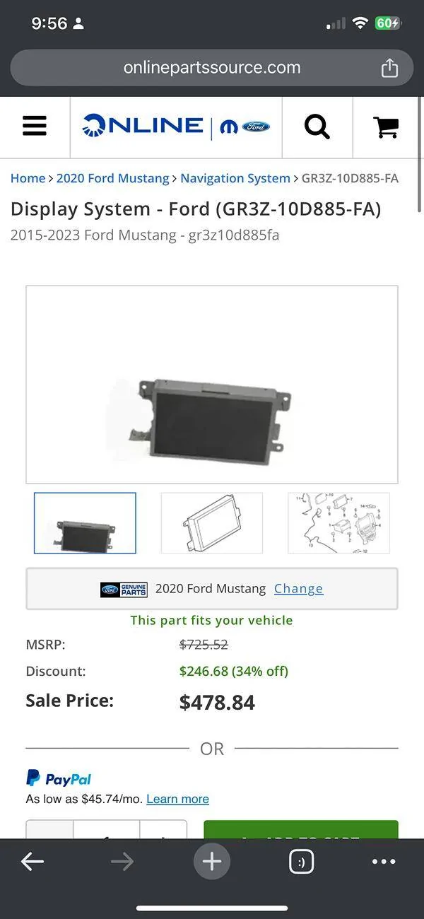

Does anyone knows if you can replace yourself the display screen without having to take the car to the dealer to resetting/setting/syncing anything related with car mileage?
I asked for a quote to this part and the parts agent replied back this:
“I spoke to my manager and I was told after asking that we are not able to sell these because of having to special order and that there are certain things that would need to be done so please ignore the quote I sent over. And my boss said this is something you would have to order locally at your dealership like a cluster because of mileage having to be programmed in by Ford which they would need an open Repair order for.”
I’m able to buy this part here: https://www.onlinepartssource.com/oem-parts/ford-display-system-gr3z10d885fa
Anyone?
