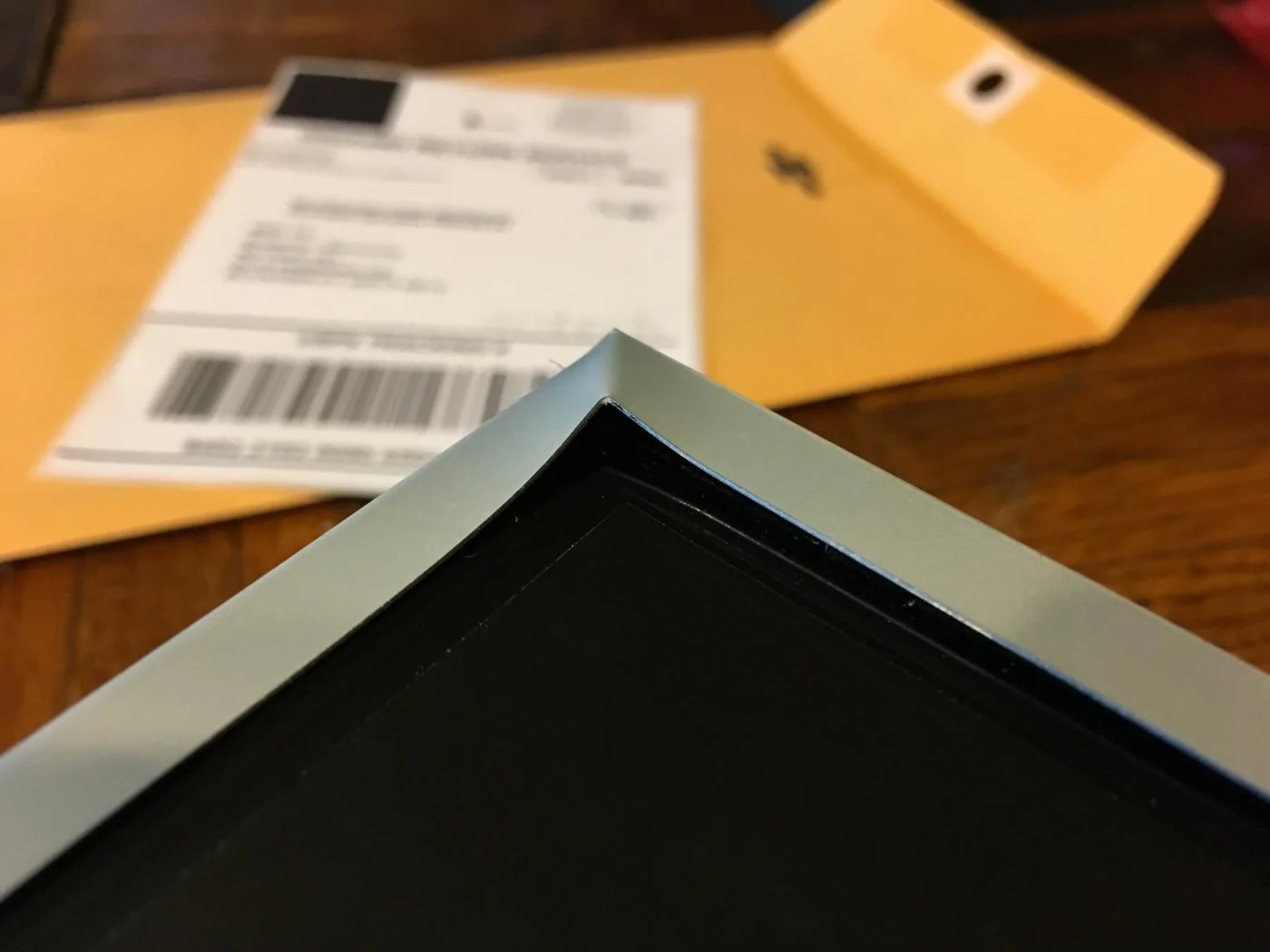

Well, bad news for me. The shipment arrived and was well packed with flexible egg crate gray foam. But upon removal I found the metal frame holding the screen was bent on one corner and in the middle of the bottom. The bends were protruding outward. There was no damage to the shipping box, however. Very strange. It may be Ok and I could probably take the frame and straighten it out, but why should I, esp at these prices? There could be some cracking inside. It looks like the unit was under stress somehow.
I called 4Dtech immediately and emailed them photos. They apologized for the inconvenience and sent out a replacement screen within minutes of my call. All good, except when I checked the tracking number it said delivery in one week! Usually when this has happened before the company overnights a replacement, so that is a disappointment. :rant:
But I will withhold my final eval until the new one gets here and I install it. Everything else in the package seems fine. There are detailed install instructions with pics. Plus, of course, they did a complete video showing install in a mustang exactly like mine.

My screen (ordered from Ebay, not through 4Dtech) had a bent mounting bracket. It was well protected and the box showed no signs of damage. The aluminum is fairly pliable, you could try to bend/tap that down and see what happens. Nothings stopping you from taking your old system out and trying it out (aside from time). I can understand not wanting to proceed and having to take the screen out again a week from now.

I am considering that. The pic is only one place it is bent.. it was worse in the center, which I pushed in. It didn't smooth out well. Also bent on the side.. Not sure it will fit evenly behind the bezel because the metal is stretched. But I might hook it up just to see if it works otherwise, and leave the dash open. I can drive my Jeep for a week.
