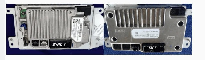

MFT TO SYNC3 the cables are already there..... 4.3" to sync3 you need new cablesI guess it'd be the adapter for the new hub that you'd have to make? That's the part I'm confused about. You have to make that or you can get this part from ford (WPT1239)?
Also, do you really need the FR3Z-14D202-A and FR3Z-14D202-B cables for mft -> sync3? In the 4Dtech install video they didn't switch out any cables
