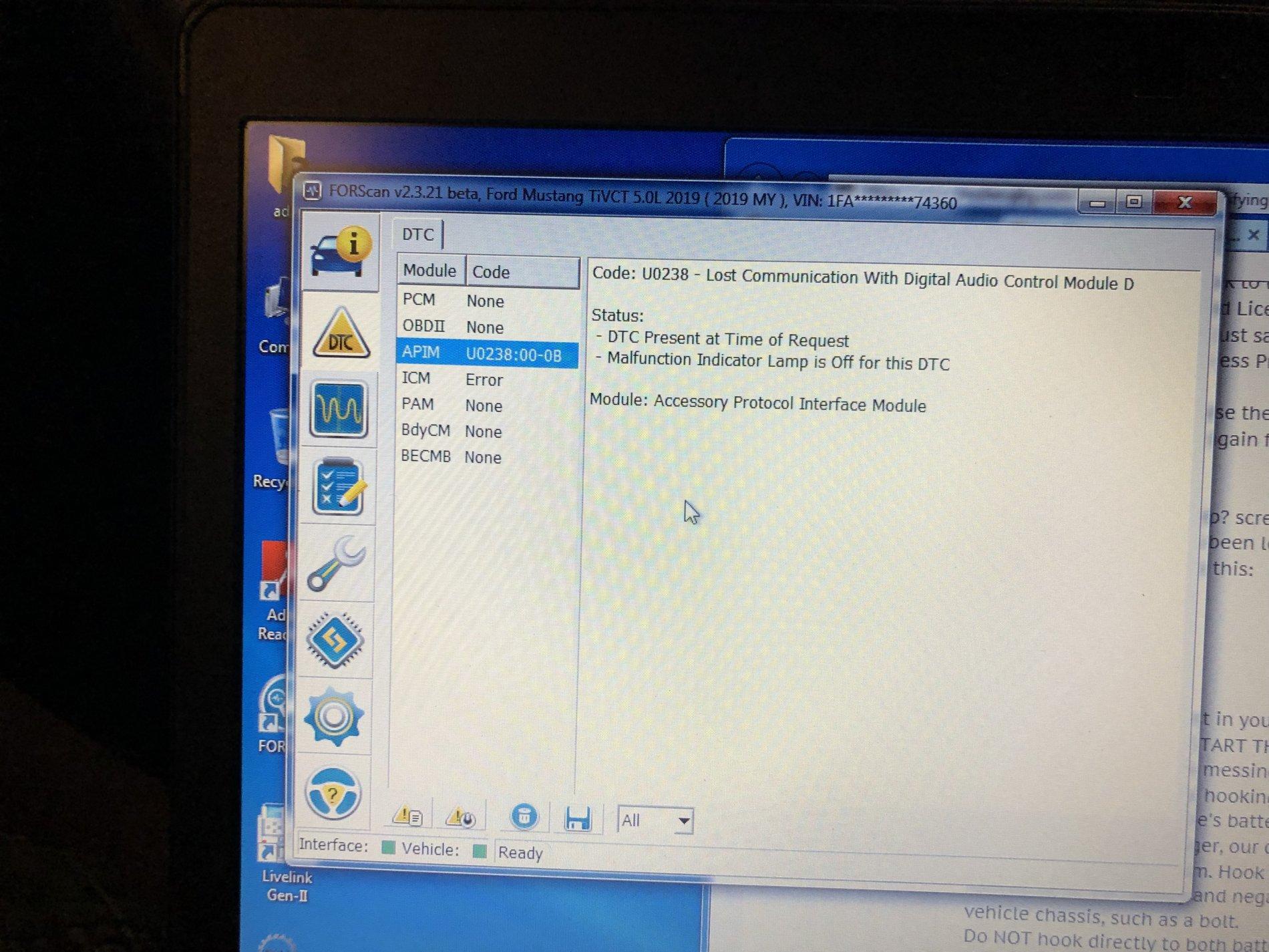

19’ GT upgraded from base to premium everything was plug and play but forscan is giving me an error and I can’t get the mode switch to work. Help

Figured it out!! When I first connected to the car I didn't follow the instructions and flip the switch, so only a couple of modules loaded and of course not the modules that I needed.
Once I reloaded FORScan and scanned the car all the modules loaded, I used the programming sheet and wham everything works! 2018/19 screen upgrade is super easy and I highly recommend it.
