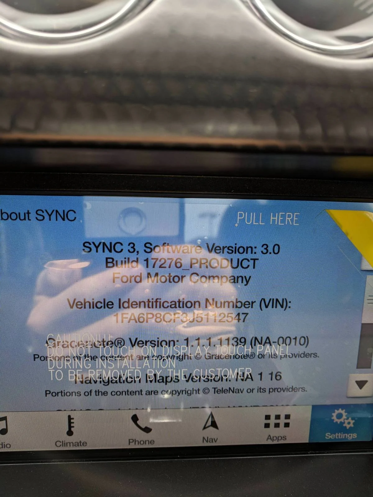

Flashing 3.0 fixed it....
TorqueMan
Aug 24, 2017
693
219
St. Jacob, IL
2017 EcoBoost Premium
Flashing 3.0 fixed it.... ����
Sounds like there was a corrupt file in the system somewhere. Seems like flashing the system should be a first step for troubleshooting at the dealer where they have ready access to that stuff.
