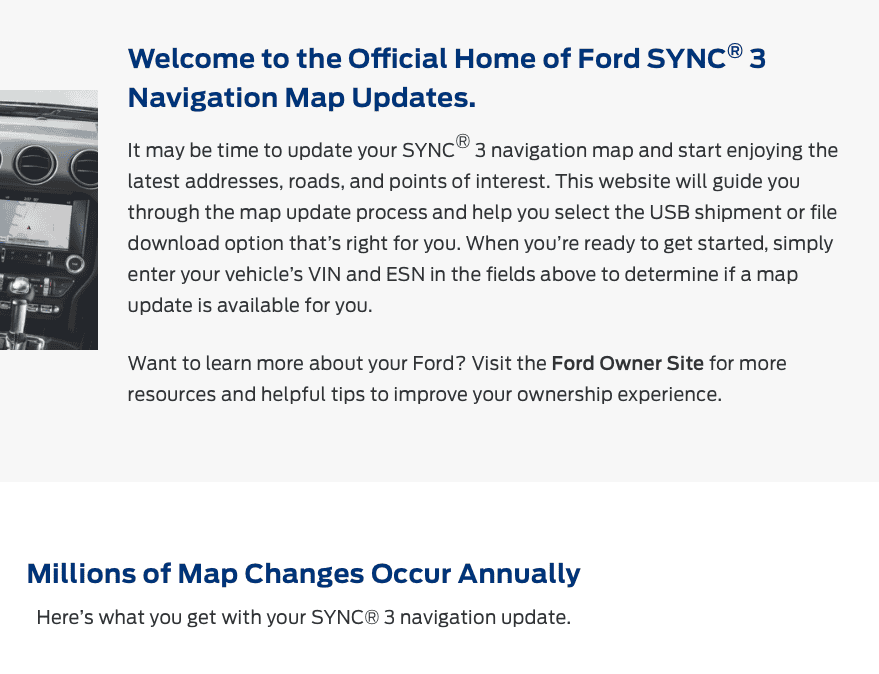

OK, why is everyone just assuming the new issues are due to the SYNC update. The timing sucks for sure but I wouldn't be to fast to jump on the 3.4 bandwagon. It could be just be a coincidence and these issues are not related.
By the way when did you change your lights.
One last thing. Do you do a SYNC 3 master reset and did you pull the battery cable and let it sit for awhile?
Here educated yourselves
