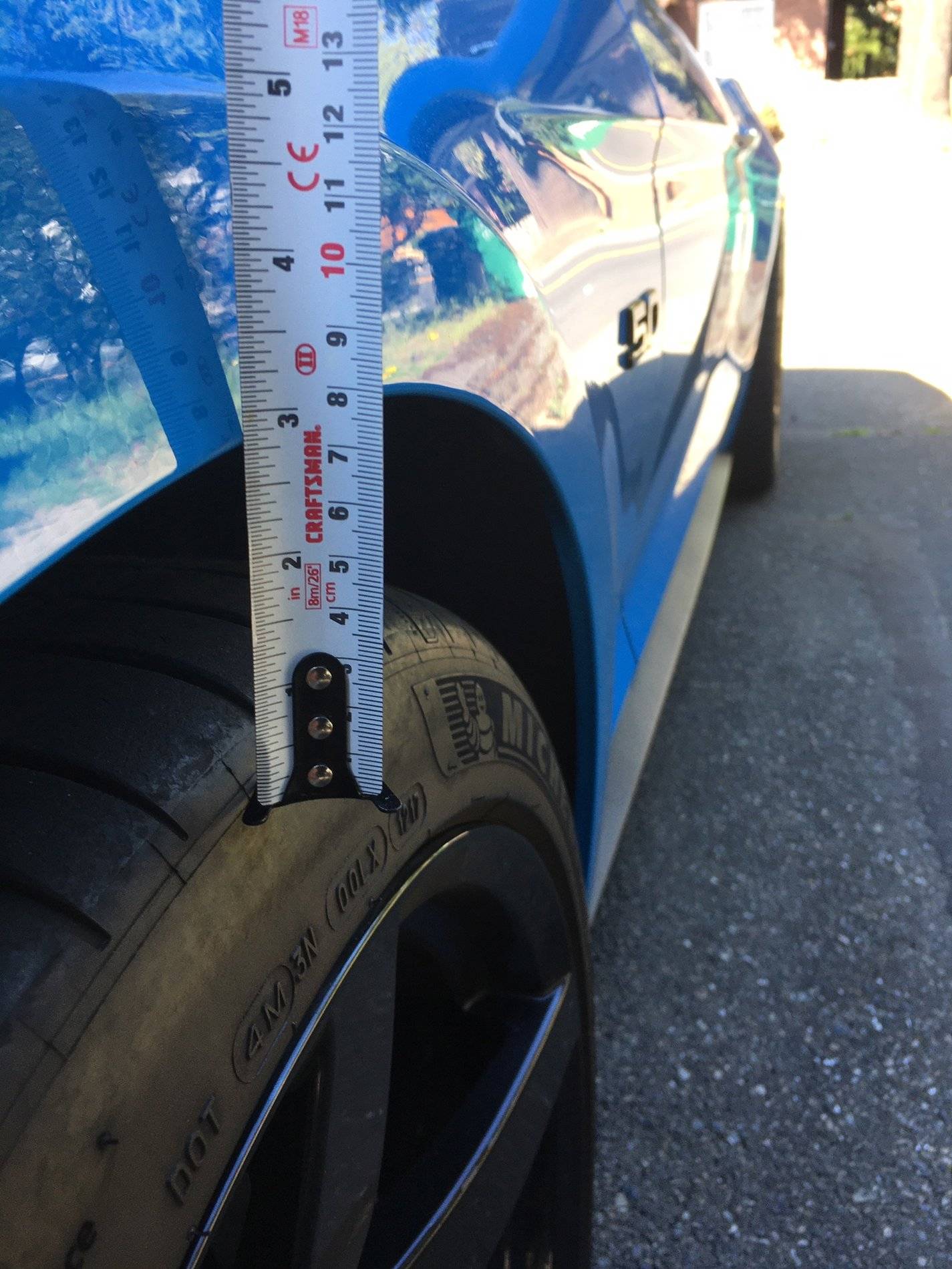

My concern is that I'm running really aggressive and wide tires in the rear. 11x19 rims with 50mm offset - 325 30R19 tires. Right now I have just less than 2" of clearance between the outer edge of the tire and the lip of the fender. Most of the springs I've been looking at boast a 1" drop typically. That sounds like its going to get me into trouble with tire rub if I just blindly throw in a set of new springs. I really want to do this right and all 4 wheels at once.

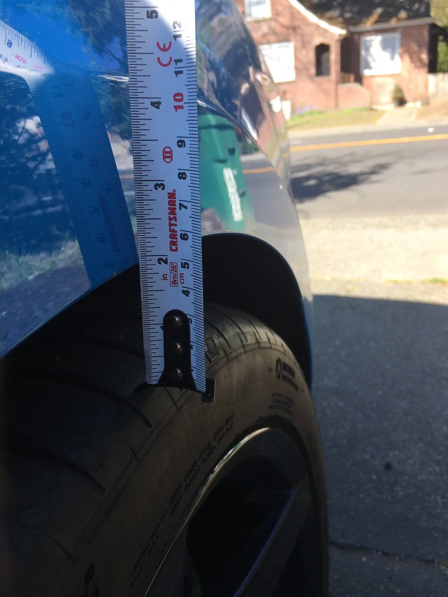

This is exactly right - hence the pics. Front is perfectly fine with 285 35R19s on a 19x10 rim with 35mm offset. As you can see on the stock ride height in a non-PP car I have approx. 3" of gap between the lip of the fender and the tire. I don't see any problems there.
Rear is entirely my concern. That 19x11 rim (50mm offset) coupled with that 325 30R19 tire looks like a 1" drop in the rear is asking for trouble.

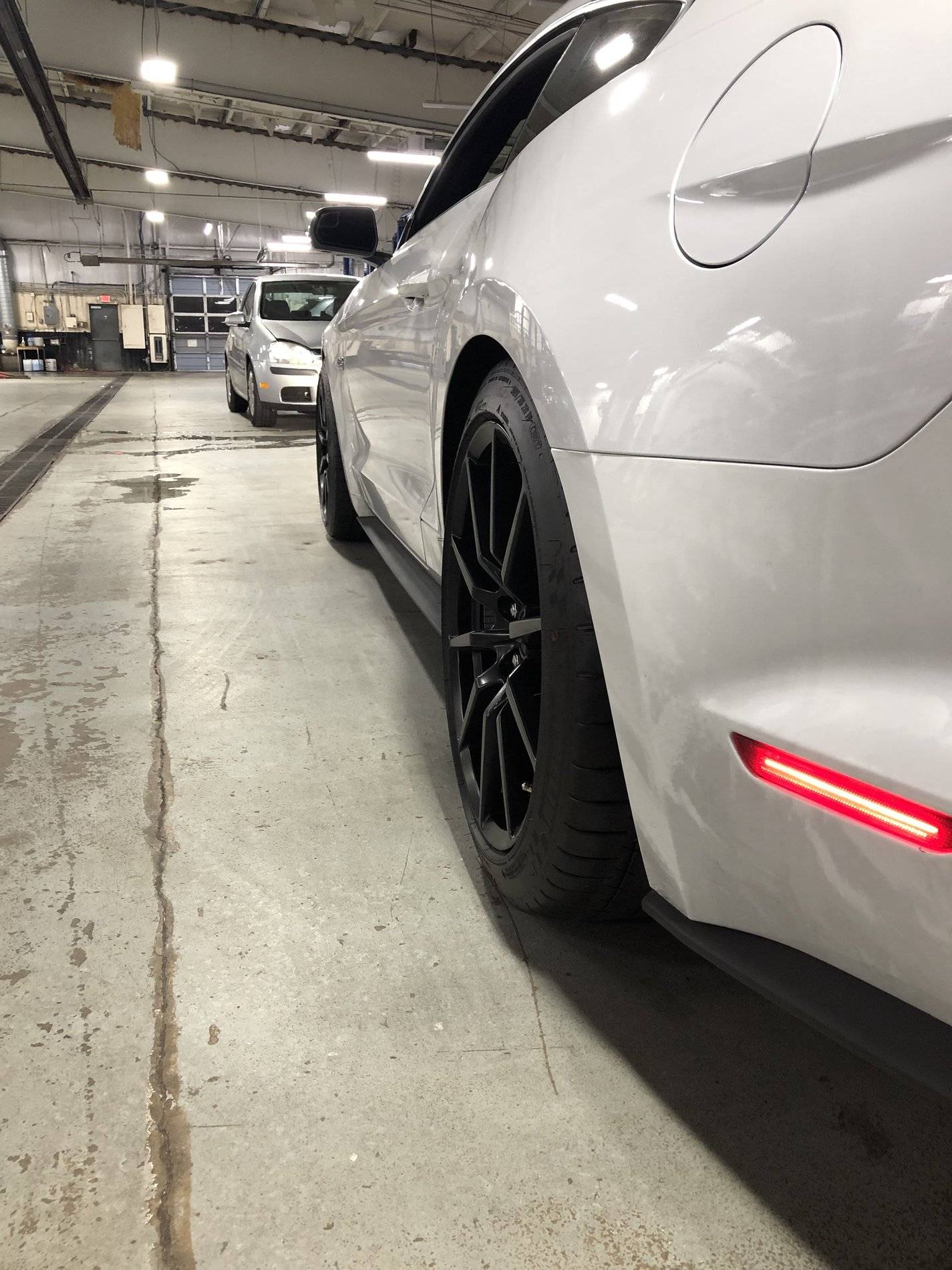

The Steeda minimum drop springs lower the car .5” front and rear. I believe the BMR springs lower the front more than the rear, but am unsure on the exact amounts. I’m sure someone will chime in with the numbers. That may be what you’re looking for though as you have more front wheel gap than rear. Giving you a nice even stance. The widest tire I’ve had on the back of my car was a 305/35/19. So taller than what you’re running and not a direct comparison, but I had a less aggressive offset at +62. My car is lowered an inch and as you can see, there’s a good bit of negative camber going on out back

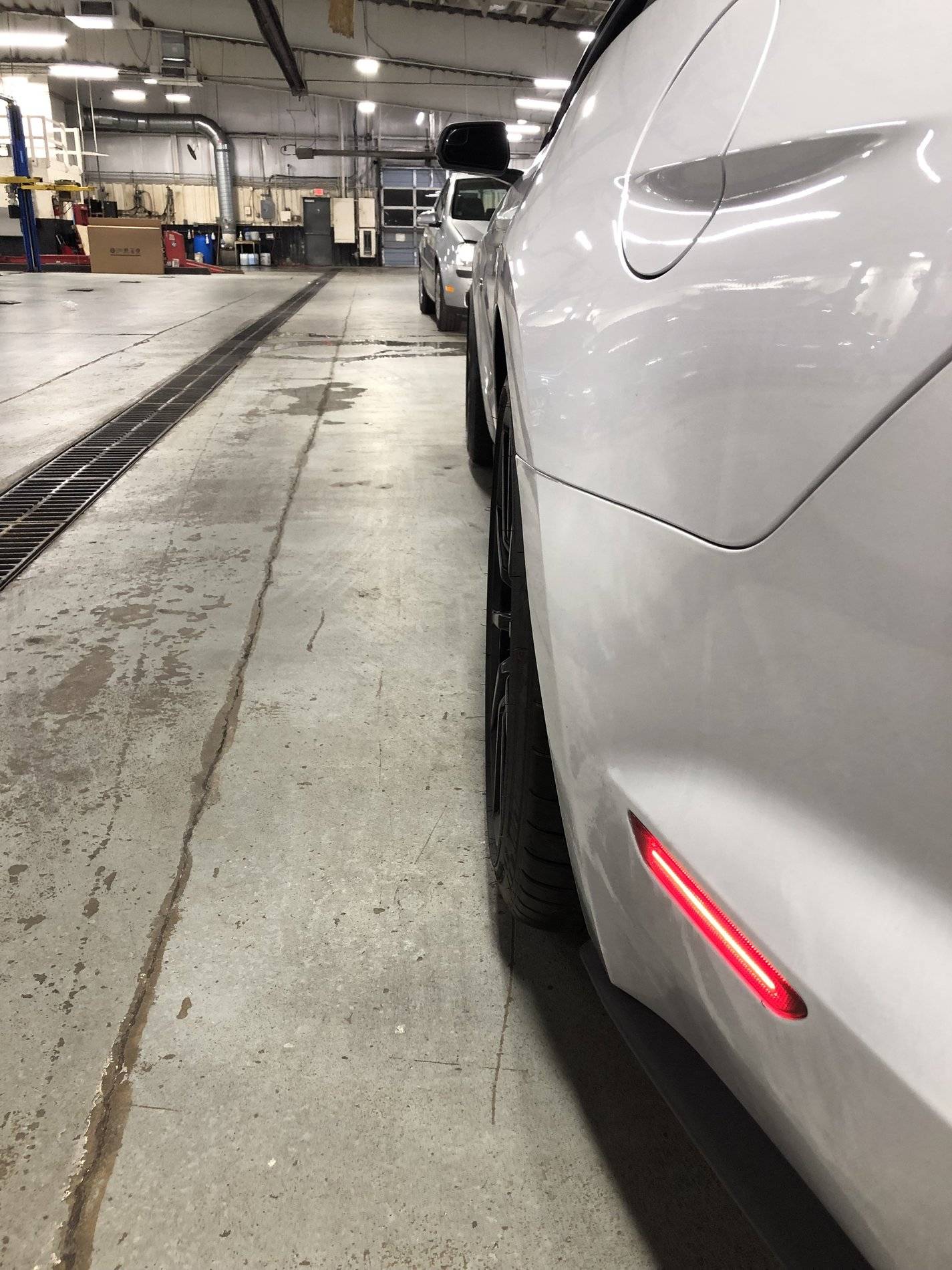

I have a 325 on a 11.5 +56 wheel. Lowered just over .5 on the rear with no issue. I'm switching to BMR sp083 spring in a couple of weeks. Drop on that is .7ish? Drop .88ish for the front.
