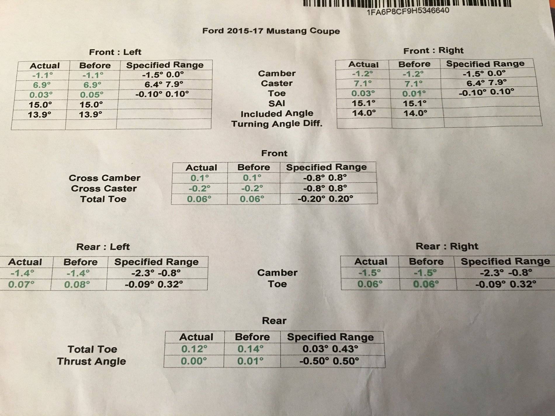

All stock. I had the alignment checked when I re-aligned the subframe before I mounted these wheels over a year ago. That's the most accurate #'s I have:
Rear left: -1.4 degrees
Rear right: -1.5 degrees
(specified range: -2.3 to -0.8)

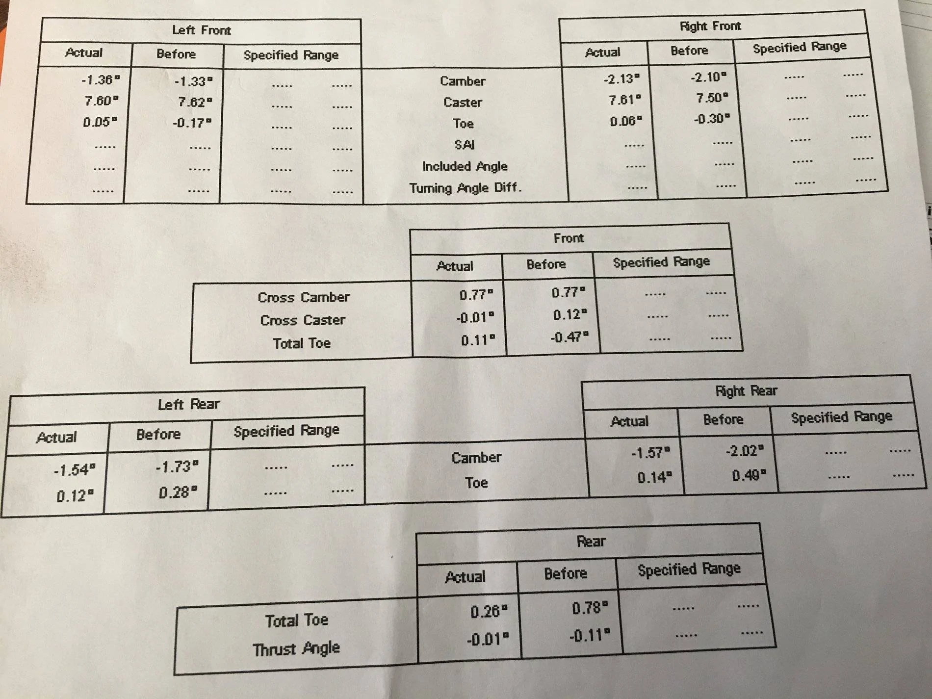

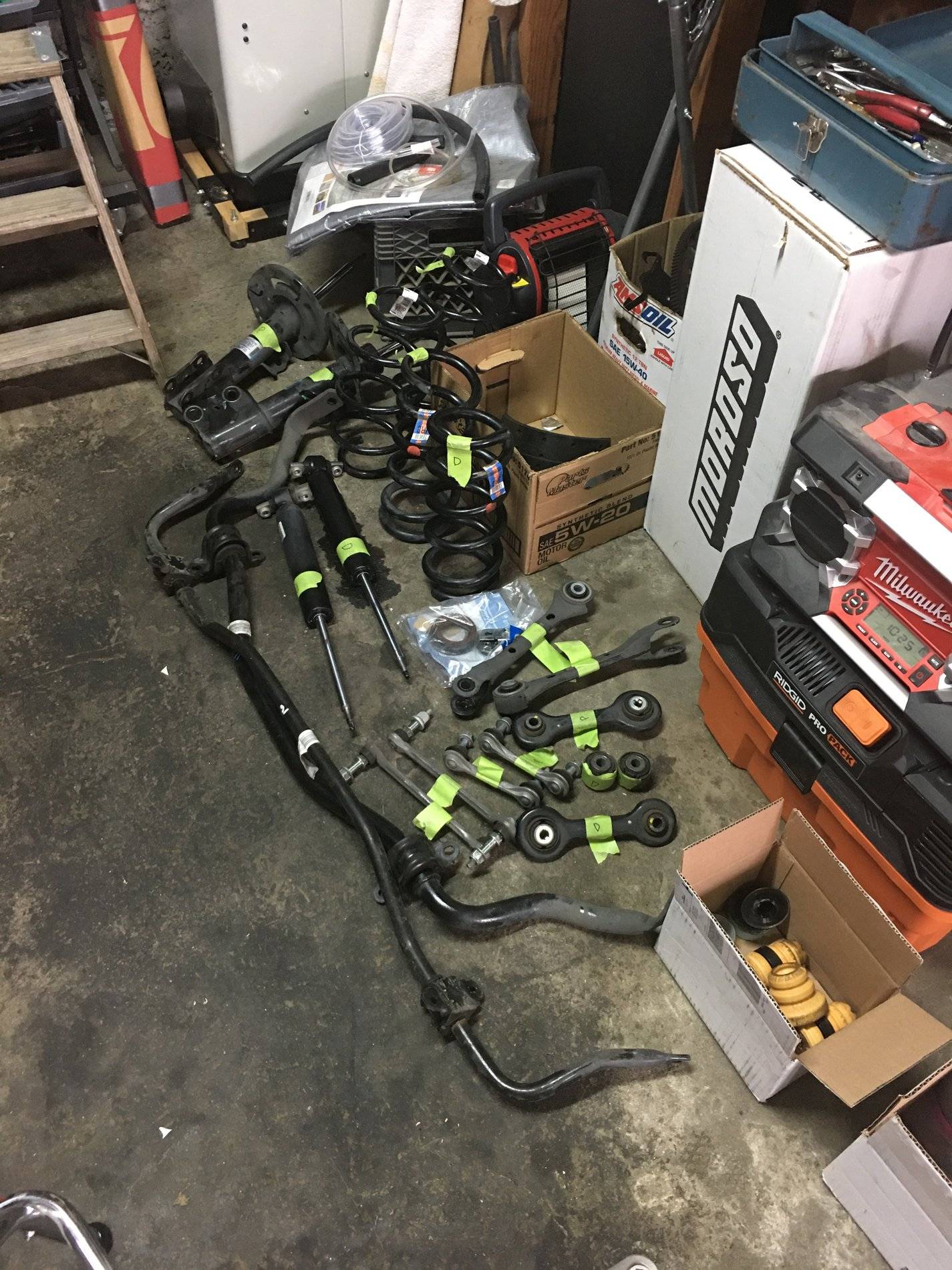

Finished! I'm amazed at how well this car corners now. It's firmly planted - possibly a bit more stiff than it should be (I may have to back the sway bar end links off a tad). I'll have to re-learn how to drive the car.
I have a pile of stock parts on my garage floor including the blown rear driver's side shock and the old oil seal from the drive's side half-shaft. I just got back from alignment and their two biggest pieces of advice:
1. I need to get some camber plates. Both fronts have slightly more camber than they should. They suggested the ones from Maximum Motorsports so I can have a caster adjustment option.
2. Keep an eye on the rear tires and fenders. I don't have a lot of room back there.
They also suggested I adjust the pro action shocks/struts to the hardest, test drive, then softest, and test drive again to find where to set them. Currently I'm at the Steeda suggested spot (softest + 1 full turn on all 4 corners). They suggested I go slightly softer in the rear than the front.
I also included the alignment numbers The first sheet is my numbers right after I aligned the subframe 2 years ago. The second sheet is from today.
for street duty I've seen 1.8F and 1.3R camber being good numbers and rear toe of 0.12 each side for a total of 0.24 not to exceed 0.3. Front toe of 0.0-0.04 not to exceed 0.1 total. So I think you have more to fix.
Definitely - thats why we're talking about camber plates. We'll have to re-align the front to address camber and toe then.
