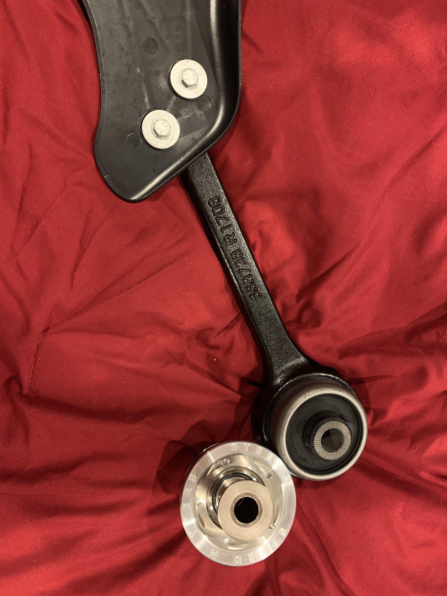

Well I took advantage of the Steeda sale and pick up the control arm to install the tension link bearings I already have to decrease install time. Ordered the alignment kit for the CB005 as well to aid with the 005+762 install
Thinking about going the same route with the RLCA and ordering a set to decrease downtime.
Now to find a shop press!
Yesterday I ordered Vorshlag Shock mounts so the only thing left are the dampers...somewhat procrastinating for eBay to have a big promo before I pay 500 lol
Thanks for all the advice. Can’t wait until install
