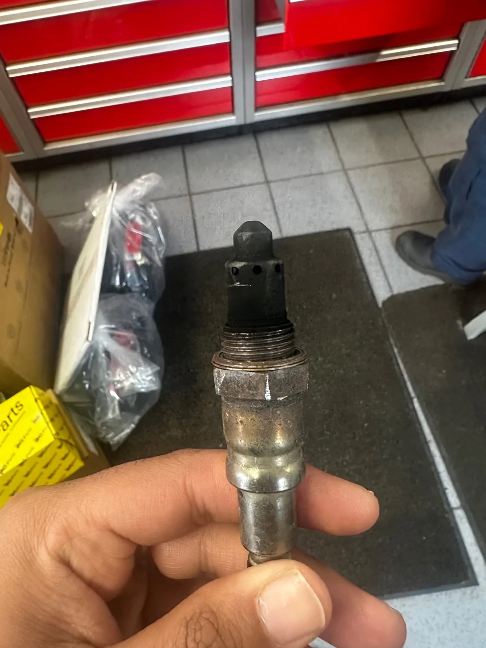

UPDATE:
Turns out it was my bank 1 upstream o2 sensor that went bad, covered in soot. Replaced it with DY1442 and the problem disappeared. Also replaced my plugs while I was at it. Thank you guys for helping out
