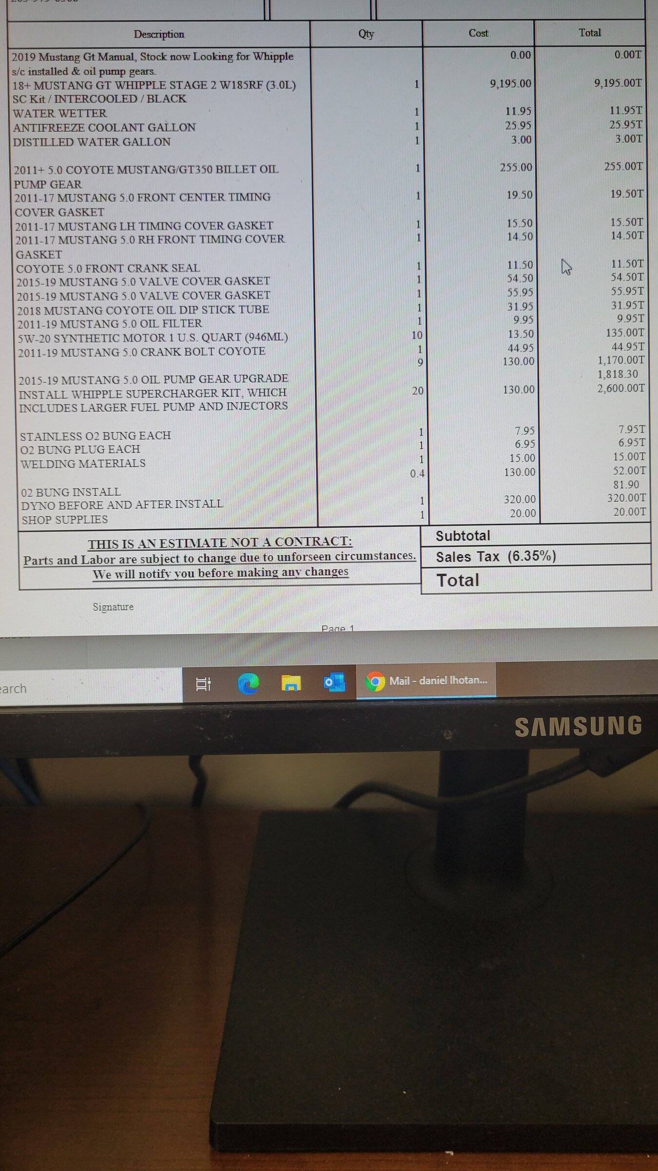

What do you guys think of this estimate. I was basically looking to add the Whipple. But I got this estimate along with the S/C. It came out to 15K. I'm not spending all that.
DM Terry @beefcake
for reference we get $1500 on the supercharger, 8 hrs on 11-17 opg ($125 hr) and 10 hrs on 18 up, due to the pan.
your not super far if you want to have us install as well, we get cars from all over the country, canada, etc.. we've had guys ship from as far as alaska
Im pretty sure he can give you a better price.
