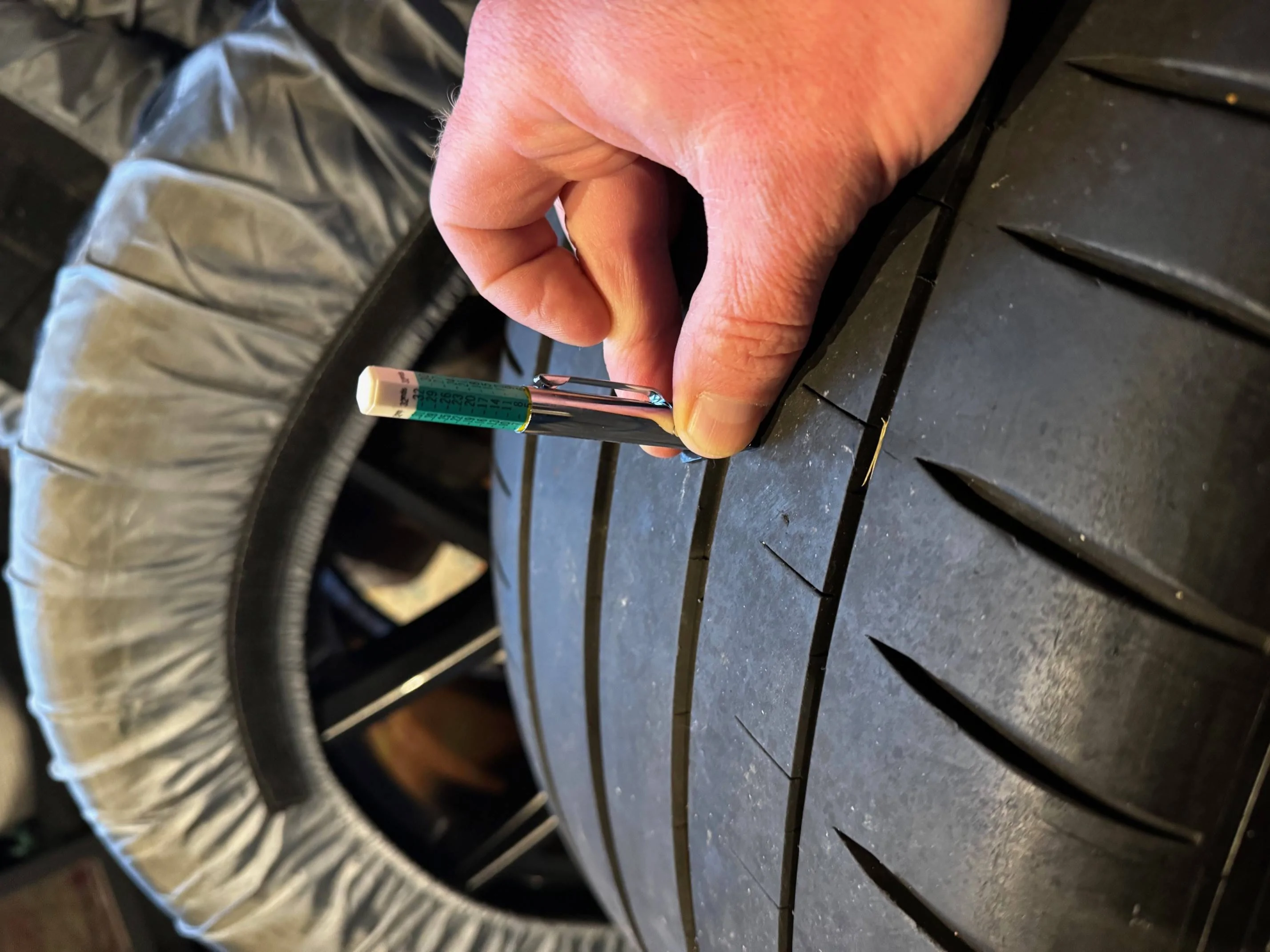

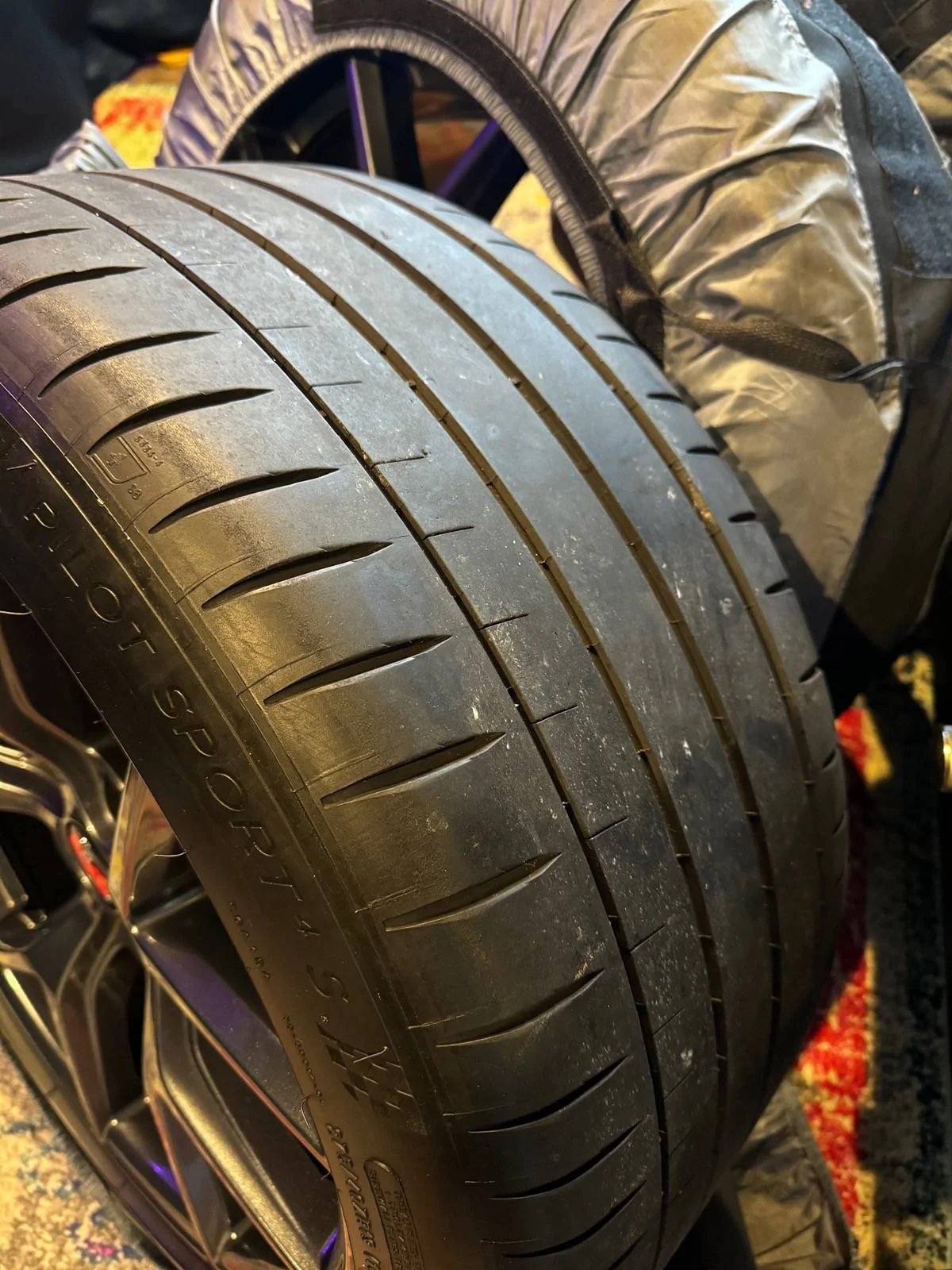

Hi All,
I'm looking for some advice with my Michelin PS4S tires that came on my 2021 Mach 1.
They have about 13-14k miles on them with about 6/32" tread left on them. They are the original tire and this will be their 4th summer. I've had 2 light beginner track nights on them as well where they got pretty gooey.
Last season I noticed that they do not hook anymore, from a dig I will spin through 3 gears and I can swing out the back very easily when taking a corner.
My 3 year old, 10k mile all-season Continental DWS sport tires that I use 7 months of the year are wayyy better in every aspect of grip.
So my question is, are these tires more than likely cooked even though they have plenty of tread left?
If I get new ones will 1 or 2 track nights a year ruin my new tires on the street as well?
I called Tire Rack and Michelin, Tire Rack said heat cycles make the compound harder and Michelin said it has no affect.
Side note, when I went to the track late last summer, the tire seemed to grip fine. It's on the street that they suck.

Got any more pictures of the tread area? I see a little bit of sheen to them but it may also be the lighting.
ChitownStang
ChitownStang
Mar 9, 2015
81
3,259
4,198
Chicago, North Shore
2021 Mach 1
They just got pulled out of my crawl space. Here’s another pic I had.
I can take them outside when I go home for lunch.
