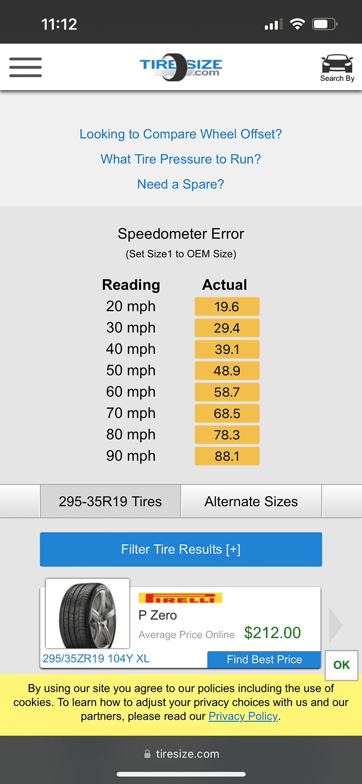

I run 275/40 square on 9.5" O-Z rims. Wheel gap looks identical front and rear. I don't lower my car either, so the gap is uniform all around the fender. Furthermore, your speedo/odo is calibrated for 275/40 in the back, so going smaller diameter will indicate higher miles than actual.

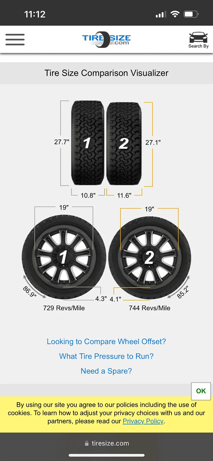

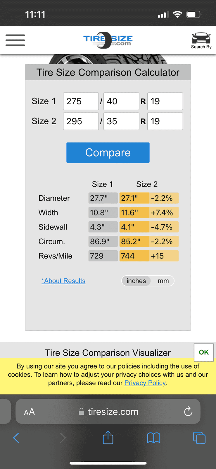

Here’s your differences between 275/40 and 295/35 as to what @GTP was saying
FWIW, I have basically the identical difference in height, just going up instead of down, when I put my summer set on (285/35/20 from 235/50/18).
