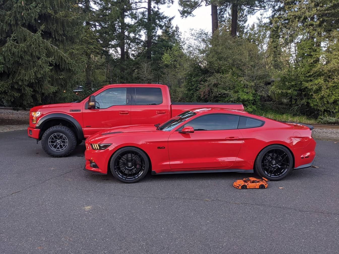

You could get yourself a matching tow vehicle like I have....
Realistically, for pulling an S550 on a trailer an appropriately equipped 1/2 ton will do. If you're looking at a 2009 or so F150 I'd avoid the 5.4 Triton like the plague as they like to spit out spark plugs as the heads were not designed with enough threads.
Im not married to the 09 F150 but just used it as a starting place. Thanks for the heads up!
I agree with the 5.4 avoidance. They also have cam phaser issues mainly on the passenger side. Poor oiling design. Get a newer 5.0 truck, no problems there.
