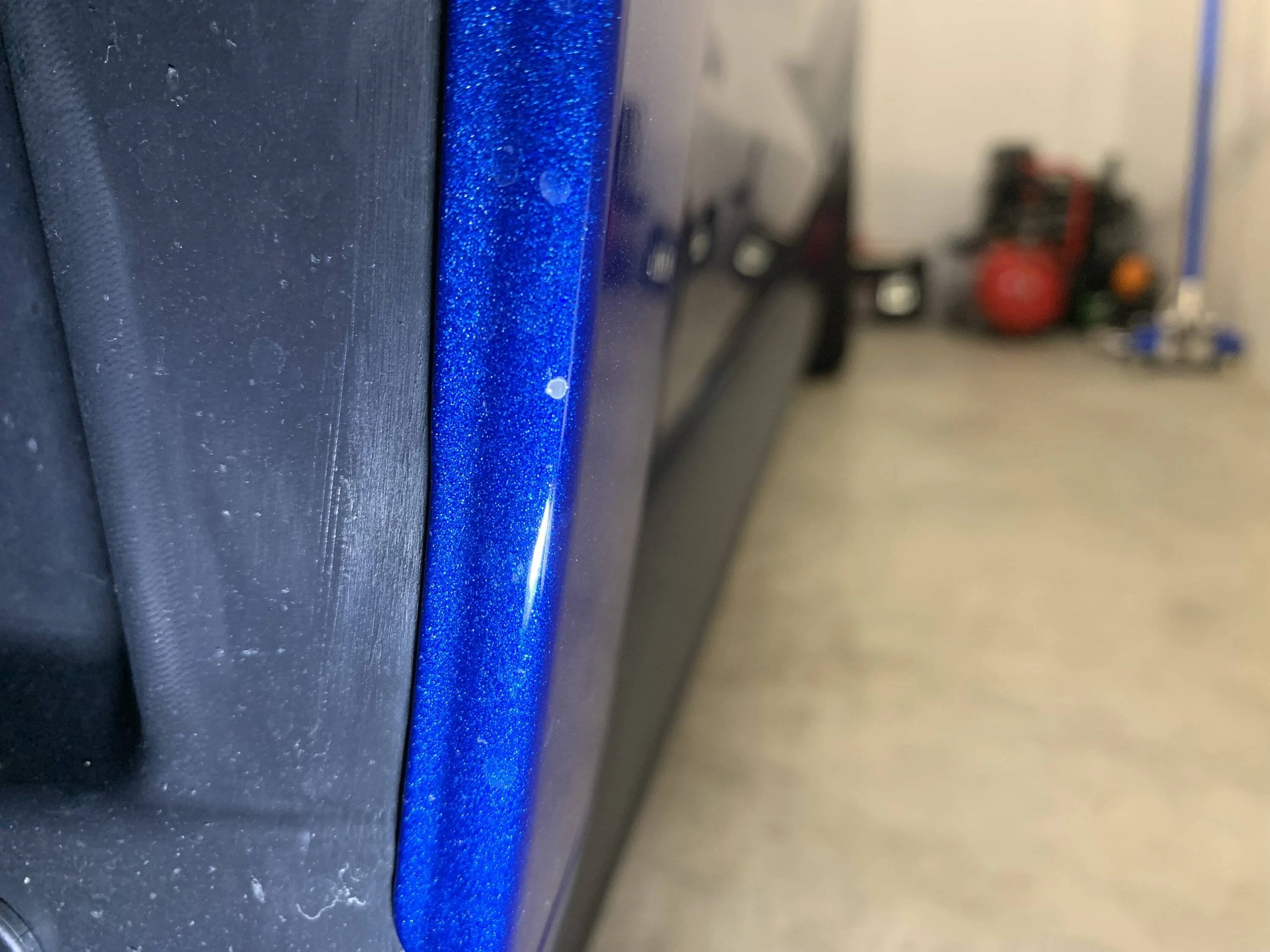

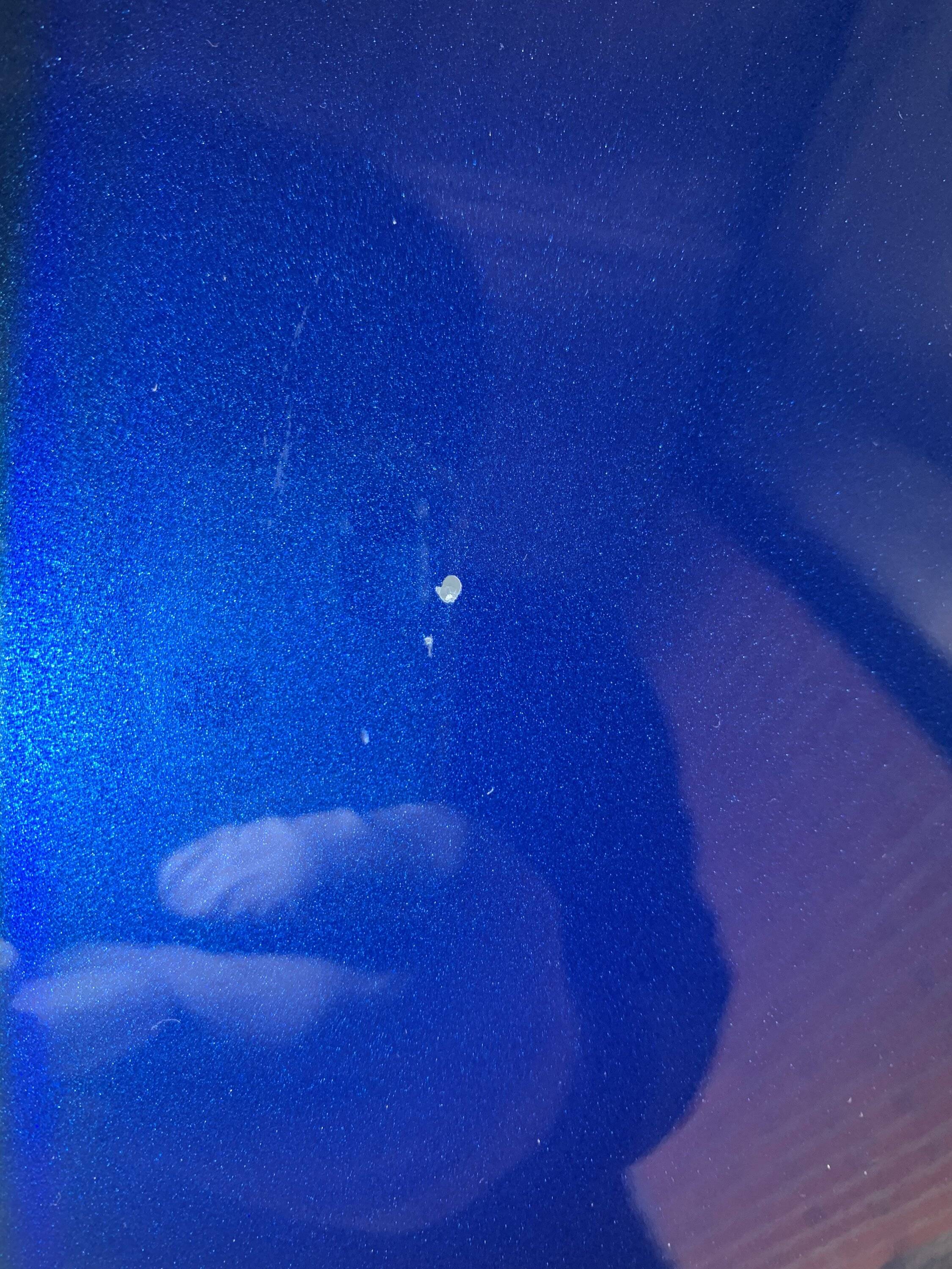

Hello guys,
I need a suggestion on the best approach on how to fix a couple of paint chips from debris.
Specifically, I don't understand if I have to put primer on the paint chip or if I can paint directly.
By looking at the photos (which are larger than what the eye can see) it looks to me that the primer is still there in both cases.
This one is on the hood:
This other one on the lower part of the wheel arch:
I was planning on degreasing the surface with alcohol and then filling the spot with those little pens with a mini bucket on the end and a 0.5mm needle drop at the end.
Let it dry, make multiple passes of it, then clearcoat and polish.
Any suggestion to make the best job possible?
Thanks,
Luca

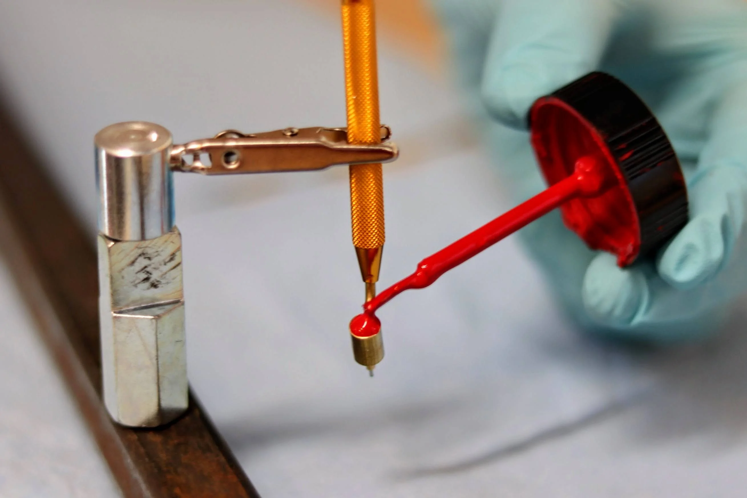

Please post an example of such product.
Something like this, with the smallest needle/tip you can get!
I'm not convinced that is what OP was referring to.

Someone suggested this on Amazon?
https://www.amazon.com/gp/product/B07YD4J6J6/ref=ox_sc_act_title_1?smid=A3NH62PVIF1NYU&th=1
also where can I get a good clear coat?
I think the "pen" device I identified is much more precise than that kit. I'm buying a USA-made one, it costs a little more but I've got more peace of mind compared to the Chinese clones which are cheaper.
