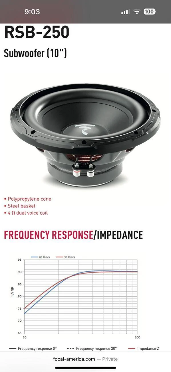

I am looking to add subs to my car and wondering which would be better. I already have the factory sub, but it is not adequate for my liking. I have had the JL Audio subs before, but the specs for the Focal look better. They are about $50 more, but that isn't a factor. Each will get about 400 wats RMS if that matters.
Focal RSB-250JL Audio 10W0v3-4
ConditionNew StockNew Stock
Features and Specs
Size10-inch10-inch
Impedance (Ohms)
The amount of resistance that a sub presents to your amplifier -- the higher the number, the more resistance. Some factory subs are 4-ohm models, but many premium systems use low-impedance subs to get more power out of the factory amp. When you replace a 2-ohm factory sub with a 4-ohm aftermarket model, you'll have to turn your radio's bass control up a little more to get the same level.
2, 84
Cone MaterialPolypropylenePolypropylene
Surround MaterialButyl RubberFoam
Basket MaterialSteelSteel
GrilleNone includedNone included
Free-AirNoNo
Dual Voice CoilYesNo
Sensitivity88 dB at 2.83 volts84.07 dB at 1 watt
Frequency Response35 - 500 Hz25 - 250 Hz
Max RMS Power Handling250300
Peak Power Handling (Watts)500600
Top Mount Depth (inches)4 3/84 15/16
Bottom Mount Depth (inches)N/AN/A
Cutout Diameter or Length (inches)9 3/168 13/16
Frame Width
The distance across the frame, useful in determining fit in vehicles with restricted mounting locations.
10.63410.526
Frame Length
10.63410.526
Vas (liters)4231.01
Fs (Hz)2932.09
Qts0.590.604
Xmax (millimeters)011.4
Parts Warranty1 Year1 Year
Labor Warranty1 Year1 Year
Box Requirements
Ideal Sealed Box Volume (cubic feet)
The ideal recommended interior volume in cubic feet that a ported box needs for the sub to deliver its rated performance. Your sub will perform best if the box volume is within 20% of this ideal spec.
0.710.65
Minimum Sealed Box Volume (cubic feet)
The minimum recommended interior volume in cubic feet that a sealed box needs in order for the sub to deliver its rated performance.
N/AN/A
Maximum Sealed Box Volume (cubic feet)
The maximum recommended interior volume in cubic feet that a sealed box needs in order for the sub to deliver its rated performance.
N/AN/A
Ideal Ported Box Volume (cubic feet)
The ideal recommended interior volume in cubic feet that a ported box needs in order for the sub to deliver its rated performance. Your sub will perform best if the box volume is within 20% of this ideal spec.
0.881.125
Minimum Ported Box Volume (cubic feet)
The minimum recommended interior volume in cubic feet that a ported box needs in order for the sub to deliver its rated performance.
N/A0.87
Maximum Ported Box Volume (cubic feet)
The maximum recommended interior volume in cubic feet that a ported box needs in order for the sub to deliver its rated performance.
N/A1.35
Port diameter (inches)N/AN/A
Port length (inches)N/AN/A
Owner's ManualOwner's ManualOwner's Manual

The Focal vs JL Audio for subs.
In full disclosure, I have only ever owned JL Audio, Rockfordfosgate, and Precision Power subs. Currently have a JL Audio sub in my Mach 1.
Now, if you’re picking a sub, there are some things I use to make my determination of which is better for me.
1. Frequency Response. Knowing the type of music I like (R&B, Rap, Live Gospel). There is a need for a lower frequency response because rap in particular often has a heavy bass line that goes into the lowest frequencies of human hearing.
Focal 35-500Hz vs JL 25-250Hz, JL Audio is playing a lower frequency and I need that.
2. Xmax which is the Maximum Linear Excursion of the cone and voice coil; tell me how far this sub is capable of moving to hit the lower notes. However, Focal has not released this measurement.
3. -3 DB CUTOFF FREQUENCY (F3) shows the speakers starts to attenuate its output at certain frequencies. The JL Audio sub -3 db is 29.6 Hz and the Focal is -3db is 33Hz using the chart I found on Focals website.
Bottom line, I would go with the JL Audio sub due to my taste in music and desire for deep bass. However, I will say that I appreciate the Butyl Rubber surround material at this price point from the Focal. Lastly, I’m not a Focal hater because the entire interior component speakers in my car is Focal.
If at all possible, go to a shop where you can listen to both perform. Your ears will tell you more than these values can because YOU have to like what YOU hear in the end of the day.

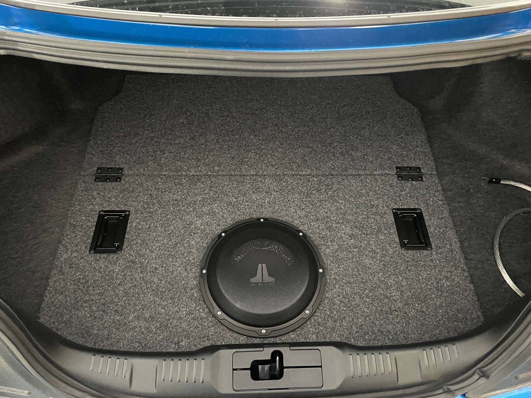

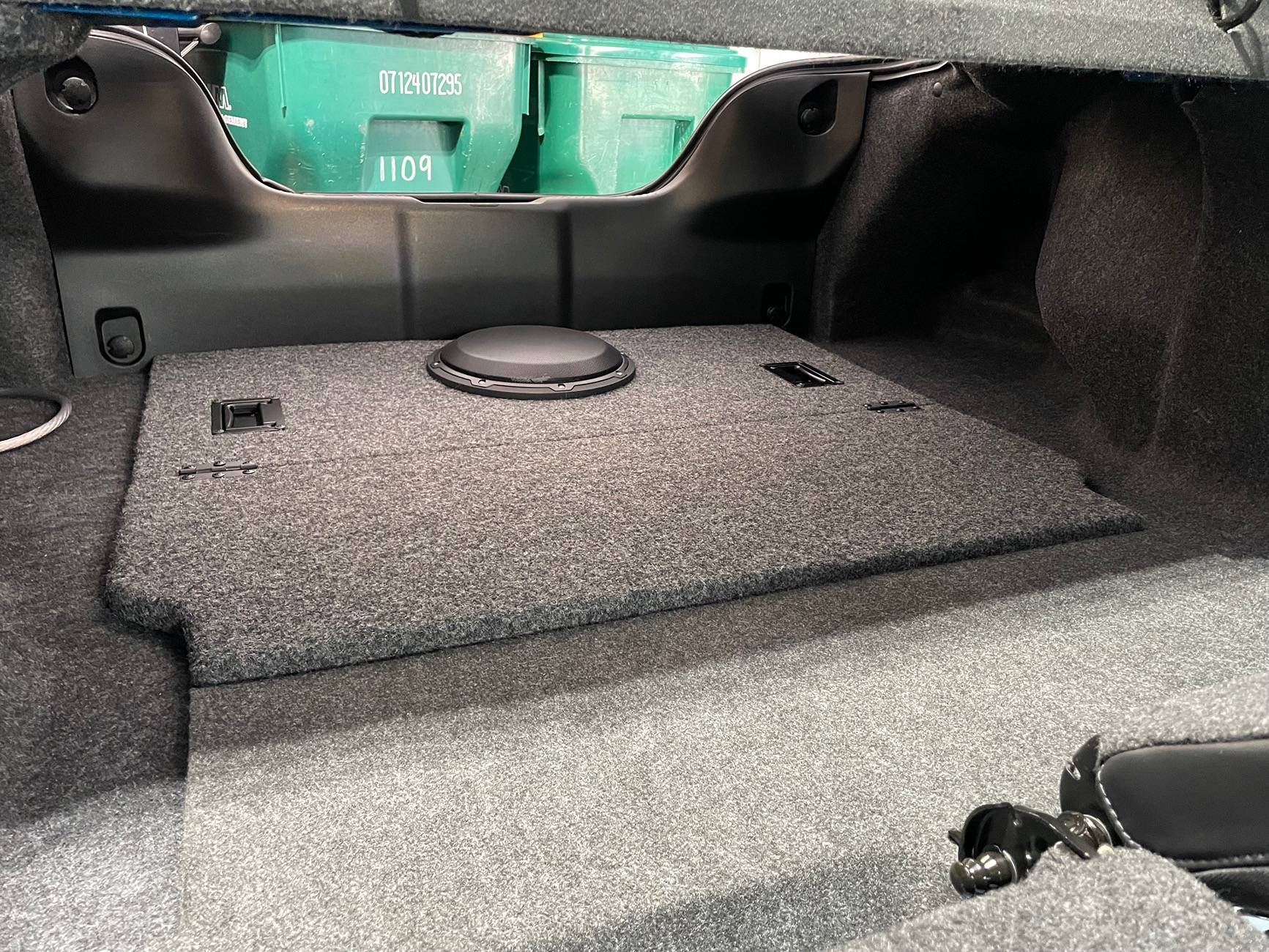

This is how I did mine. The amp rack is in the spare tire well. JL Audio 12W3 4 ohm
