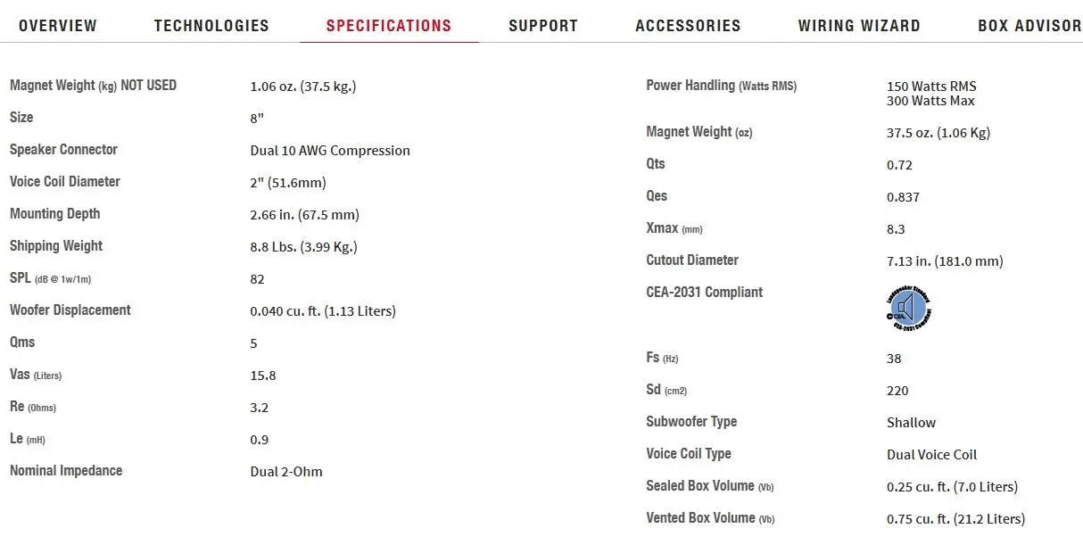

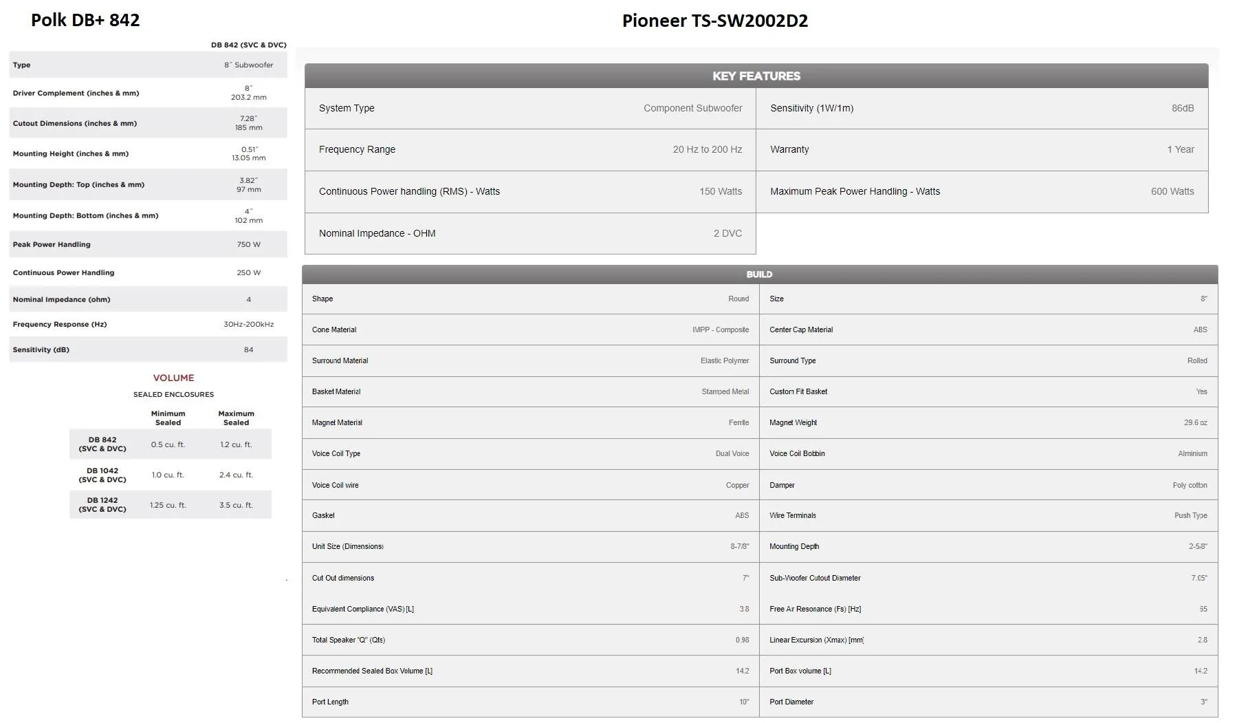

If the stock sub is 2 ohm DVC, that would mean I'm losing out on some power from the stock amp by running the Polk 4 ohm DVC sub. If that is the case, I'm looking to replace it with a 2 ohm DVC sub in hopes of improving the output from it. At this point, I have no desire to go down the rabbit hole of replacing everything, though at some point I probably will. I'm looking at the Pioneer TS-SW2002D2 to use in the factory box with the factory amp. I've attached a picture with the relevant specs for both the Polk I currently have and the Pioneer I'm looking at. Assuming the OEM sub and amp are 2 ohm, I can only guess the Pioneer would give better output as it is better matched to the OEM amp? I'm not displeased with the Polk, I'm just looking for something a little more oomph.

There's also the Punch P3S shallow 8" 2ohm DVC for the same price. My concern with it is the recommended sealed enclosure size is 0.25 cu/ft, and from what I have read, the oem box is 0.4 - 0.5 cu/ft. Also it has lower sensitivity rating than the Pioneer at 82 db vs 86 db. How does that amount of variation translate into real world difference in sound?

I managed to get to my storage room today and measured the sub. It was bouncing between 1.5-1.9 ohms. I think I’m leaving something in the table with the Polk sub being 4ohm DVC.
