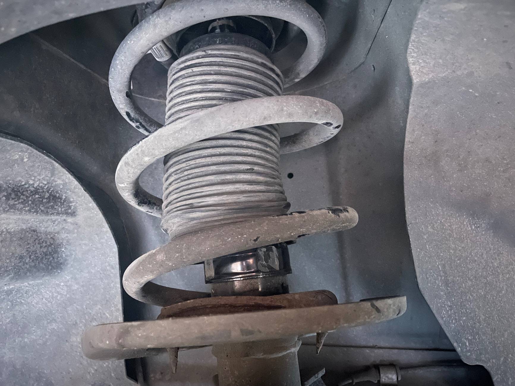

Just jacked it up and there’s no wheel play. The strut boot cover though isn’t attached at top or bottom, just loosely sliding up and down. The strut rod is bone dry and I don’t see any oil leak. The yellow thing on the strut rod was also loose but I have no idea what that means. When I lowered the car, I heard a faint hiss not from the jack.

That's a normal strut...probably a tire

The yellow thing on your strut is called a bump stop and it is normal
