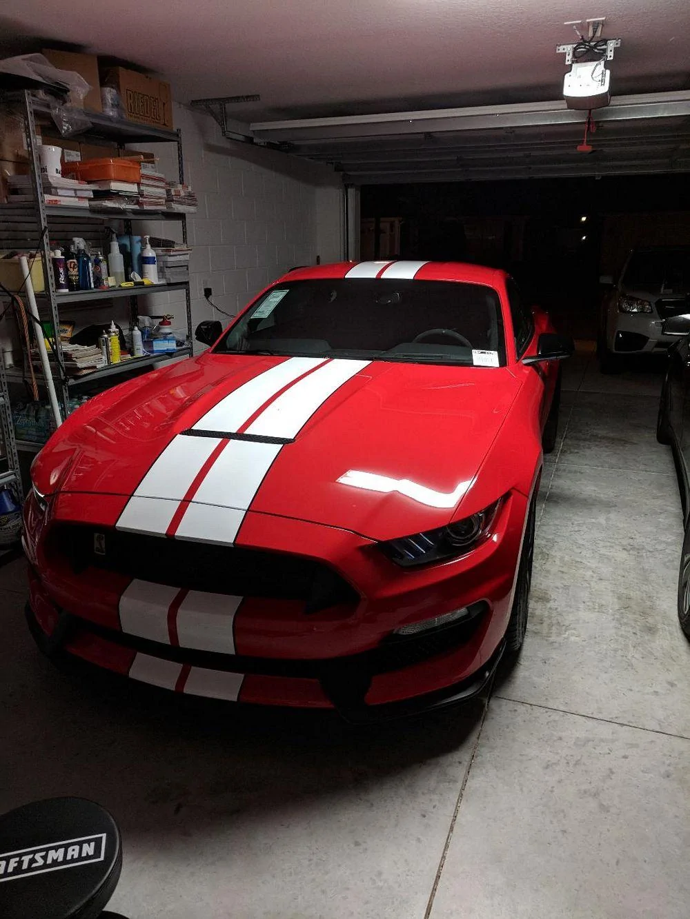

Yes, I removed mine within 48 hours. If the stripes were painted on the car and then clear-coated over.......#1. I'd be stuck with them. #2. I'd feel they were done properly.
They weren't much work to get off, just remember, there may be surprises underneath. I had a horrible area where some knucklehead tried to wet sand a dirt nib. Ultimately, it didn't matter to them because they were putting a stripe on it. Luckily, I can detail cars and I fixed it.

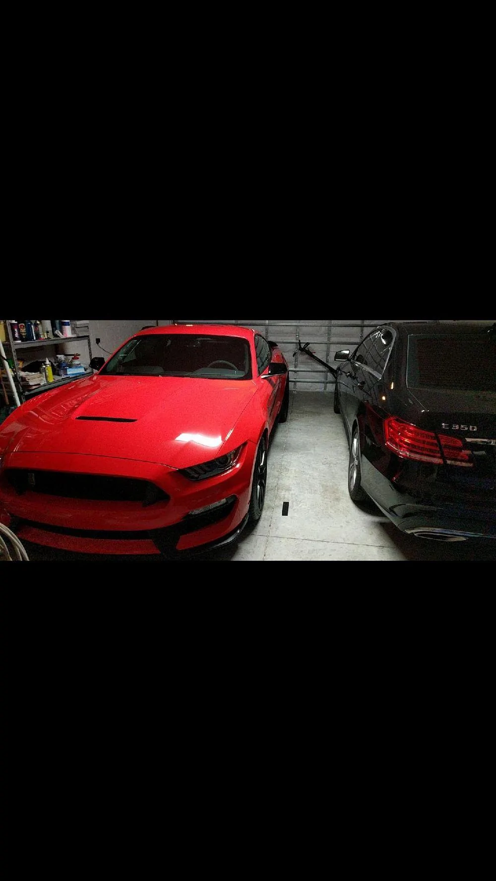

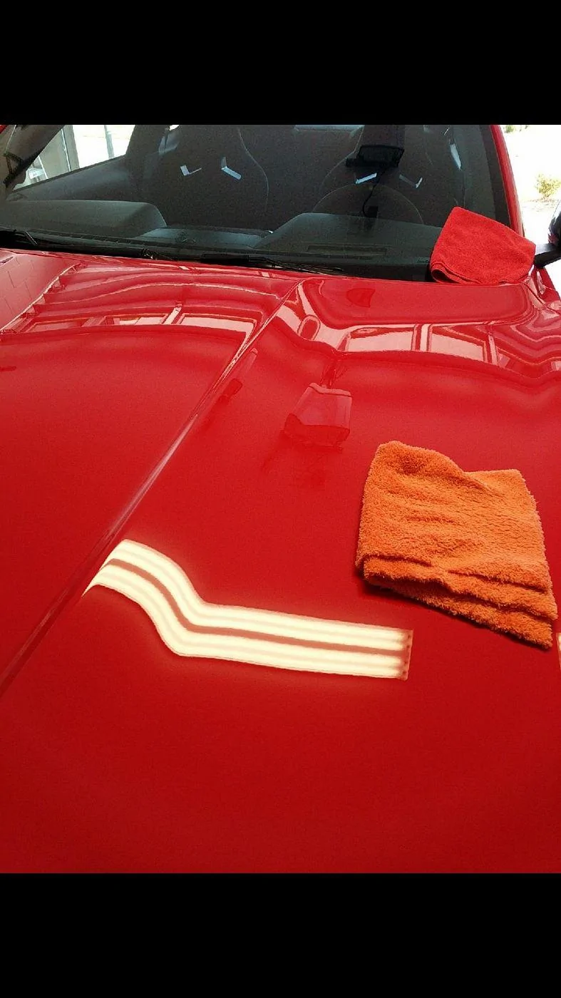

The car was brand new and here are the steps I took after removing the stripes.
1. Wiped down with 3M wax and adhesive remover (similar to a prep solvent)
2. Washed car
3. Used 3D BDX iron eating agent on the paint
4. Rewash
5. Clay bar
6. Polished with Sonax 04-06
7. CarPro Eraser wipedown
8. Wolfgang Deep Gloss Paint Sealant
