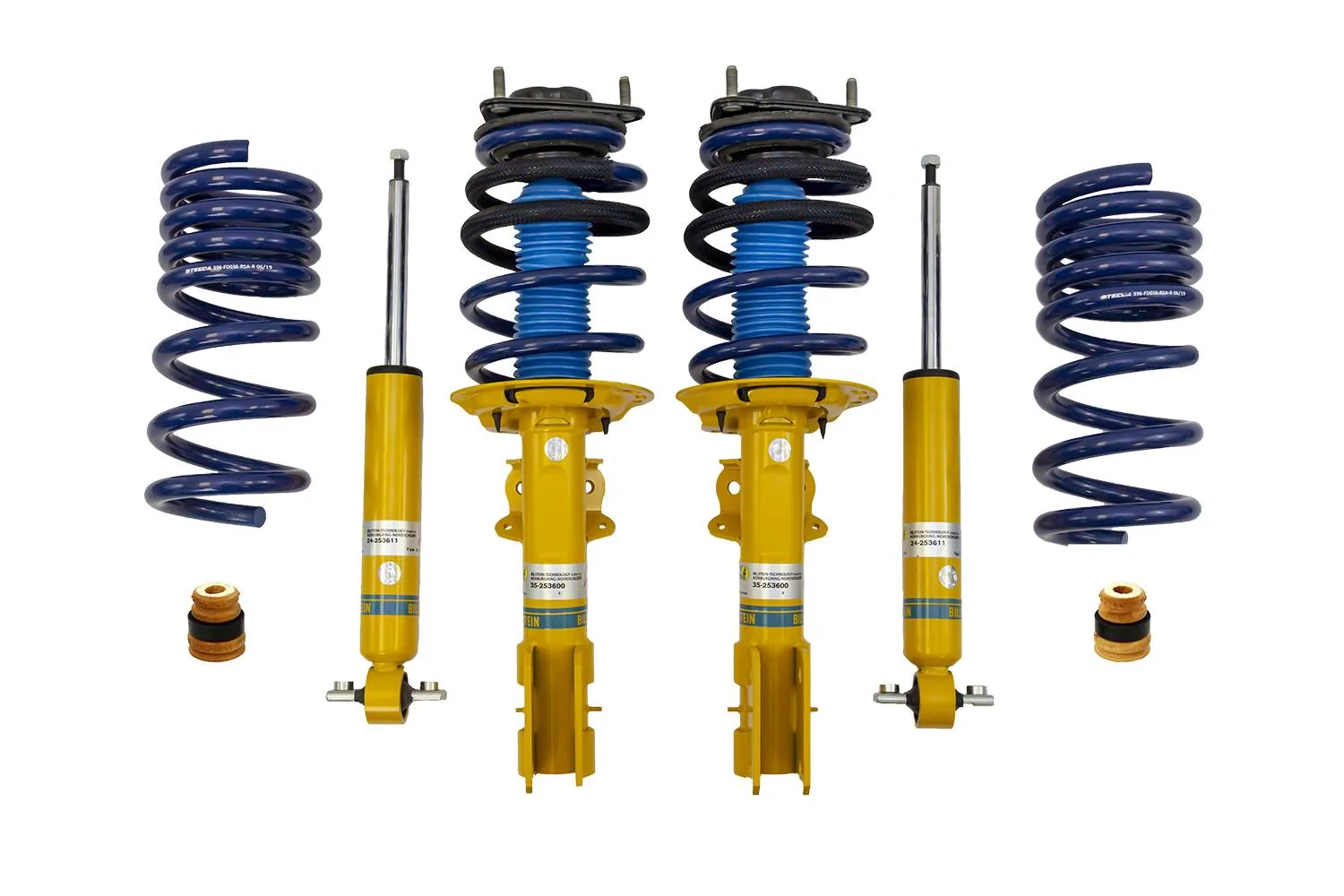

I grabbed steeda min drop (not bmr) which only drop 0.5. Also the bilstein are reported to raise height a little cuz of the high pressure gas so final drop could be around 3/8.

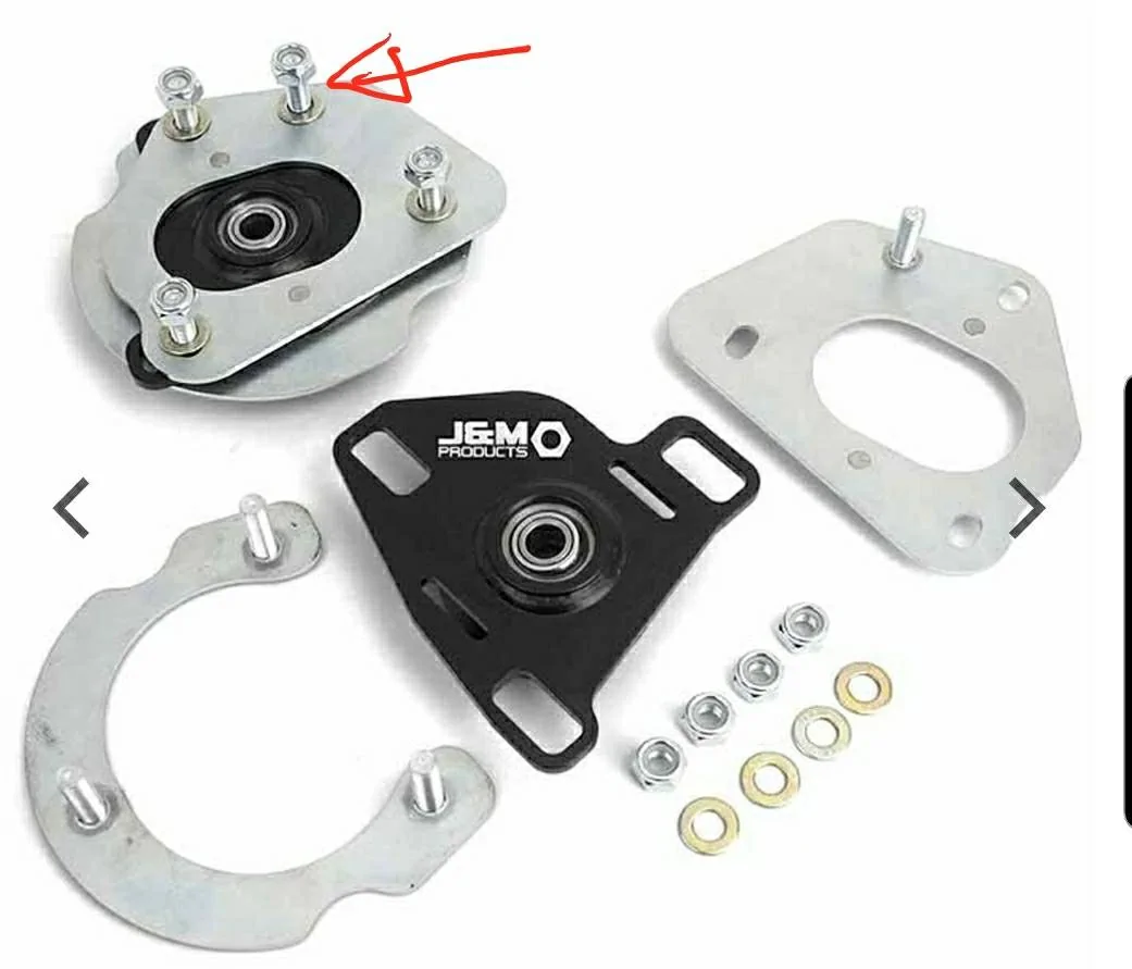

I've had the BMR, Vorshlag and now J&M. The J&M are my favorite of the three I've owned. Vorshlag are very nice and have a ton of adjustment range, but I find the overall design of the J&M superior.

You can probably just get away with camber bolts. Plates are a better solution but bolts do the trick well for street use.
Those J&M look really good and are not very expensive. Does the 4th bolt require any cutting on the strut tower?

Nope, that stud is for the independent caster adjustment. If you leave that tight and the other 3 loose, you adjust camber only. If you loosen all 4, you can do caster as well. The hole is already in the tower.
Didnt know our car had so many holes :lipssealed:
Checking if there's a vendor offering good shipping rates to PR. Seems like J&M doesnt ship directly to PR.
However, these plate look real good for the price and caster adjustability, thanks again for the tip!

Grabbed a set of Maximum Motorsport Camber Plates from a forum member.
Preferred the J&M indipendent adjustability but budget played a mayor role...
Just hope MM are easily adjustable and dont add much NVH
