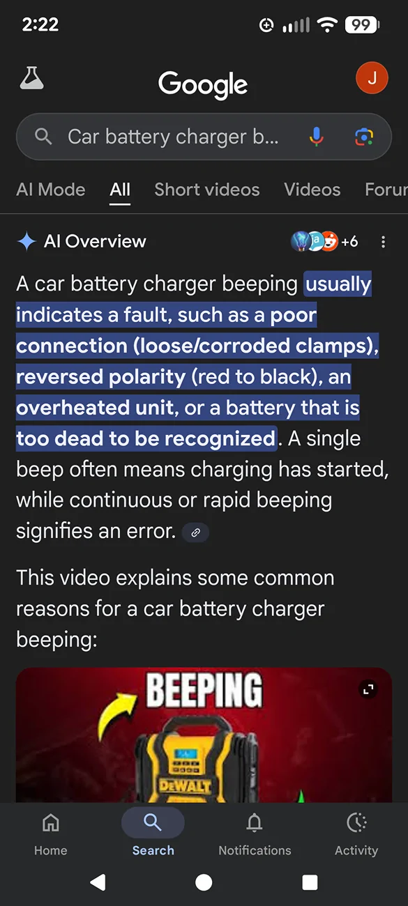

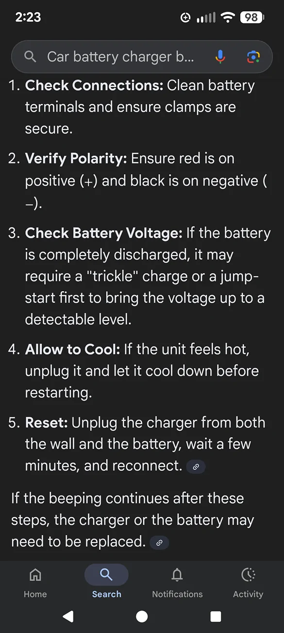

Can you provide an audio sample of the sound?
Can you look into the interior, to see if the in-dash display is alerting something?
Are all personal electronics disconnected and removed from the car?
You've had the car for a while, stored it previous Winters in the same way. Check.
Wengerd tune. OK. (Tuning device/pod/gauge beeping?)
The car seemed to be doing well for a few months this time. I'd start by simply re-checking everything.
- Check under hood, under car and inside, for varmints bedding down and gnawing the wiring
- Confirm the connections to the battery are secure
- That the tender is working correctly
- That the car is off. That it is not in accessory mode
- Check the in-dash display for messages
- That all personal gadgets (radar detectors, handheld electronics, etc.) are removed from the car
- That the doors and trunk are secure
- That the car is locked
- You've been doing this for years, but ensure all fobs are distant from the car, preferably in Faraday pouches
If that doesn't bring about any tells...
- Put the car in accessory mode and leave it alone for about five minutes
- Then turn the car off
- Confirm tender attached, on and appears normal
- Secure and lock the car. And note the date/time
See if the beeping returns.
Edit,
It reads like you've had the car for many years. There have been examples of trackers being found. Typically, these are installed in-line with the On-Board Diagnostics (OBD) wiring, or, using vampire taps, latching onto the needed wires themselves for power and data. Dealers use them in defense of the car being stolen. But they also leave them in cars in-case the buyer begins missing payments, so they can find and reposes the car.
Wouldn't hurt to check under the dash. Taking a peak for peace of mind would take only moments.
https://www.google.com/search?q=mus...UQrQIoAnoECB4QAw&biw=1465&bih=742&dpr=2&aic=0
