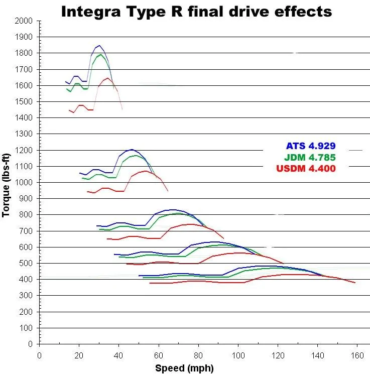

Generally you always shift at redline. In most performance cars, even at the peak of your powerband the next gear up will not be able to overcome the torque multiplication and over power the gear below it... Unless your torque falls off really steep.
This is a popular graph floating around the internet that demonstrates the torque multiplication for each gear with 3 different final drives in a Honda/Acura. Notice at no point in the recorded powerband does a higher gear overcome a gear below it. You can make a graph the same as this using your gear ratios and dyno graph and verify for your personal vehicle.
