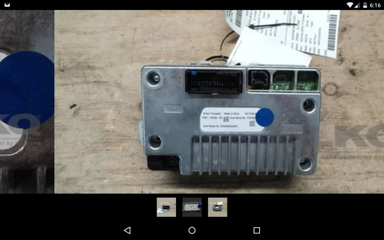

Look at a base system's sync module. That is where you will find the matching plugs

Yeah, just found that thanks. A little different plugs. Definitely going to need a wire schematic. Hunting one now.

Main sync connector should be the same no? :shrug:
The question is whether or not the base model sync connector is missing the wires that are routed to the 4.3" screen.

The back of the mustang is the same as escape. Same plugs etc.. Both wire schematics are the same also as to pin placement. Difference that I've seen is with amps or without. Still looking and tracing wires though. I'm starting to think if you got the screen with module its plug and play, leaving only a new bezel required. And I'm not sure the factory one can't be modified.

If it is only the bezel then I can fix that! I can make a bezel that will cover the top half that the screen can mount to. On the outside it will look just like the ebay bezel. You will have to cut your OEM plastic though... Circuit board should not need to be modified.

I have just compared the main sync harness connector on the sync module side. Both MFT sync and base model sync have the exact same connector module side. If there is a difference it will be on the harness side in the form of missing pins/wiring. For those that have the wiring harness diagrams, focus your attention on the sync connector.

Understood! Just posting my findings! The more and more this is shaping up it might actually be a plug and play install!
