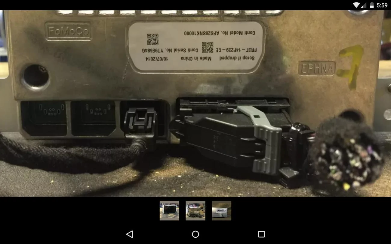

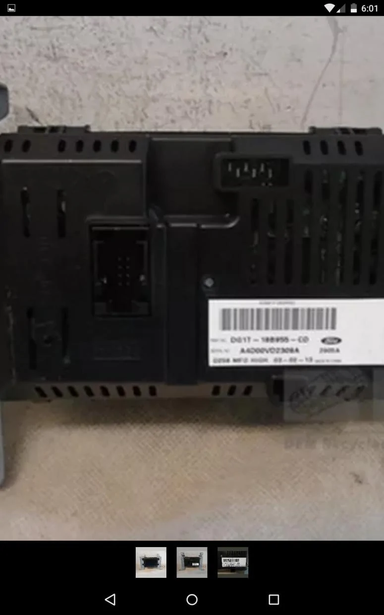

The screen is available from Rostra, as well as several china companies. Ford has it listed as discontinued. One site showed the ACM the same Ford number between base and preium and another showed different...no figure. Meant to call Ford today, got busy.
I didn't order one for a Focus, I'm installing one for someone. It's at the shop, but I'm not. Will look at it tomorrow hopefully.
From all my reading, and limited knowledge in this area-mind you, I believe your correct in saying the screen decodes the info....more or less...
The one I ordered I believe, pending it even shows up, will be a larger touch screen, with a GPS module attached. Everything else will use factory equipment, programing ect...
I did let Amazon know and fwd them the email about saying out of stock.

Difference between nav and reg 4.2 screen.
Question is, is the 4.2 missing the ACM? And that's what's behind the screen on the 8".
