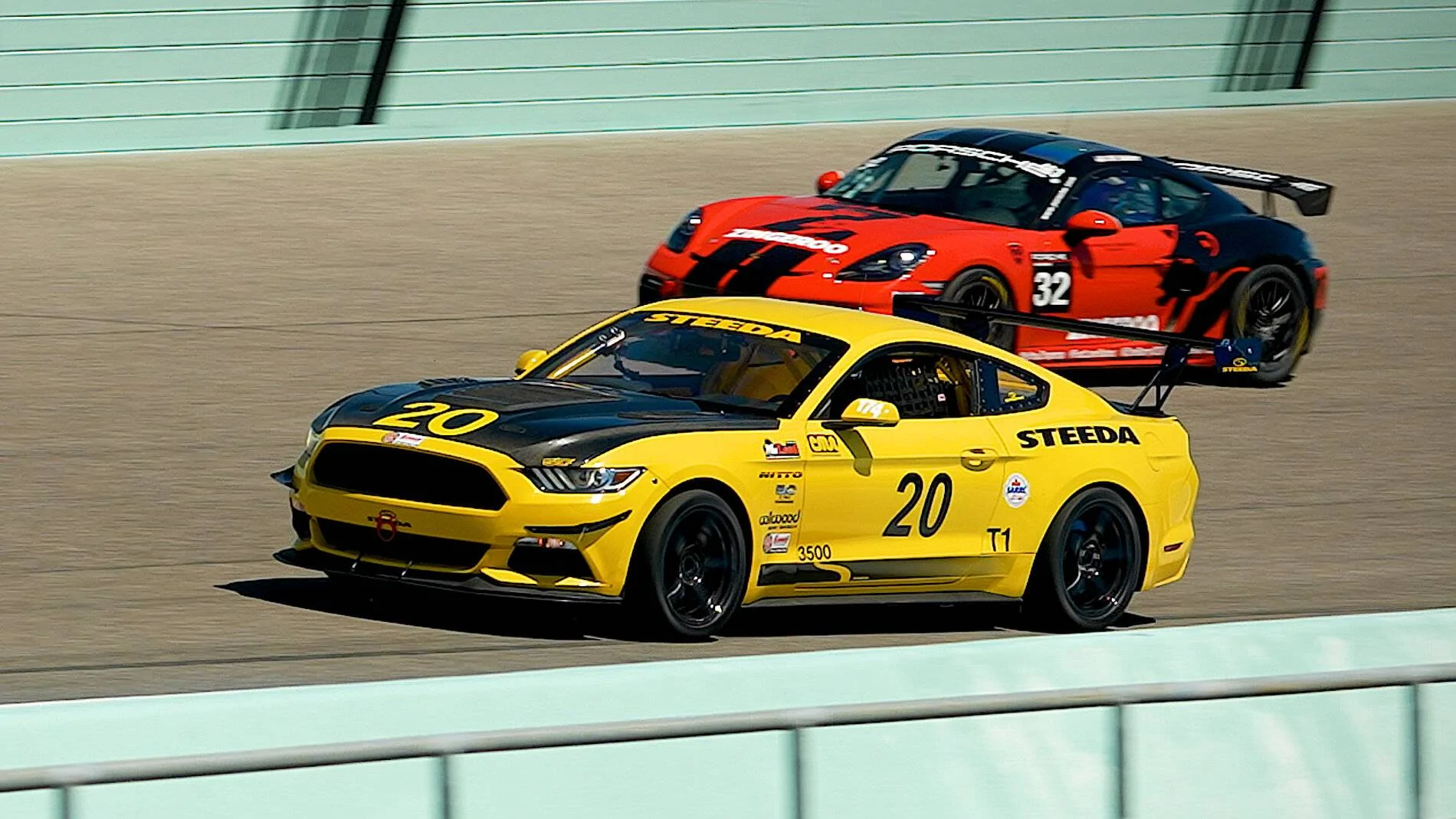

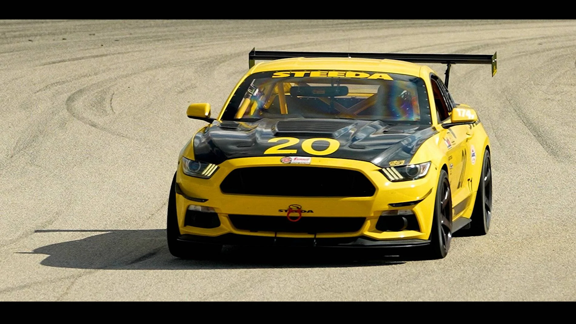

Going up against the super cars this Memorial day weekend at Homestead!
Our toughest competition, will be Porsche 718 Cayman GT4 Factory purpose built race cars!
This will be our first FARA event.

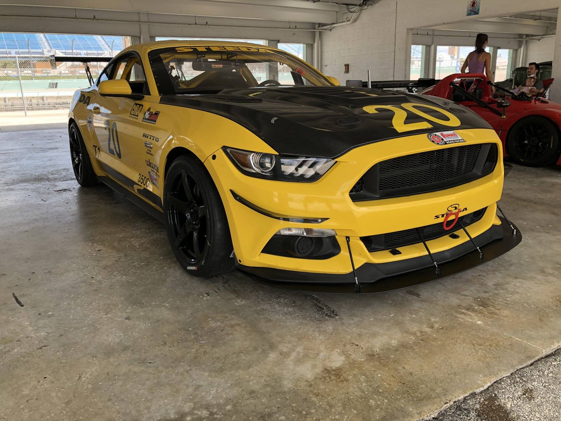

Motion Control are the dampers we run on the 20 car. We run anywhere from 300lb/in to 650lb/in
In front. Rear we run a coil-over spring in the production control arm location for durability, rates range from 1000lb/in to 1600lb/in. Spring rate determination is track conditions, tire compound, tire sidewall stiffness, aerodynamic downforce, etc. On another note, currently our HPDE car runs our Steeda Pro-Action coil over adjustables on the front, with the adjustables in the rear with the coil over spring in the rear. We should have a advanced HPDE kit available this fall. Spring changes with the new kit will take under one hour on all four corners. The ride height is fully adjustable. The 20 car is fully instrumented with a data acquisition system. What we learn from racing and track events we put into our products. Our customers and enthusiasts are number one at Steeda!

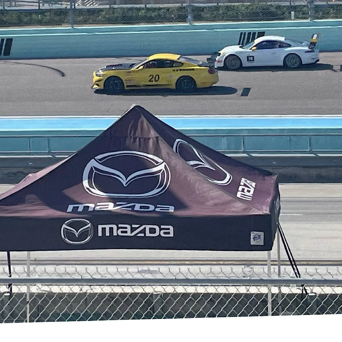

Getting ready for Qualifying!
SteedaTech
Aug 8, 2016
71
2,079
1,624
Pompano Beach, FL
2016 Mustang Q750
Qualified 2nd on the grid. Led the 30 min race until the end and finished 2nd . Fuel surge tank failure ran out of fuel last lap. That’s racing! Proud to see a production Mustang right out of the showroom floor with mods you can afford, compete with purpose built GT4 Cayman Porsche costing four times as much!
