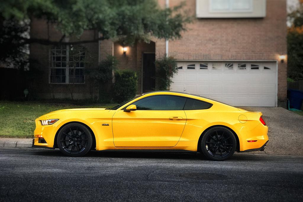

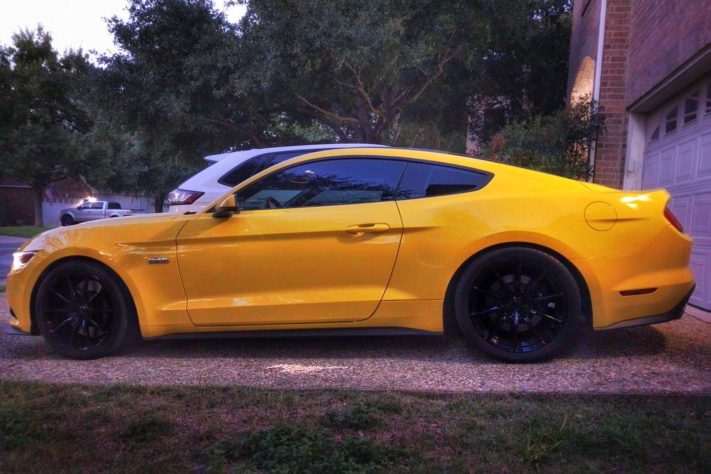

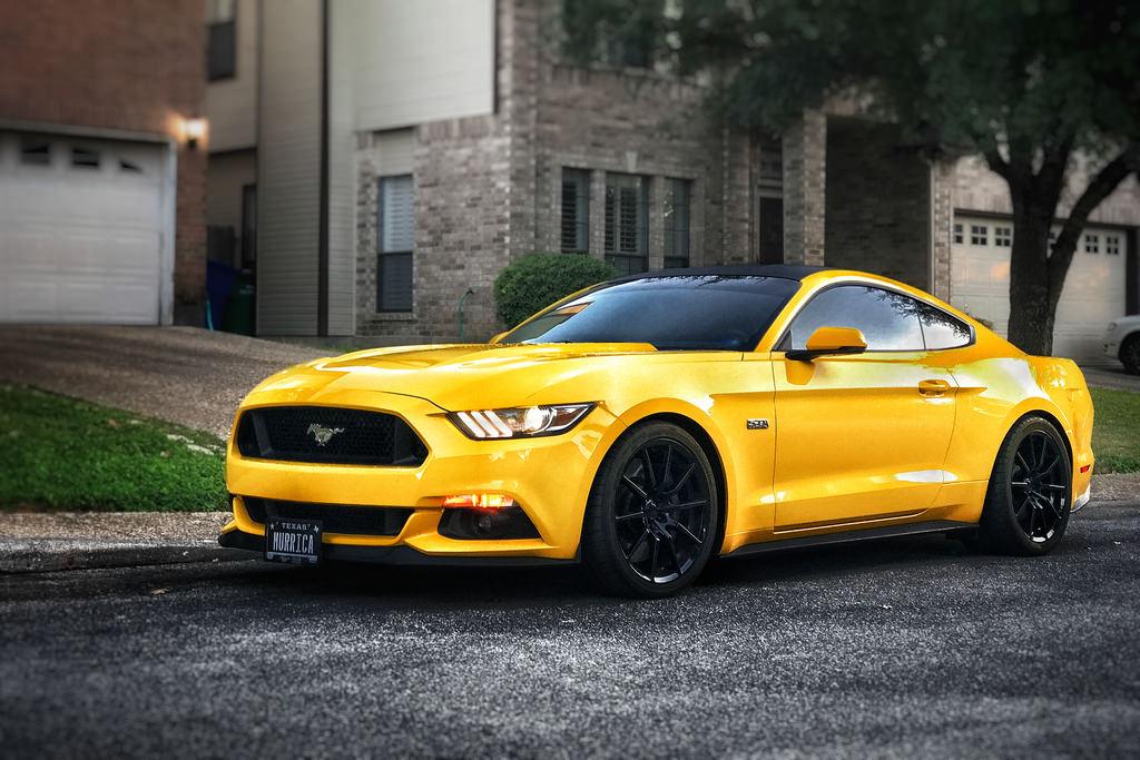

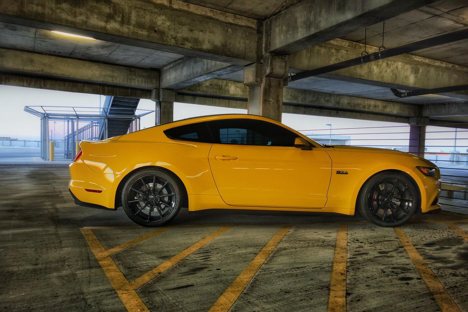

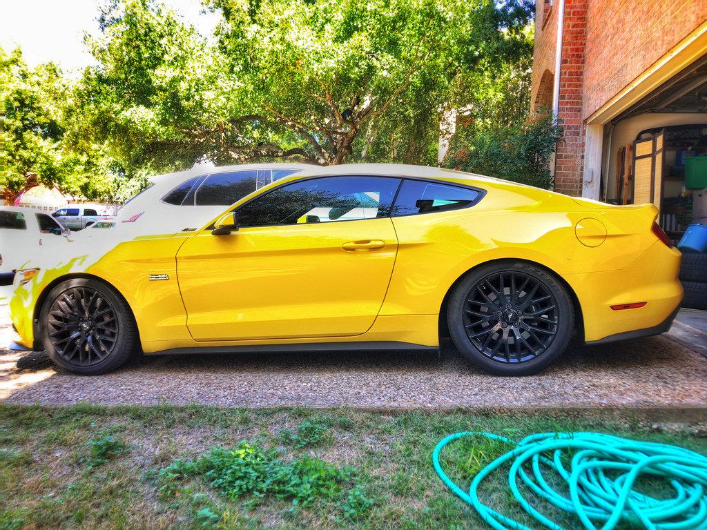

I love this Steeda 3/8" spacer. Super easy to install, and great craftsmanship of the part. My findings are as follows:
[Steeda 3/8" spacer results]
Measurement : PP / M350 / M350+3/8" spacer
Front PP Splitter: 5.5" / 5.125" / 4.875"
Fender Arch: 27" / 26.75" / 26.625"
Quarter Arch: 27.125" / 26.5" / 27"
Jacking Rail front: 3.625" / 3.25" / 3.375"
Jacking Rail rear: 3.875" / 3.5" / 3.625"
PP = 255/40/19, 275/40/19
M350 = 295/30/19, 325/30/19

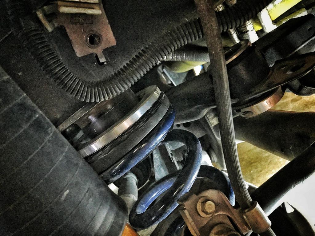

9.5mm spacer above rear spring lowered front splitter 6.35mm, and raised the rear 12.7mm
This is the spacer. I installed it above the pad isolator. Super easy because the Ultralites are short.
PP wheels and Ultralites

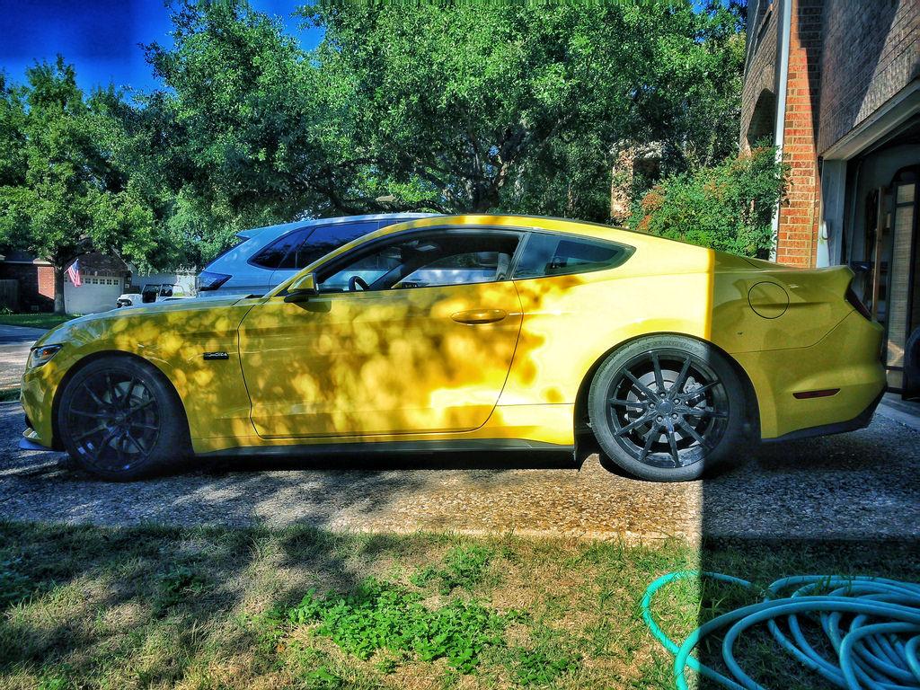

M350 wheels and Ultralites

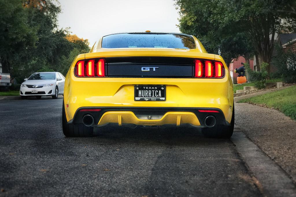

M350 wheels and Ultralites AND 3/8" spacer

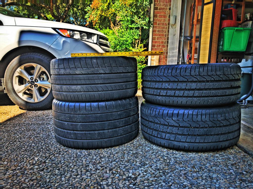

And quick comparison shot between stock tire sizes and 325/295 tires.
Money well spent.
Slightly better lit. Excuse the iPhones 7 Plus pictures.
:cheers:

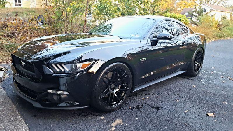

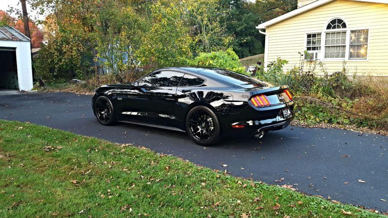

Going to put a set of rear PP wheels on the front for now and run a square 275 setup. It should fill the rest of the tiny bit of front gap I have. Very very happy with the look, ride, quality, and handling already. This is with 1" spacers and these are updated ultralites. Also I did the cradle lockouts and attempted to do the differential solid bushings. Royally failed due to an oversight/assumption on my car. Working with Steeda to get it corrected. :thumbsup:
