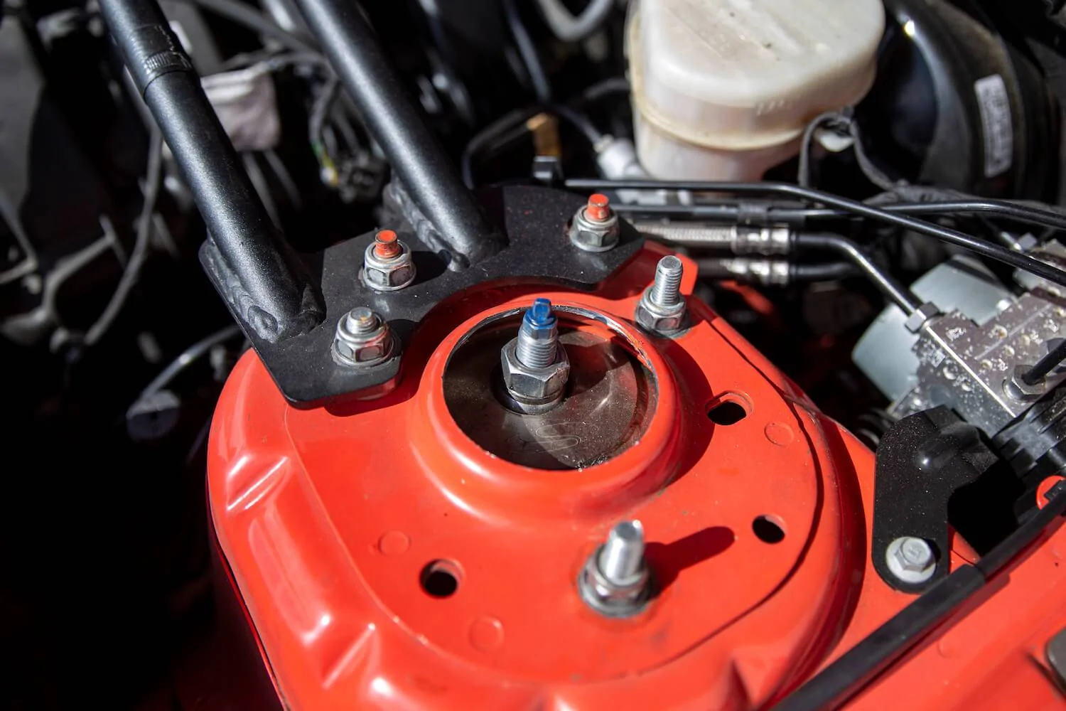

Timothy
A nice sized hole for adjustment at the track!
SteedaTech
Aug 8, 2016
71
2,079
1,624
Pompano Beach, FL
2016 Mustang Q750
Just simply use masking or blue tape around the bearing and the surrounding area. When finished vacuum debris out if necessary.
Your good to go.
