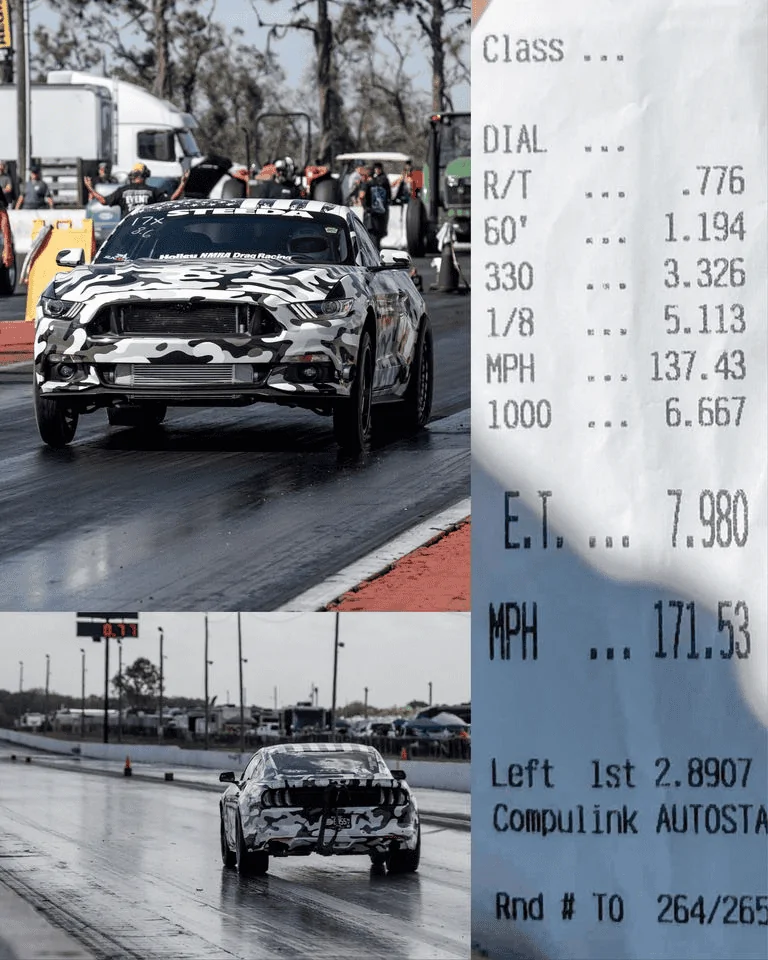

Add another impressive run to the list:
A huge congrats to Matt Ballard and his incredibly impressive turbo #S550 for hitting 7s in the 1/4 mile! 7.98 @ 171 to be exact! Check out that 1.19 60' on #Steeda suspension, too! Keep up the great work, Matt!

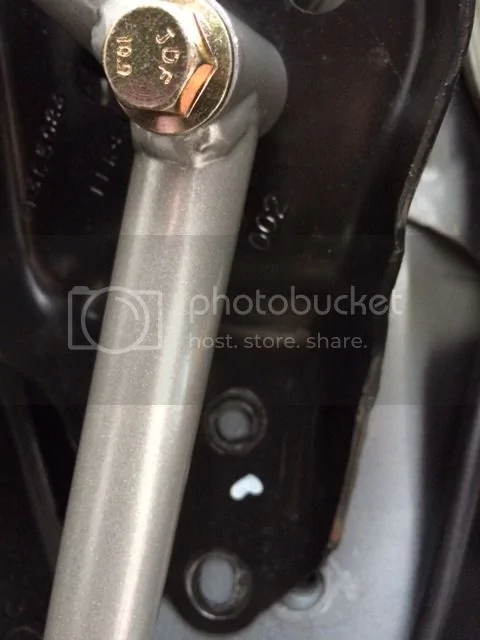

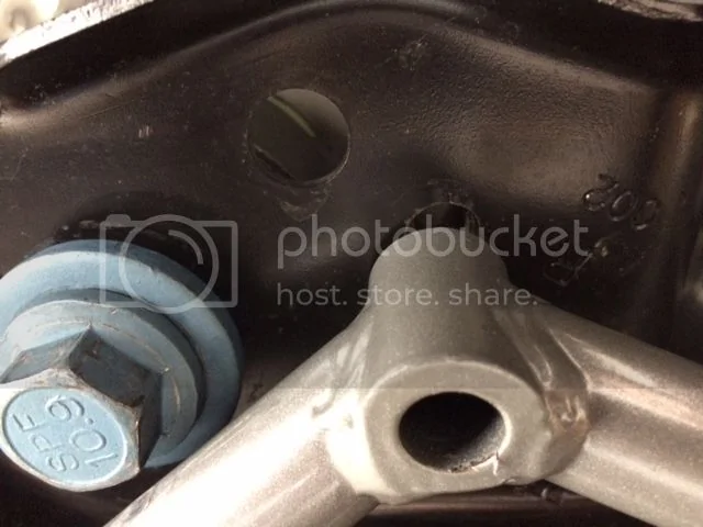

I'm in the process of installing these, along with several other Steeda items, and I got a bit "stuck" on the passenger side install. Like you, I got the driver side installed no problem, but the passenger side is fighting me on that last center-bolt.
I loosened up the front subframe bolts and still no luck in getting this thing aligned with the bolt-hole.
Anyone that have had this issue end have any tips for getting this thing to move/align? The only thing I haven't tried yet is to loosen up the rear subframe on the passenger side to see if that gives it a bit more freedom to move, or possibly pulling the subframe alignment stuff on the passenger side (grasping at straws) to see if that gives it enough room to move.
I've emailed Steeda but thought maybe someone here that's been through this would have an idea that gets me rolling today before I hear back from Steeda.
A few pics of the situation - first the way things line-up:
And here's what it looks like if I pulled the 2x13mm bolts from the front of the subframe and connect the center-bolt:
Mine was like that. I had to make sure everything bolt on the bracket was loose and it was till a fight to get it in. I also used washers to make up the space. I fount the bolt was a little short. Ended up installing my own socket head cap screw in that location.

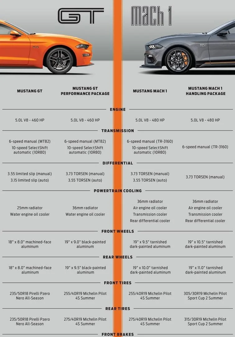

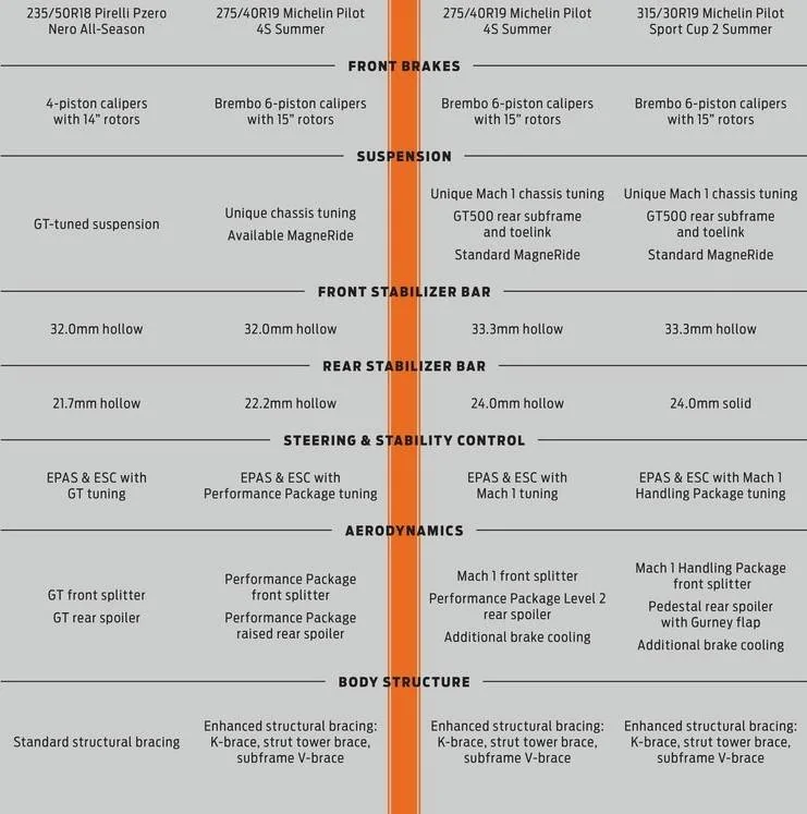

I attached the comparison chart, GT500 Subframe and toe links.
So I guess I still don't understand where I would feel this extra stiffness that would be worth adding weight to the Mach 1. From a dig or around a corner?
I mean... it's a brace, it adds stiffness to the chassis, which would improve overall feel and handling in all scenarios. Now, whether you notice it or not is an open question. What problem are you looking to solve? Don't just throw random parts at your car for no reason, or don't listen to me and do it anyways, it's your choice )))
I will be adding these braces along with diff bushing insert kit and subframe bushing supports, maybe also subframe alignment kit while I'm there (I have GT with magride). I kinda have a good idea why I'm doing this - I want to address rear end wobbliness in specific performance applications, and prevent diff bushings from failing prematurely. I couldn't care less about wheel hop despite it being supercharged, and I don't think I would worry about all that stuff for street use scenarios. So, my point is - think about why you think you might need it in first place and go from there.
