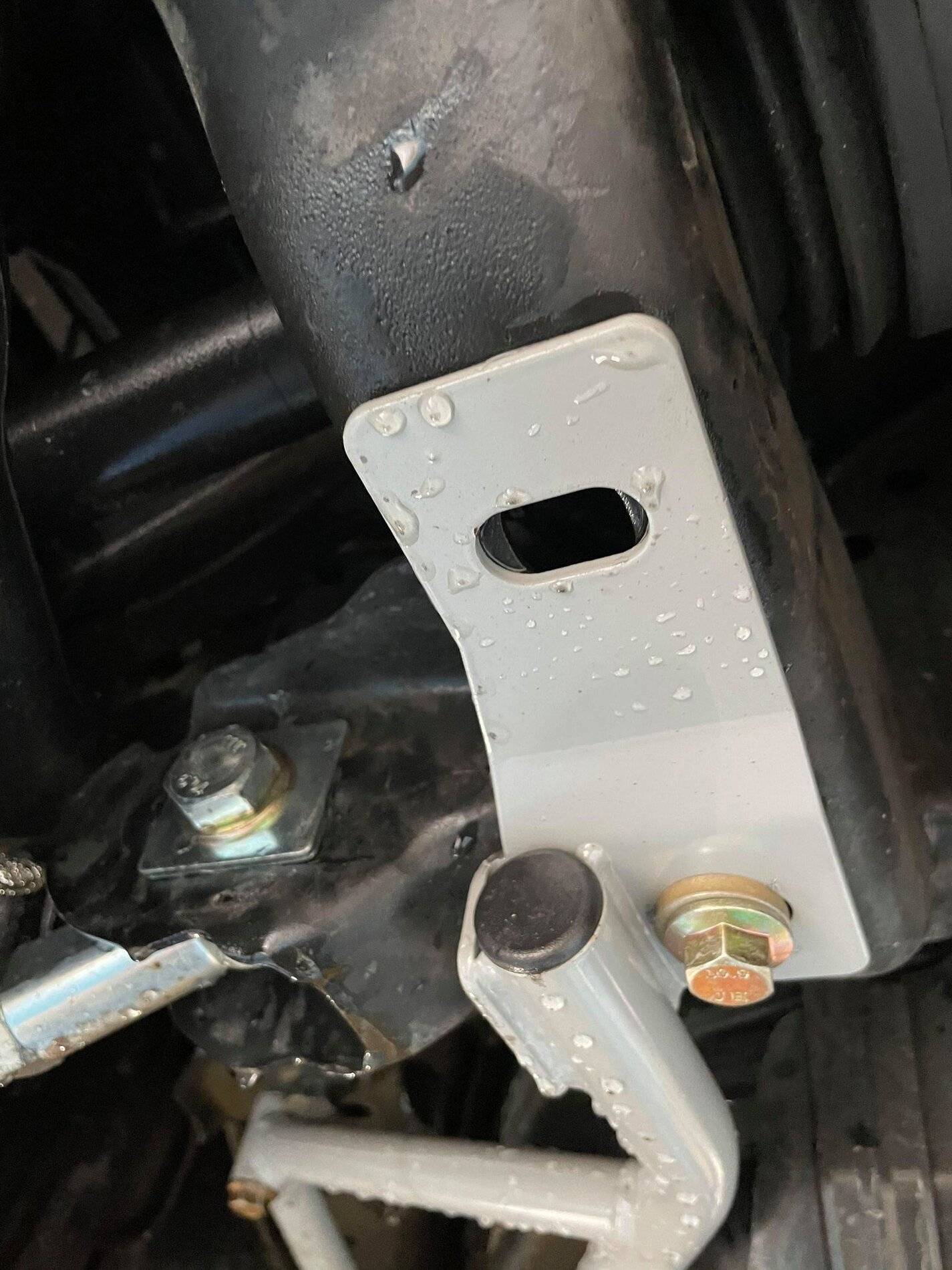

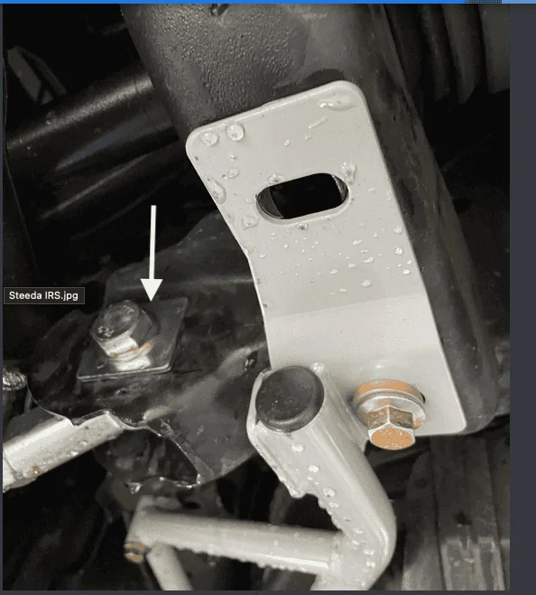

Hi Guys,
I have the Steeda subframe support braces recently fitted. I noted that the kit seems to have 2 missing bolts: (one on each side)
The shop who did the install have said the install pack does not have the bolts which are missing here. Should there be bolts to fix this here? Anyone from Steeda here able to advise if having this double bolted here is necessary? Or any issues if driving the car with these bolts missing?

Call Steeda and ask them to ship you the hardware or go to a Fastenal store and buy it yourself. Make sure the bolt and nut are grade 5.

Are there even threads in the body there for a bolt to mate with? That looks different that my car..

There is a large washer that goes under the head of the bolt and a nut that goes on top (installed from the top of the subframe).

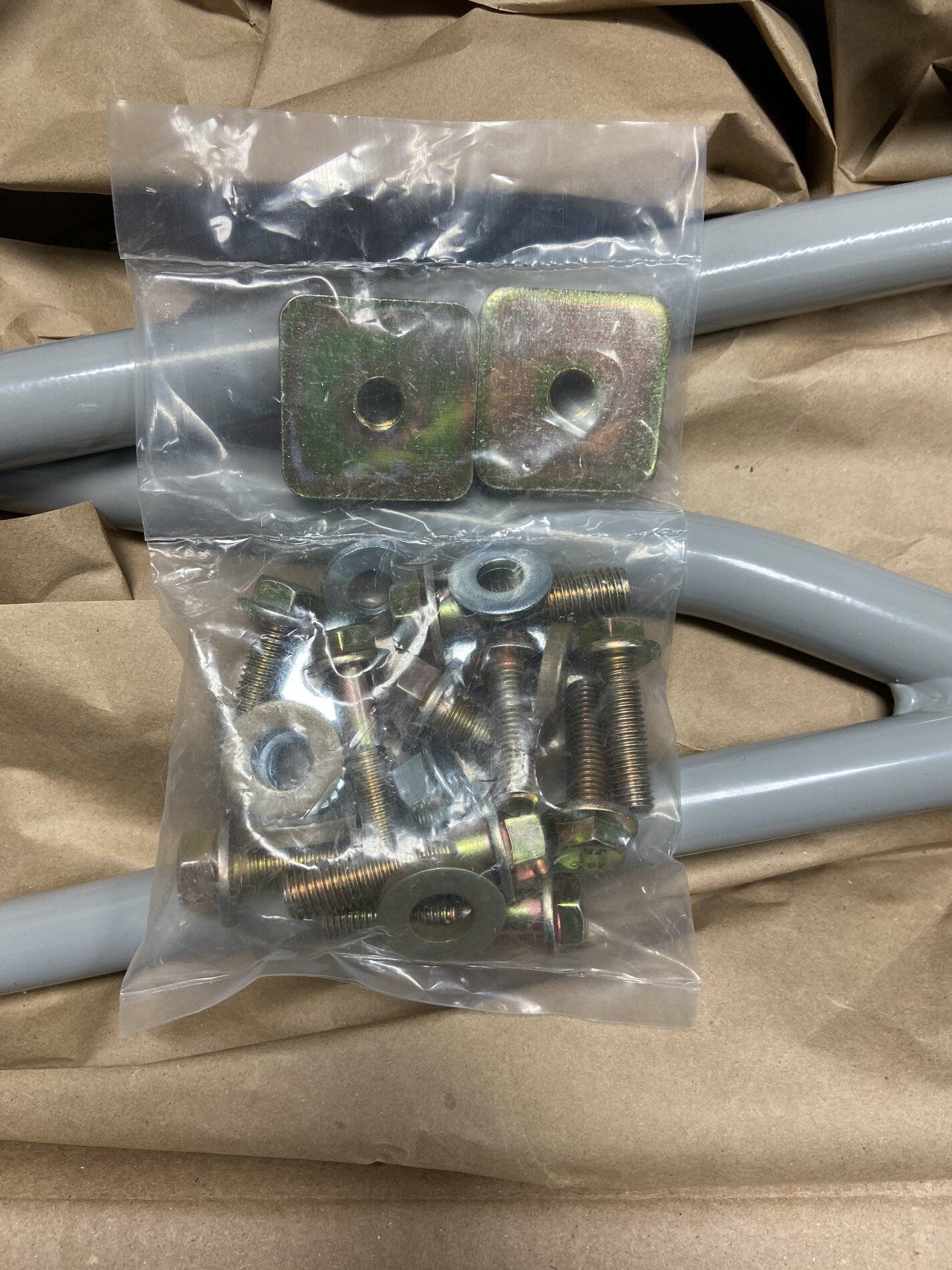

It just might not be Steeda's fault the blister pack is pretty standard.
What do you think the chances would be that the shop blew it?
Pretty good I'm betting... V
After all if they were worth a shit. They could have sprung for a nut and bolt ? It's not rocket science?
That's a shit shop and workmenship.
Perfect example & reason, do my own. These so called mechanics, lack simple common sense.
So pathetic

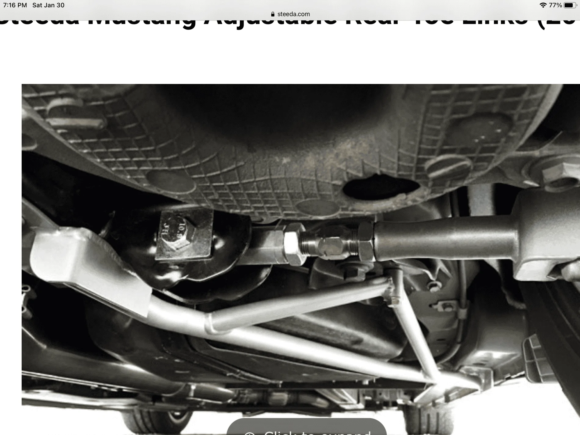

OP they install this also ? LMAO part of Steeda's missing hardware?

My blister pack also contained everything just as it it depicted in your photo Rapid Red. I am wondering if the hardware may have been misplaced during install, or simply omitted because of the slight amount of difficulty required to install those rearward bolts and nuts.

OP, I would just go to your local hardware store and pick up the bolts, nuts and washers and finish up the install correctly. Here is what you want taken from Steeda’s instructions.
9. Place the other 12mm x 45mm (longer) flanged hex head bolt and oversized washer, through the rear bracket of the sub frame brace, through the sub frame, and secure with the provided 12mm nut. See Figure 4. Note: If at this point, everything is not lining up correctly, the two 13mm hex head bolts on the front rear sub frame support brackets, and the main sub frame bolt may need to be loosened up, so that the sub frame support bracket can be repositioned slightly
So has this been mis fitted too? (Sorry, I am the least mechanically minded!)

Aha! Thanks mate!
Its going back in again on Wednesday to get the added bolt into the IRS - I will ask the fitters about that too!
