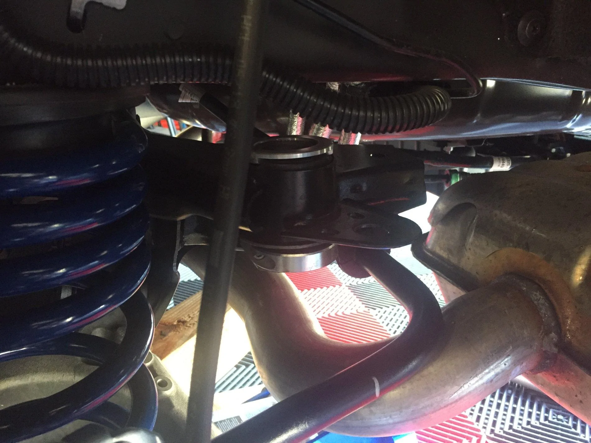

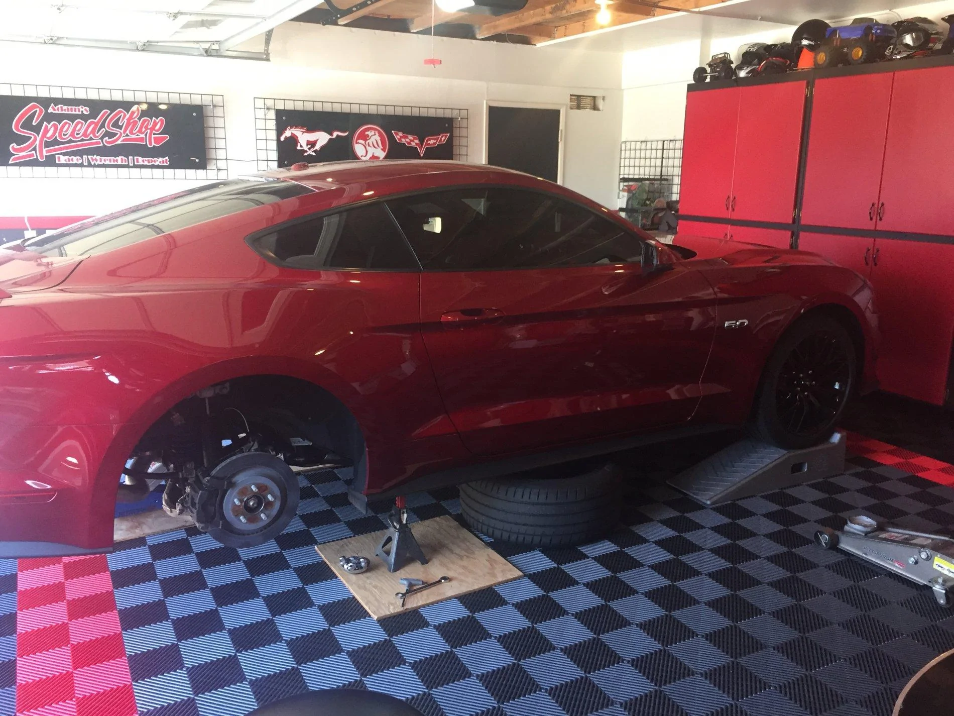

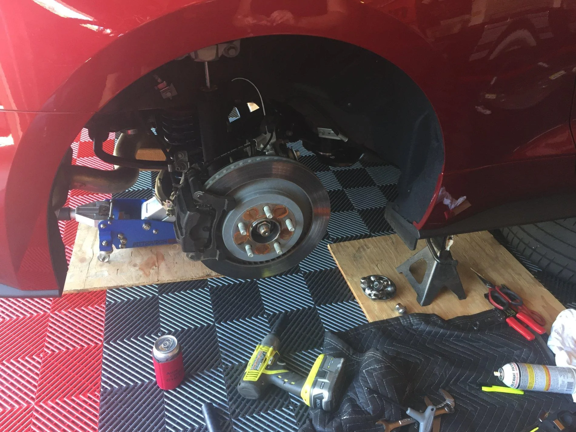

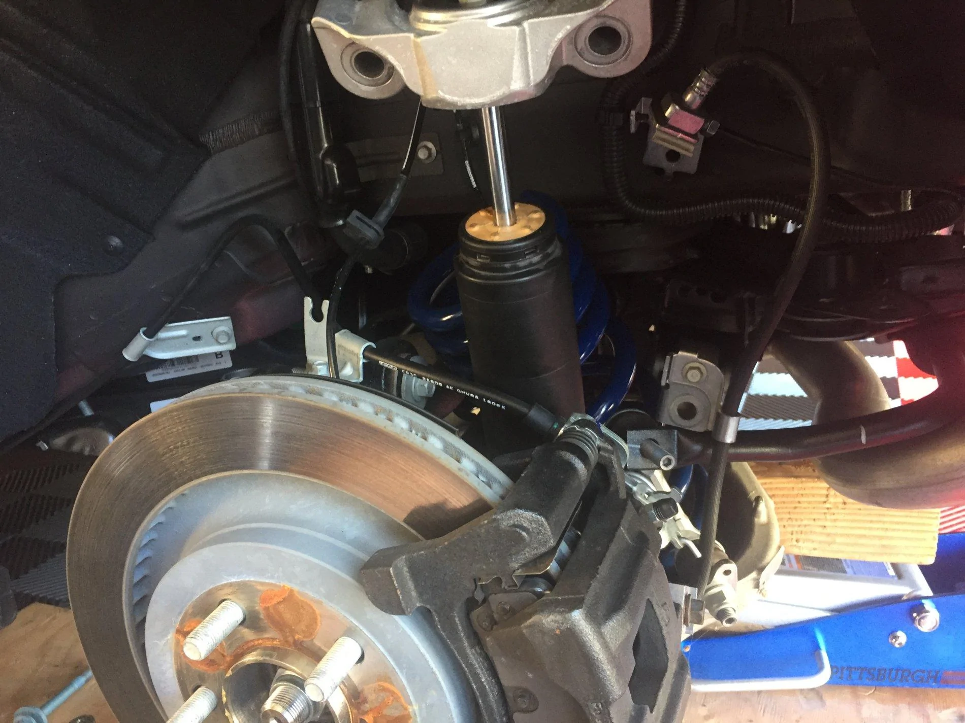

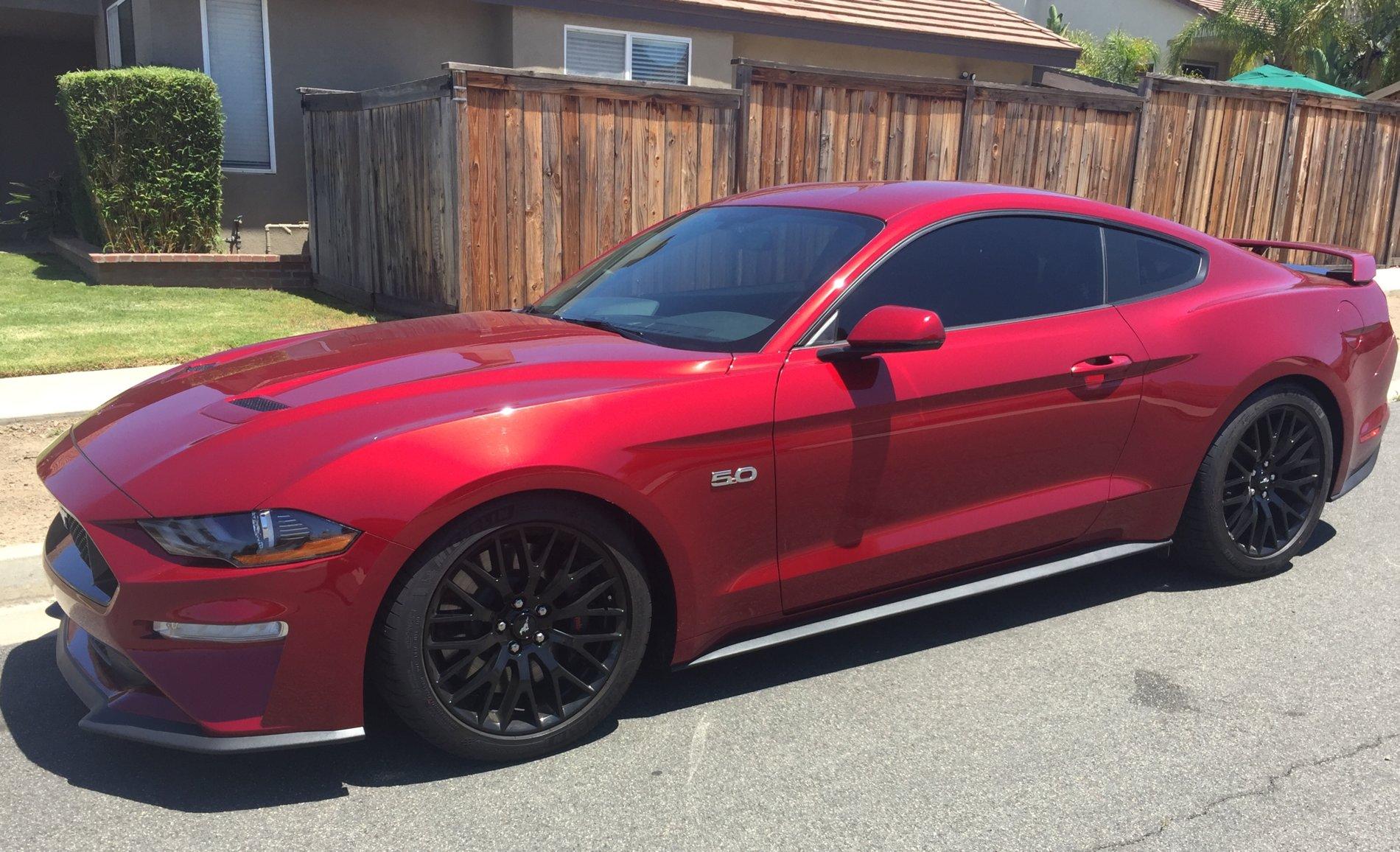

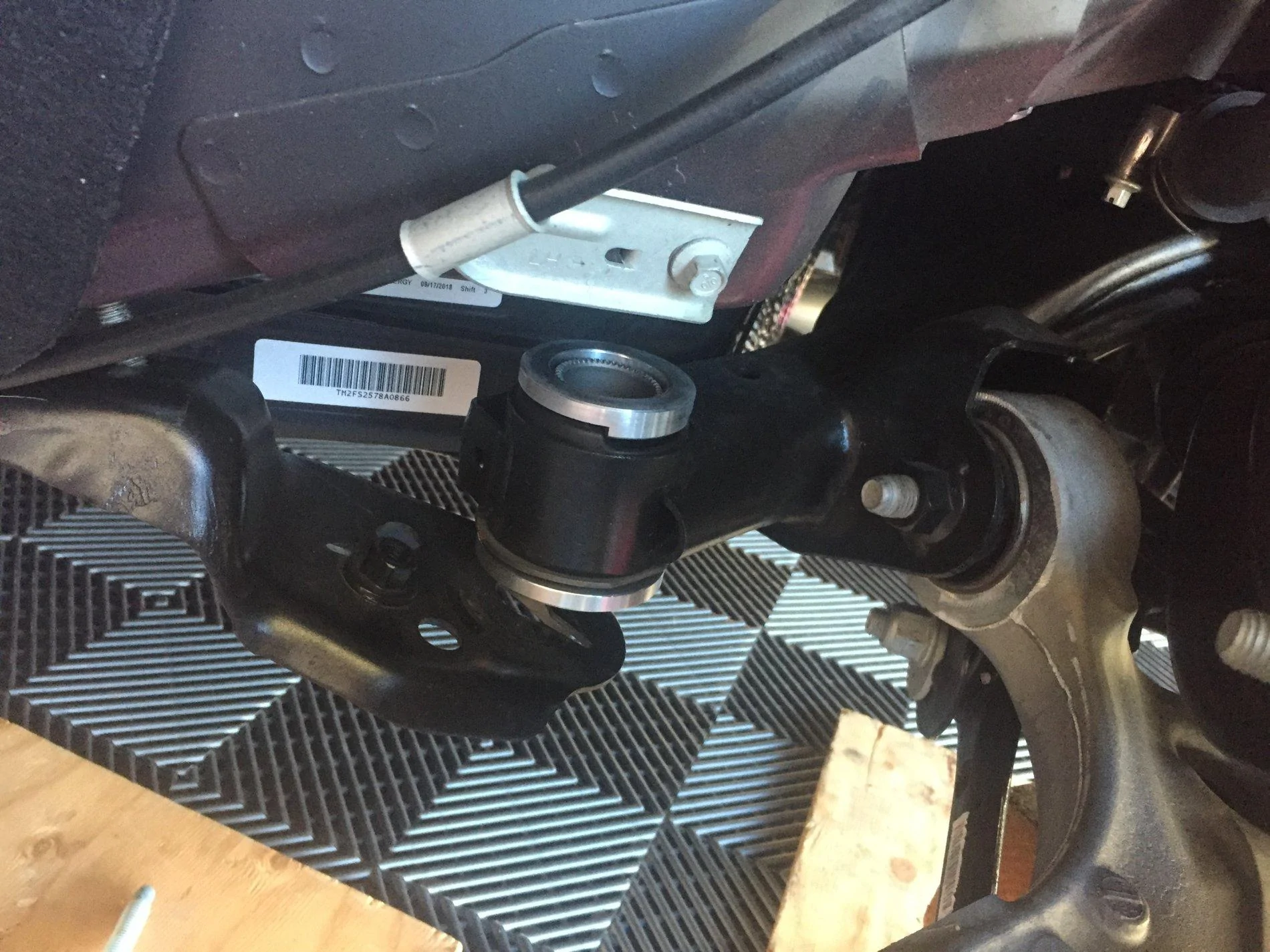

Got the new progressive and Stop the hop kit installed. Getting the factory rear springs out sucked.Online videos make it look easy but I think the rear subframe was binding on the factory exhaust.Most of the other installs have active exhaust or aftermarket so perhaps thats what makes it easier.
...lol
Car went quite a bit lower in the front than I was expecting I'm hoping it doesn't rub when I get my Forgestars back from powder coat and go 275/40/19 squared. :D
Based on searches it seems some are low and others aren't?

Should not rub at all.
