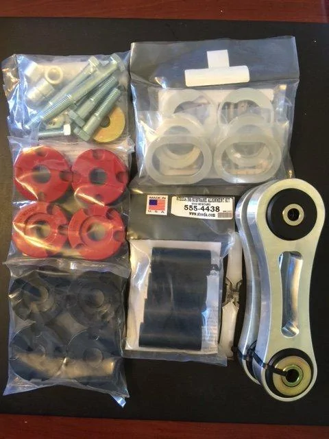

Awww Yeaahhh! FedEx just dropped off some goodies. Time to go play with the air tools! Thanks David@Steeda for getting these out so quick! Looks like the rest of the parts will be shipping some time in the next week. That way I get to spread the fun out a little.
Steeda Billet Aluminum Vertical Links
Steeda S550 Mustang Adjustable Differential Bushing Insert System - Urethane (2015 All)
Steeda S550 Mustang IRS Subframe Bushing Support System
Steeda Mustang IRS Subframe Alignment Kit

Congratulations!! I have everything but the new urethane bushings, looking forward to,your feedback :cheers:

Thanks Todd! I spent quite a while working on it yesterday, interrupted by lunch, trimming the bushes, dinner and a family party in the evening. The only thing I have left to install is the vertical links so it's still jacked up. I'm really glad the Differential bushings, bushing supports and subframe alignment kit came at the same time. Doing them all together eliminated a lot of repeat work. I'm really looking forward to getting the vertical links on and test driving (flogging).

LOL don't you know it! I always forget how fun it is working on suspension until I get started. All in all it really wasn't bad. Not nearly as easy as the video but not bad. I just finished the vertical links, going out shortly to test it all out. :headbang:

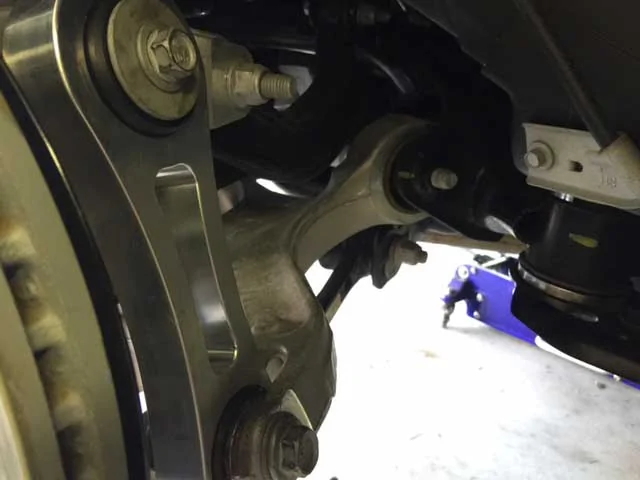

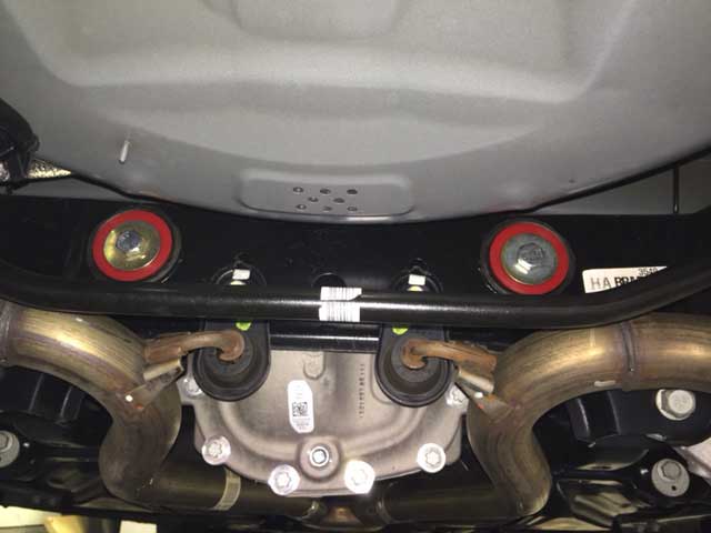

Went for a nice ride to check it out. I did a burnout and a hard take-off and it was very solid, no hopping. The most important thing was cornering for me. I went into a large parking lot, took a hard turn accelerating out of the exit purposefully braking the backend loose. Before, with the wheel hop, it was hard to control. It took a lot of working the wheel. Now it is easy!
Thanks again David@Steeda for the recommendation!
You can see the Steeda urethane differential mount bushings in the first pic and the Steeda billet vertical link (left) and the Steeda sub frame bushing supports (right) in the second picture. You obviously can't see the Steeda sub frame alignment kit but I'm really glad I got those. I'm sure I would have had to get it aligned afterwards with everything moving around. I'll still get it aligned once I get the lowering springs in.
