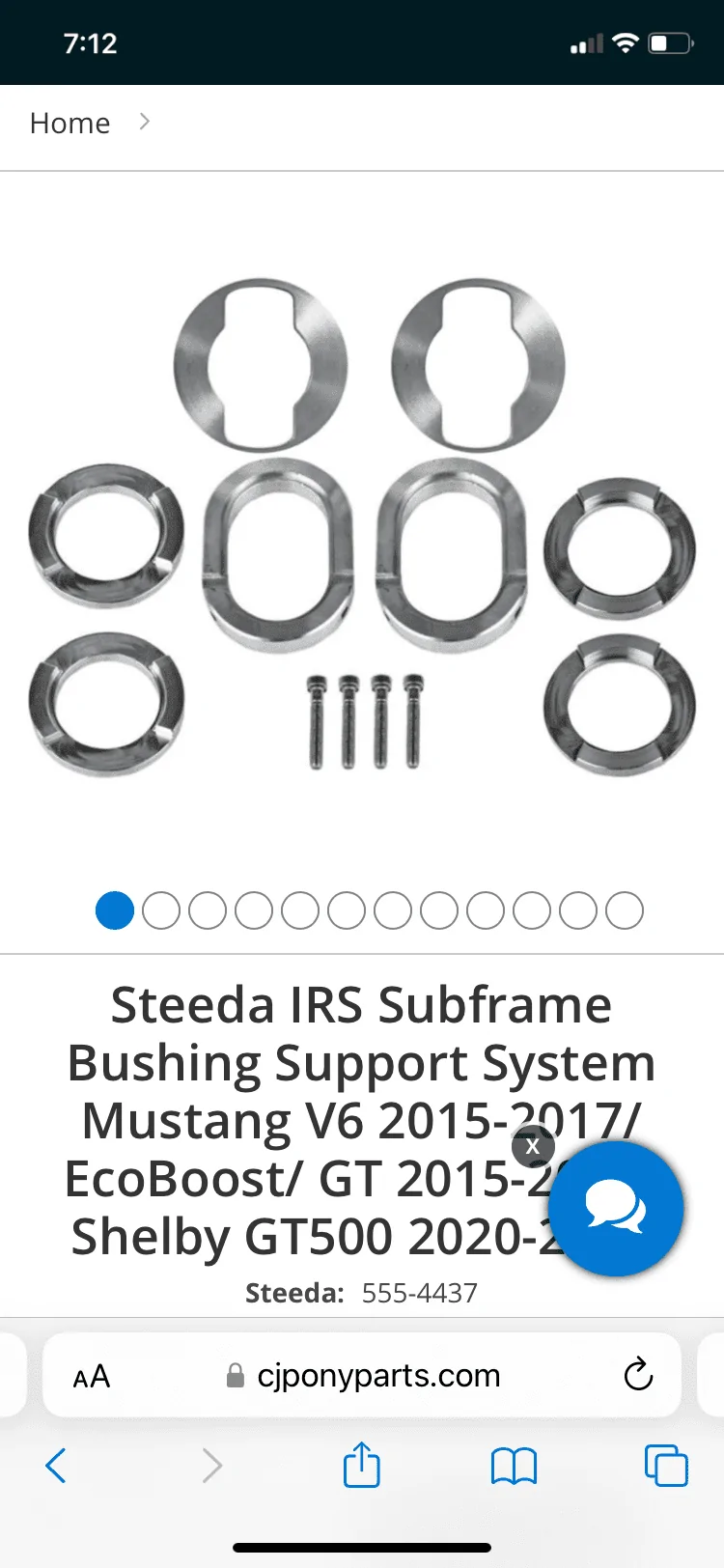

Question for you. I am thinking of doing a very similar suspension package. But also thinking about “stop the hop kit”.
I’m trying to think which to do first. Any thoughts on which would be better to do first? Is stop hop the kit something you will consider in the future?
there are tiers to STH kit. At the very least you want the alignment dowels and IRS bushing lockouts. Steeda, BMR, and WHiteline all have solutions. Whiteline has the softest and easiest to install, IMO. And it is sufficient. BMR/Steeda are considerably more money but are also adding bracing to various extents.
For cheapest possible solution that does enough for most people: Whiteline bushing inserts + Steeda or BMR alignment dowels + Steeda IRS brace.
If you don't address the hinge in the chassis that Ford politely calls the IRS, your suspension improvements will be suboptimal. Even the "fancy" magneride benefits significantly once you fix the IRS even with zilch other changes.

@shogun32 Im surprised you recommend the big braces over these bushing limiters. They certainly do something good and also do nothing bad for NVH that I have noticed.
shogun32
Feb 8, 2019
92
16,223
14,019
Northern VA
Only because they are pain to install vs others. I had them on my gt before I want to full bushing replacement. And I even have another new kit I forgot I even had...

Steedas IRS braces add zero NVH and tie the rear of the car to the front. If I could only have one mod it would be the IRS braces.
Like others have said there are tiers to the stop the hop kit. With that said, that kit is geared towards maximizing rear-end traction, not necessarily overall handling/balance.
I would say that the first tier STH kit is a good starting point to build from. You’re most likely going to want those parts regardless of what else you decide to do in the future. I have the subframe alignment kit and bushing support. Plus the vert already has some underbody brace. Meaning I have to some degree the first tier kit already. I don’t plan on doing the second tier STH kit because the car is very well mannered at the moment.
From the tier 1 kit you can decide if you want to build the suspension for hard launches and pick up the second tier items, or do a street/handling build. What you add after the tier 1 kit will depend on your goals for the car.
