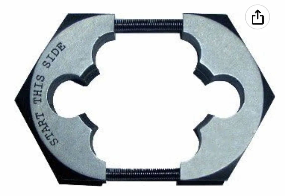

OP, any resolution? I did mine myself (J&M), and the tech folks there helped me resolve the threading issue. I think it's an M1.5x10 nut, thread it on and off a dozen times, good to go.
Had I known of the issue, I would have gotten my own brakes done in maybe 2 hours. Sorry you got to deal with this, but it sounds like an install issue.
