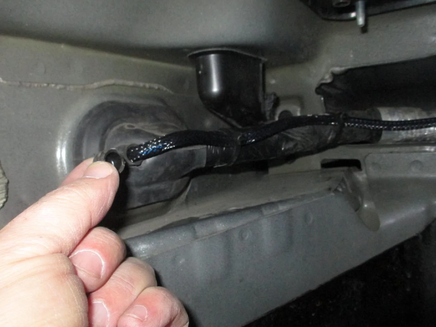

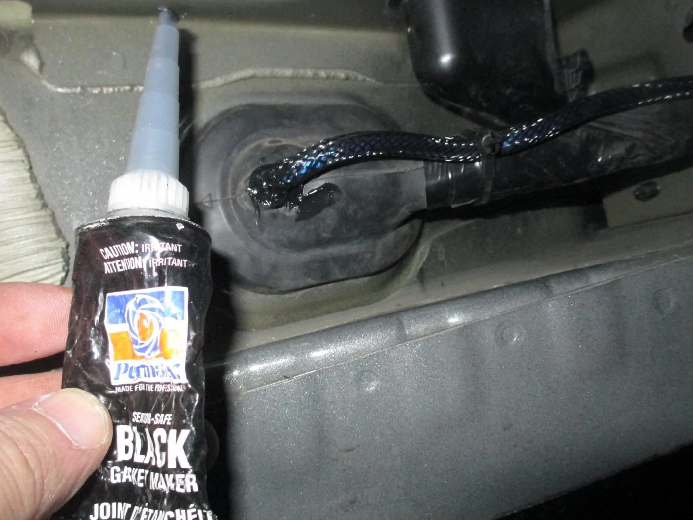

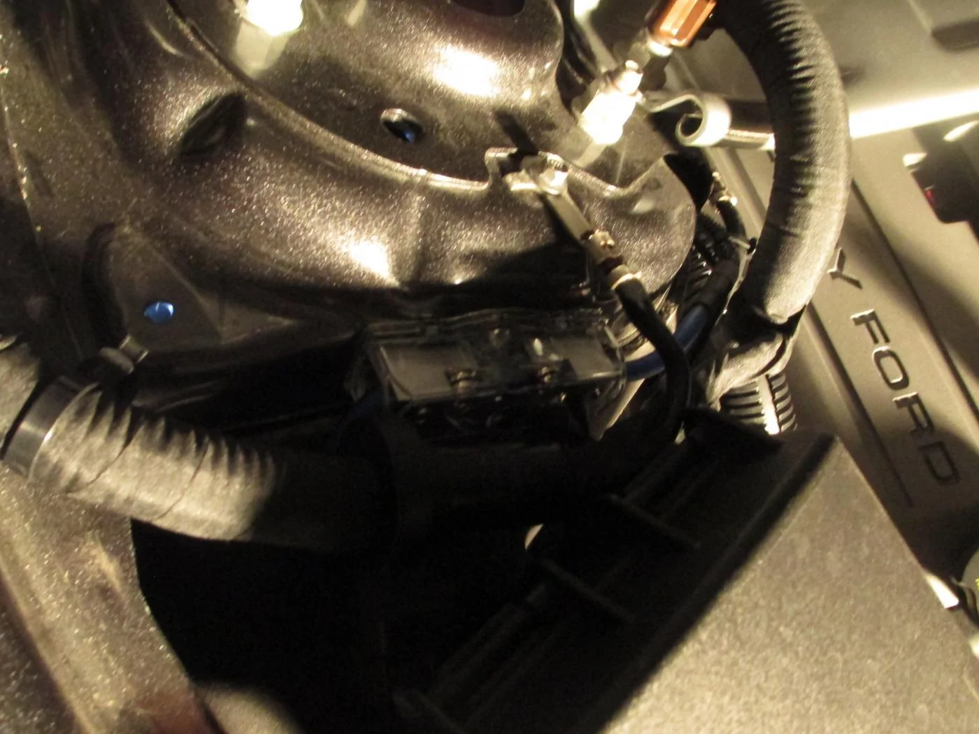

First was the amp wire, I mounted the fuse on the strut tower and got the power from one of the 3 positive terminals in the engine fuse panel. I ran the wire through the factory grommet inside the wheel well. The cool thing is there is a little nub there and if you cut if off it pretty much is a perfect fit and direct access into the car. I used some silicone to seal it after.

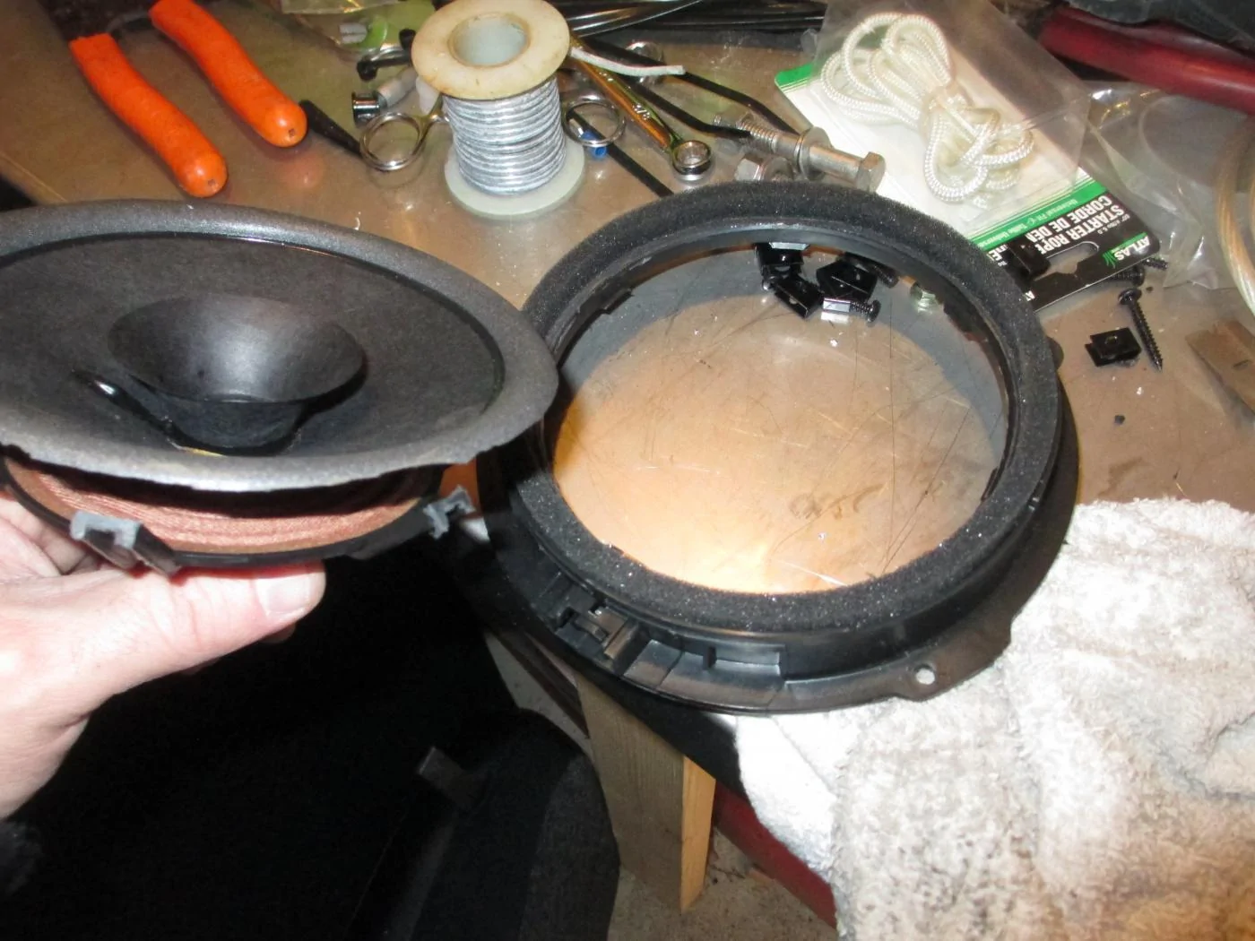

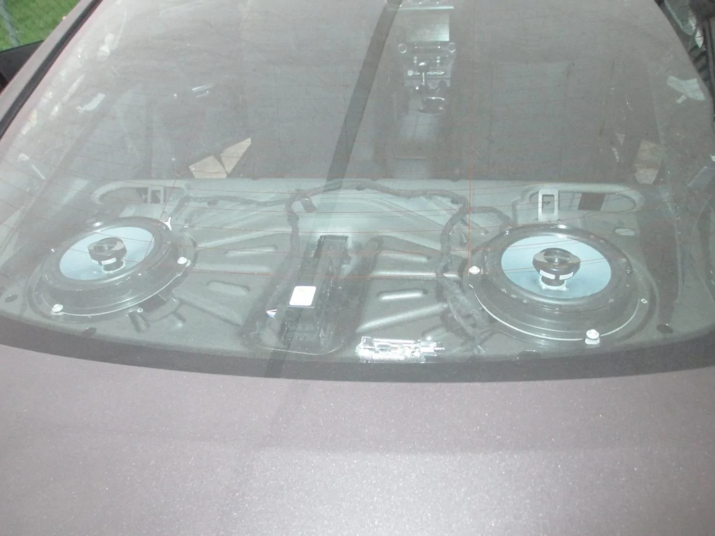

I removed the interior in the back and installed a couple of JL audio 6.5 speakers in the back deck. Like others have done, I cut up the factory speakers and used them as an adapter for the speakers.

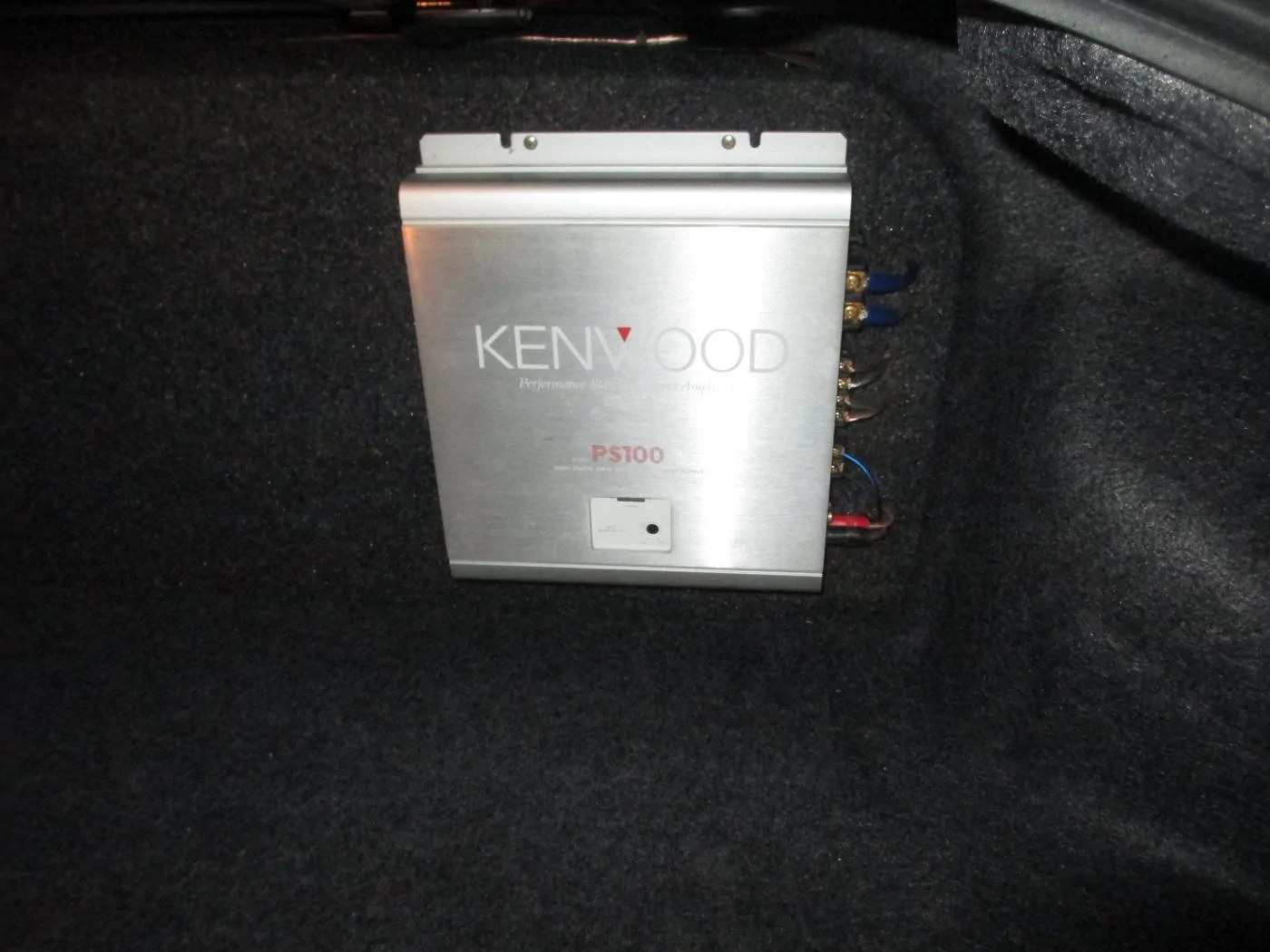

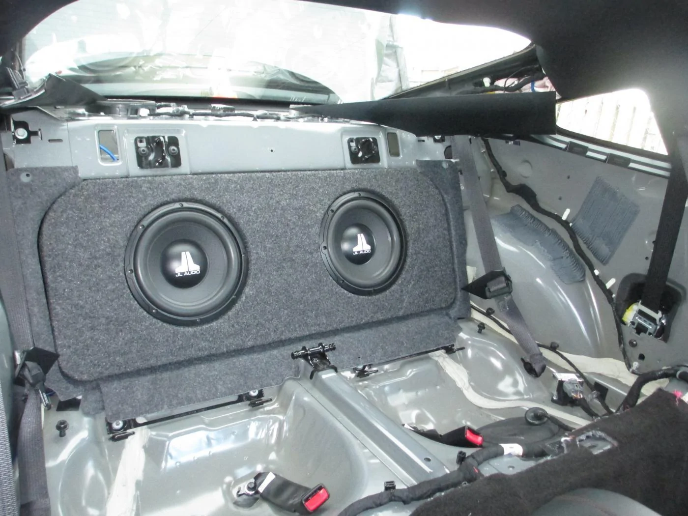

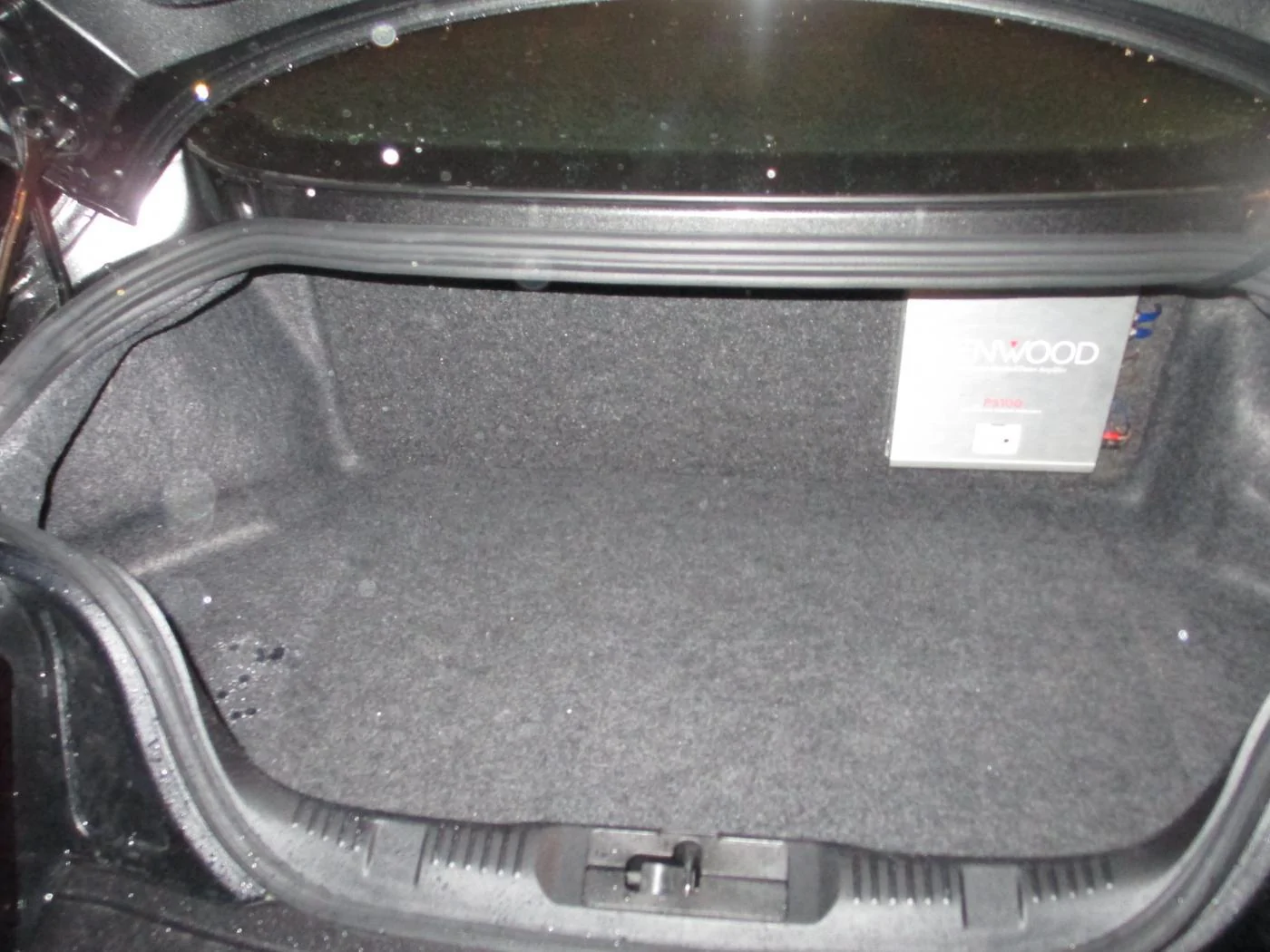

Then to the amp. I had an older Kenwood from years past in perfect condition so I mounted it to the box and ran the wires in the void space on the edge of the box for a clean look. The 10" JL subs were installed as well. Lastly, I mounted the box temporarily with a couple of aluminum pieces to secure it in place. I wanted to paint them black but the weather is the shits here so bare aluminum for now.
Pretty happy with it so far. This Summer I plan on upgrading the front speakers. Ready for the road trip now.

So are you just pushing the new rears with an amp?

Very clean looking, what sub box is that again? Did you have to remove the lower seat and quarter sides?
Looks like the box from Zenclosures, there's a pretty popular thread floating around the cosmetic customization section for them. About $120 of I'm not mistaken, fit pretty well from what most people are saying. They have single with amp mount and dual, front or rear facing.

Do you have alot of bass with that box?
