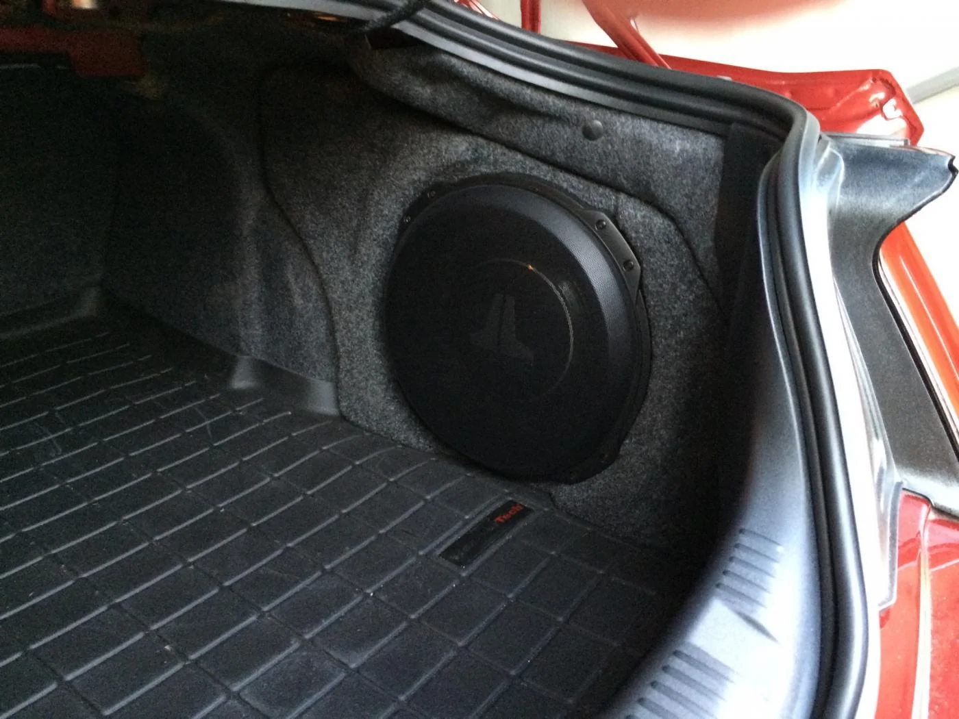

I was in the same situation as you with the 9 speaker system. I put a 12 inch JL Audio Stealthbox sub in the trunk and a 600 watt sub amp under the drivers seat. It makes all the other factory speakers sound good plus pounds hard with the base. I personally don't need to upgrade the rest of it.

Does the amp that you installed run to the sub as well as the factory speakers? If so, how did you go about bypassing the factory amp? In my previous car (Accord), I tapped into the wires before the factory amp and ran that feed into an Audio Control EQS then to an amp. I just need to find the best way to upgrade the audio because this 9 speaker system is weak! Thanks for any advice that you can provide.
The amp is a sub amp and just powers the sub in the trunk. They connected the sound from the rear deck speakers under the rear window. The amp is powered with a direct wire to battery terminal Under the main fuse box in the engine bay.
