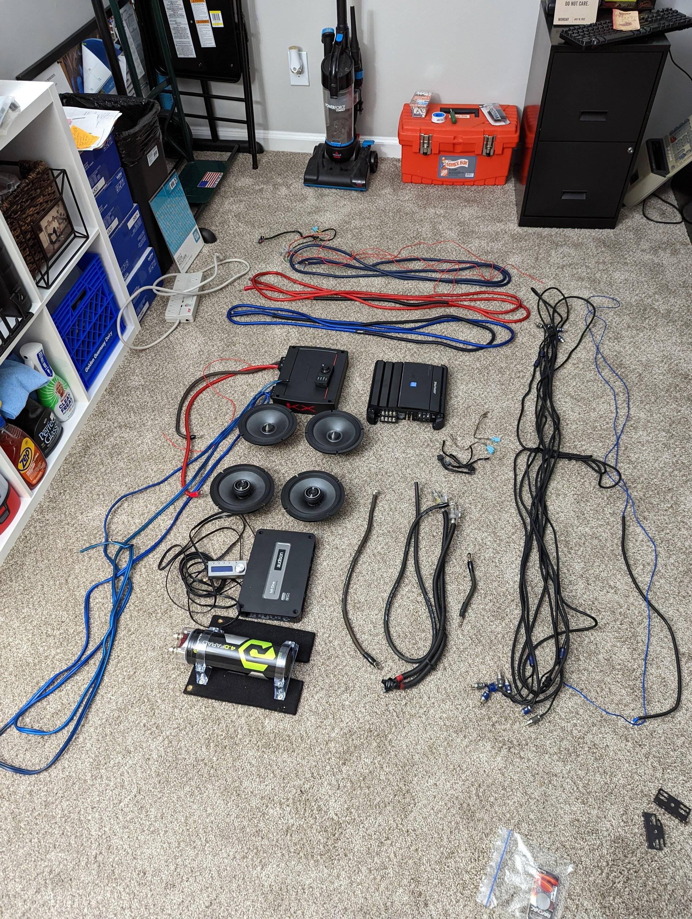

Looked back at some pictures I took of my mom's last setup and she's got the following sitting in storage I can grab:
- 2x Alpine R-S65C
- 2x Alpine SPR-60c
- 1x Raptor 4.0 Farad Pro Series
- 1x Audison bit One
- 1x Alpine MRX-F35
- 1x Kicker KXA1200.1
Not sure how much (if any) of that would be compatible with my car or address what you mean in terms of the integration setup maybe (like the bit One?).
I've got this corner sub box and this Zenclosures flush box (based on my quick look, I don't think there's enough space in that to support the L7s I've already got though) in my bookmarks already too. But I'd also like to stay closer to $500 than over $1000 on upgrading audio.
Bassackwards
Mar 8, 2023
235
110
Nashville
2022 GT/CS convertible
I used a single 12" punch in a homemade enclosure and it is more than most people can handle.
Those Alpines will sound great but I didn't see the tweeters in your pic.
Would the ones in the shot fit in the door panel or back shelf without some extra modifications?
You’ll need an adapter as the mount is incorporated into the stock speaker. I suggest using adapters from Sounds Good Stereo here: https://soundsgoodstereo.com/produc...-2011-2023-ford-mazda-lincoln-jaguar-vehicles
I have them and they’re a perfect fit. They also come with foam rings to seal the speaker to the door panel.
The Metra adapters sold on Crutchfield are garbage and too tall.
The separates should fit the doors with adaptersI mounted my tweeters in the a pillars, ran a wire from the 6.5s to the crossovers mounted in the door panel below the window switches, a wire from the crossovers to the wiring that feeds the 3.5s( 3.5s disconnected but left in position to fill the holes) then backfeed from the 3.5 wiring to the tweeters. It works great and is minimally invasive.
