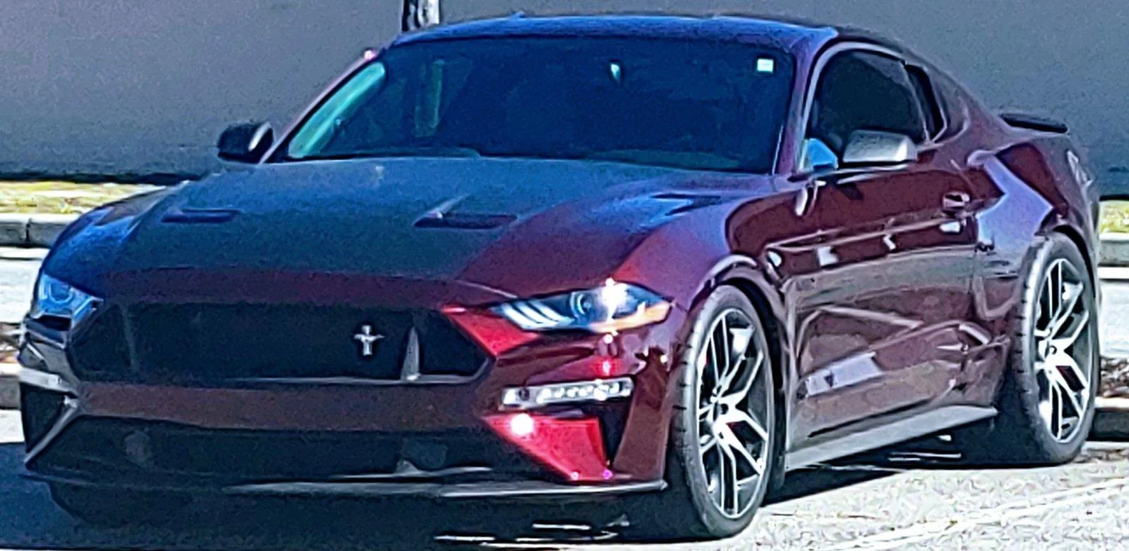

Check out this 2018 Mustang GT running a staggered setup, measuring 20x10 275/35/20 Front and 20x11 305/35/20 Rear.
Client loves the flush fitment and ride quality.
