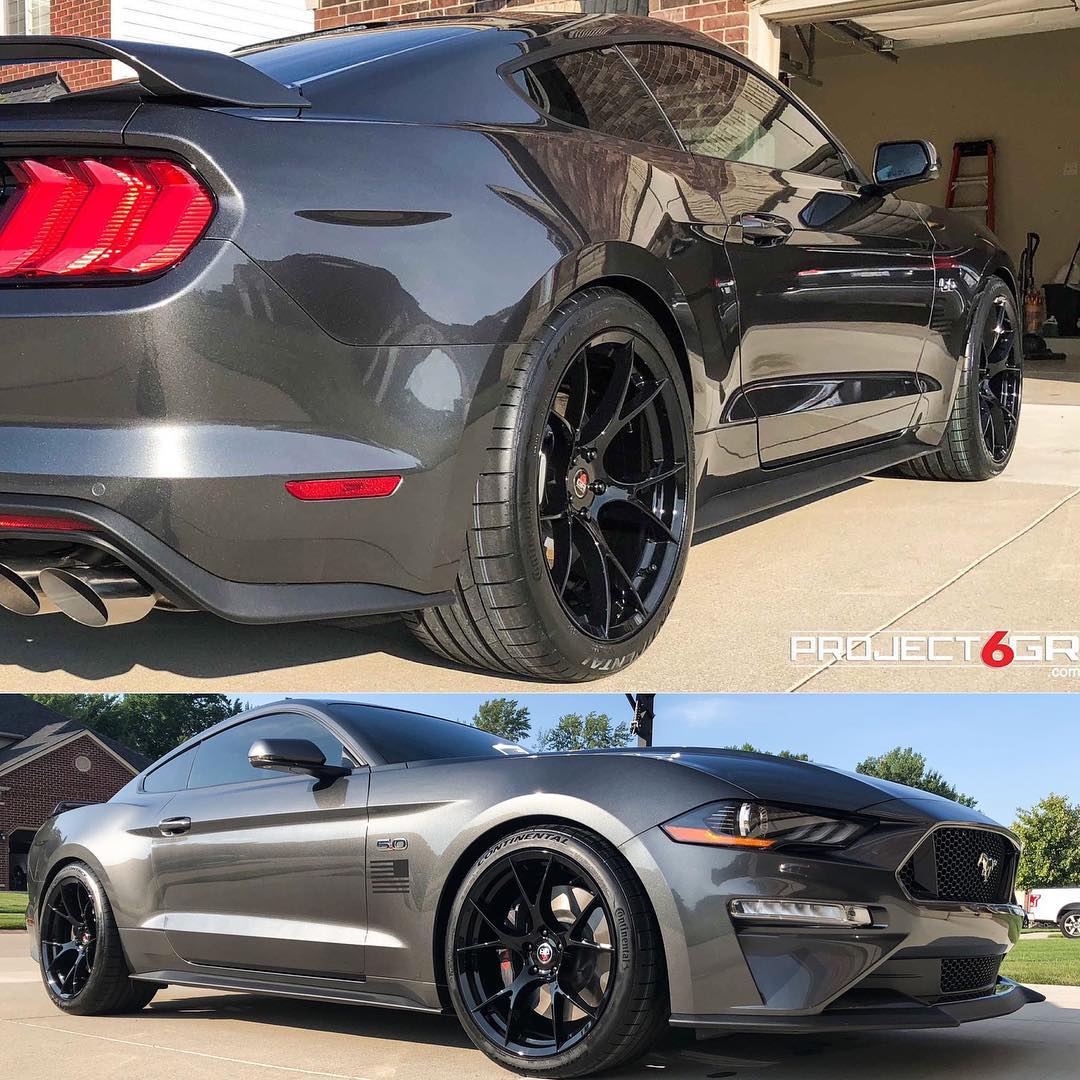

Check out this 2018 Mustang GT running a staggered setup, measuring 20x10 275/35/20 Front and 20x11 305/35/20 Rear.
Client loves the flush fitment and ride quality.

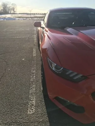

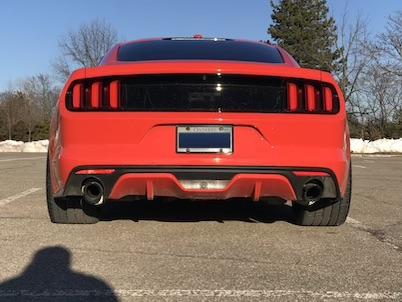

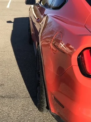

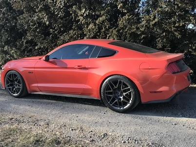

What are those offsets?
Yeah, I'm curious about that offset also... I love that I went with 20" wheels this time (for the looks), and IMO Tech7's are a great value, but don't love how the setup I chose have the fronts sitting in about 1/4" further than I'd like. Doesn't sound like much to some, but it makes a big difference to looks.
275/35 SuperSports on 20x9.5” in front
295/35 SuperSports on 20x10.5” in rear
I was a bit concerned that 20" would look "too much" for my liking, but after comparing weights to their 19" counterparts, and adding/removing both from my cart about 10x, I'm happy with them.
IMHO, if you're prioritizing looks at all, go 20". I had the car for a year with the GTPP wheels, 1" spacers all around, and lowered, which still looks pretty decent compared to stock. When I put these wheels on, I got about 10x more comments about the car in general...
*I should also mention, that at 275/295/35, I went with a little taller sidewall than some others choose to do, so the wheel wells would be filled more, and the profile wouldn't be too low, without adding too much to the circumference. These are very usable as a daily driver option.

Stock suspension in these pics? Looks real good
