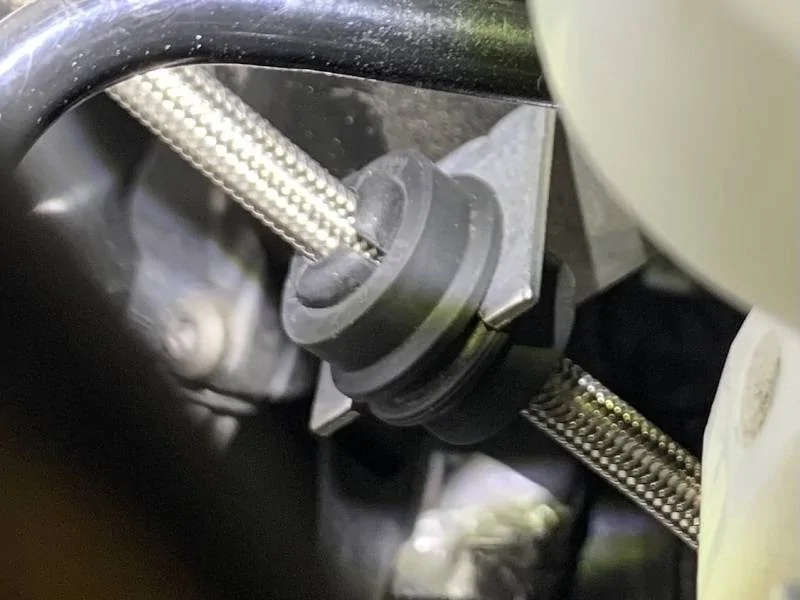

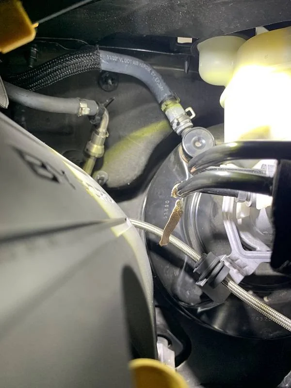

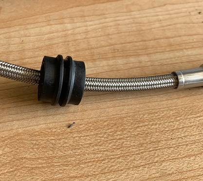

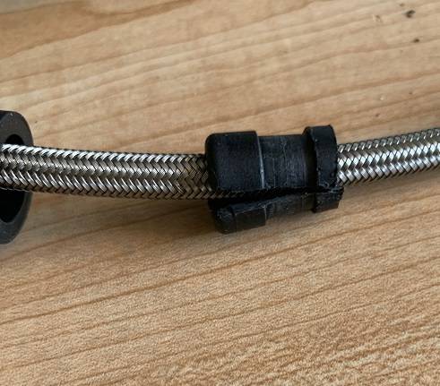

I decided to make a little tutorial for people who suffer from OCD like myself. Taking the factory line off, I noticed the mounting bracket on the master cylinder booster and wanted to use the same location.
Hope this is helpful .

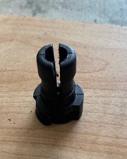

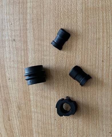

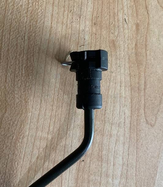

I drilled out the plastic to metal line connector that mounts to the booster by way of a rubber isolator.
Using a Dremel with a cutoff wheel I split the connector in half and separated the two pieces from the main connector
Now I am able to use the two pieces and rubber grommet to hold the braided clutch line at the original location.

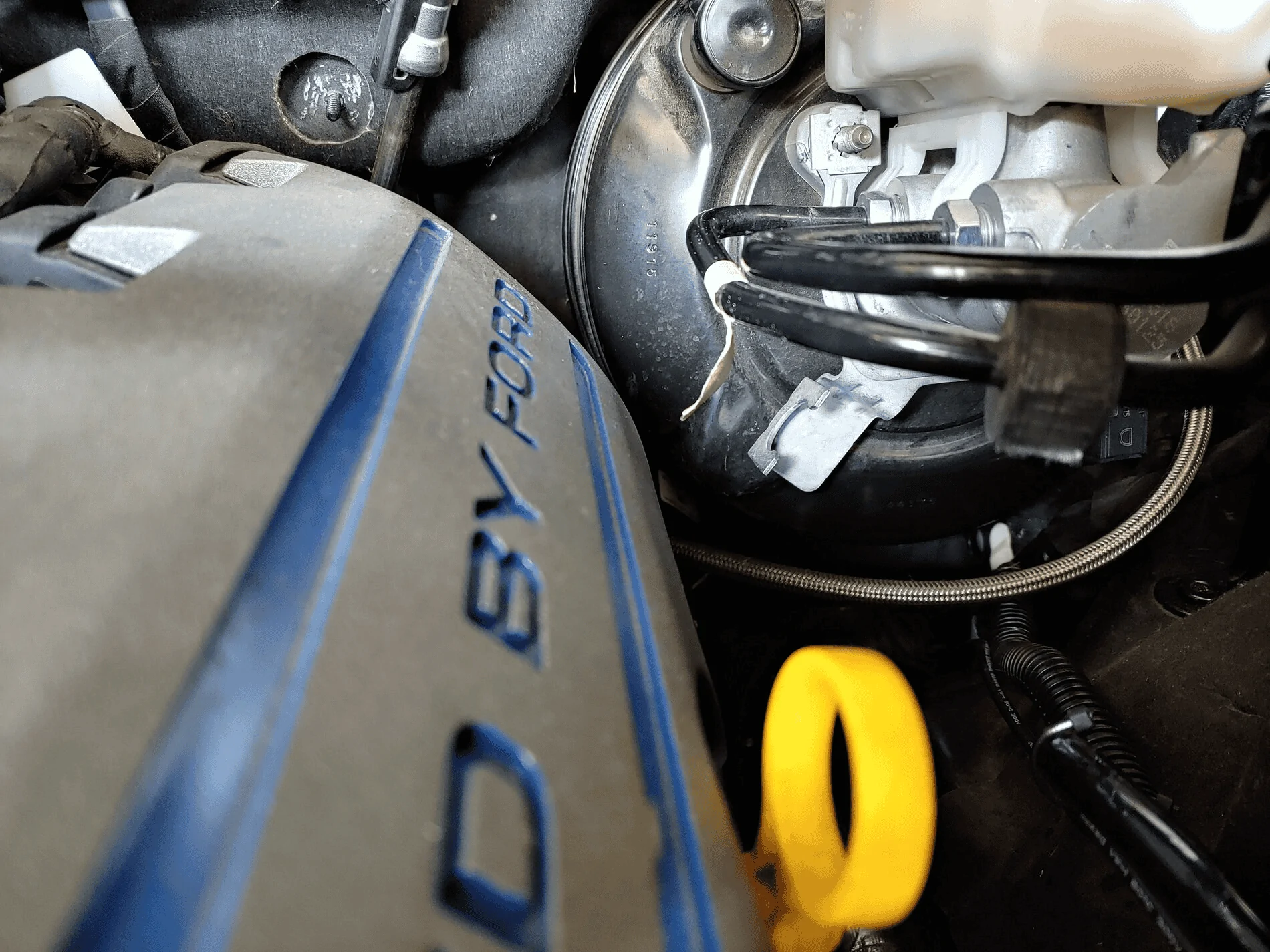

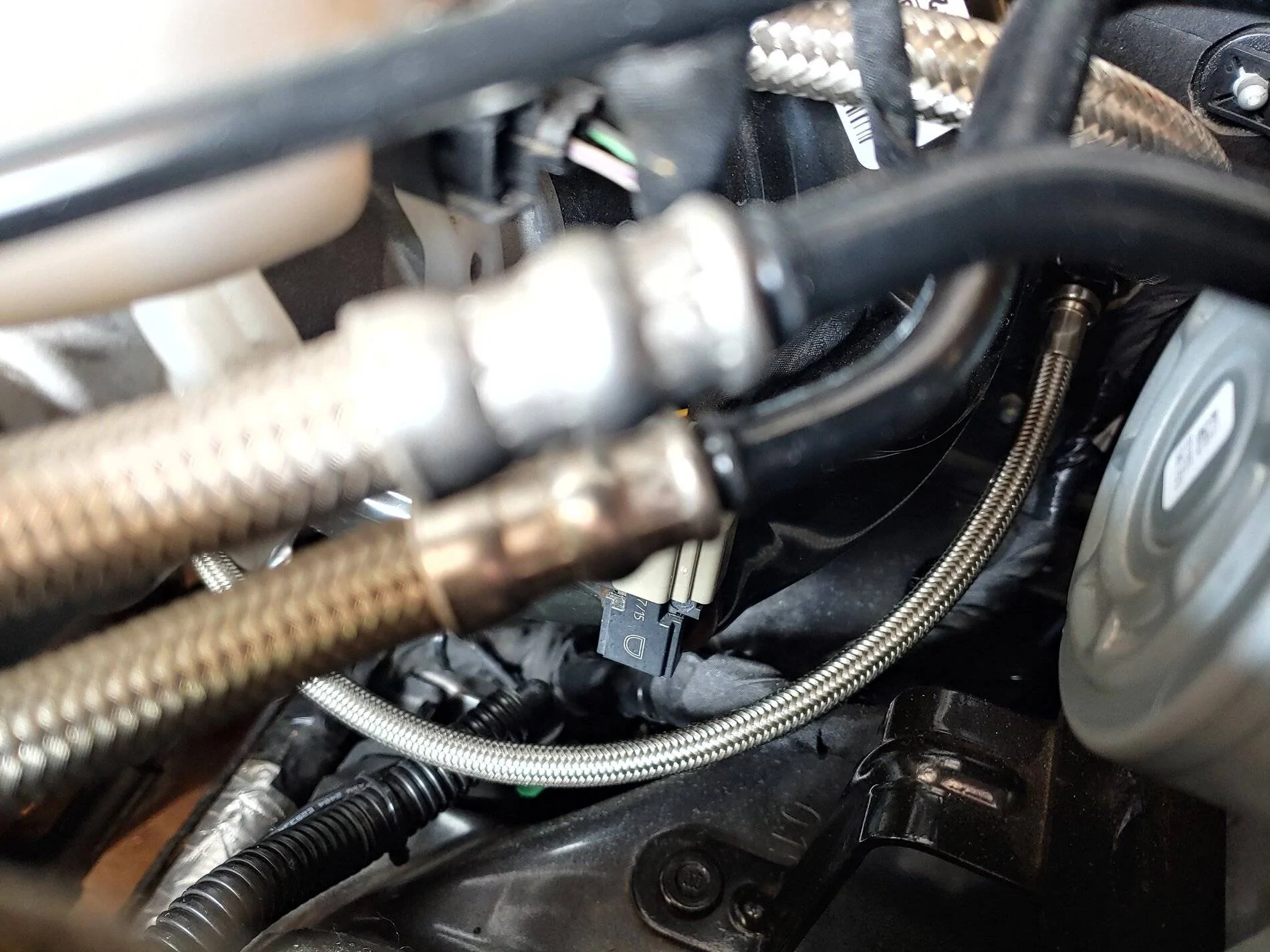

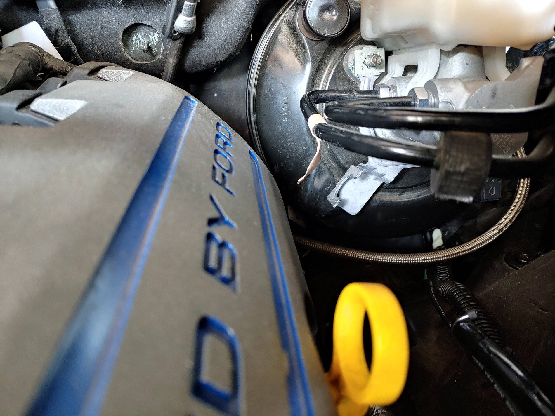

Condor1970,
In the picture below The braided line came really close to the header
It was my main reason for utilizing the OE bracket.
