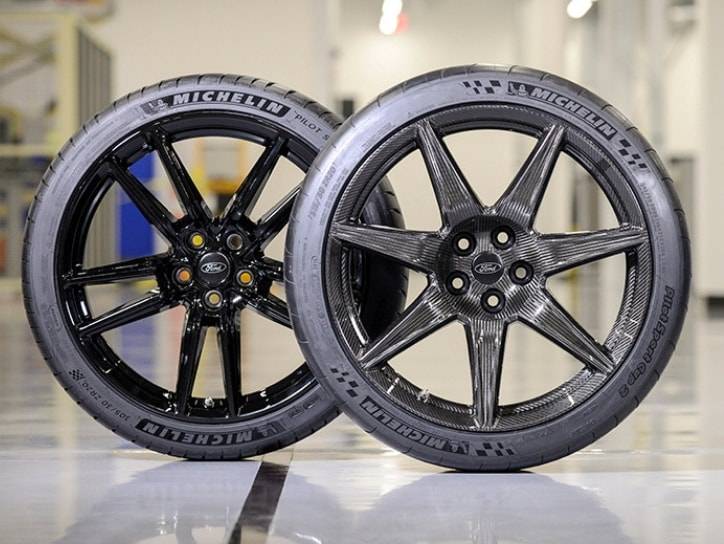

I'm getting 11.5" square setup as well from T. He said the base has 20x11" square and they have 305F/315R 4s as shown in these pics. I'm going to use the stock tires, for now. The 305s will be little stretched but isn't bad on 11.5" wheel. I will go bigger when they need to be replaced.
Almost positive this is a PS4S 315/30/20. It has the little checkered flag at the end of the tire size. I think the Cup 2 does not.
