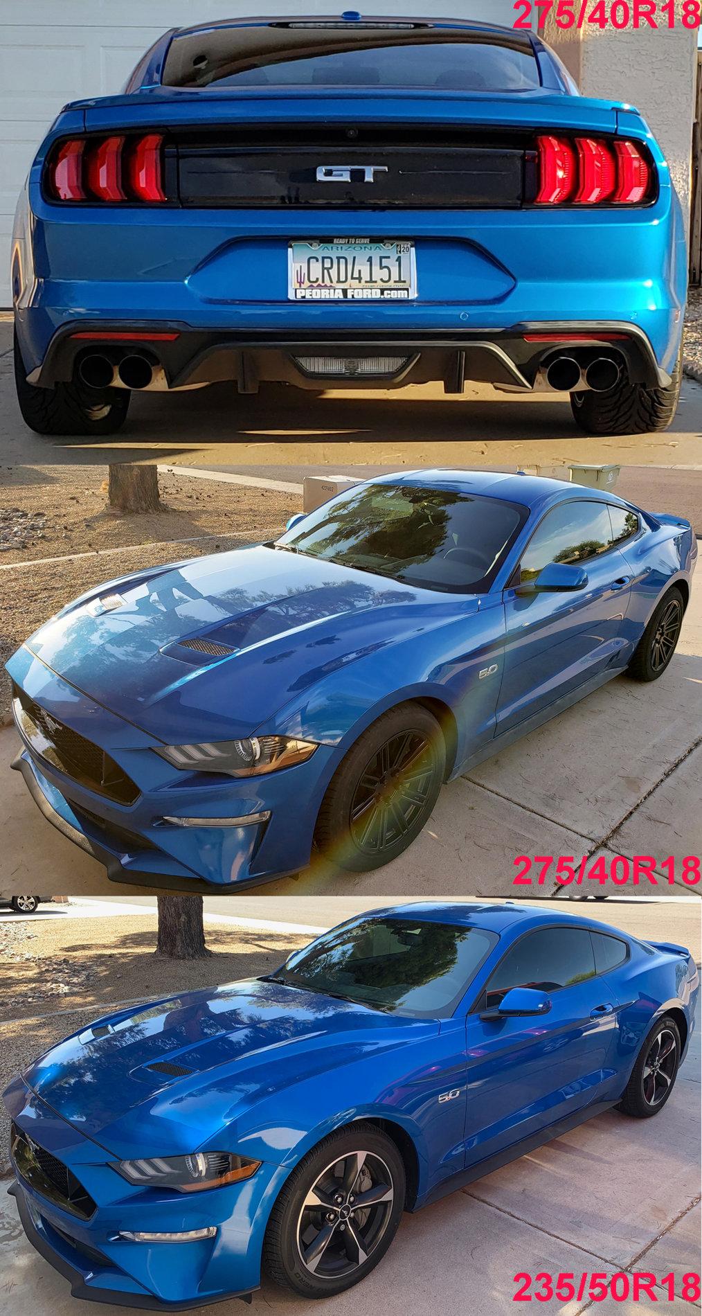

This overall diameter would be +1.5% with this size. A few people have suggested going 275 40/R18. There I would be -2.2% smaller and I would be losing some sidewall which I'm trying to keep. Also at stock height, I feel the wheel wells already look too empty, so I don't really want to go with a smaller overall diameter, and I don't mind riding a tiny amount higher with those 275 45/R18s. Also I know that the 45 aspect ratio tire is better suited to a 9" wheel than the 40 aspect ratio tire is. However, it seems the 40 aspect ratio tires are a lot less expensive, so is anyone running 275 40/R18 on a stock height S550 and if so how's that looking / working out?
